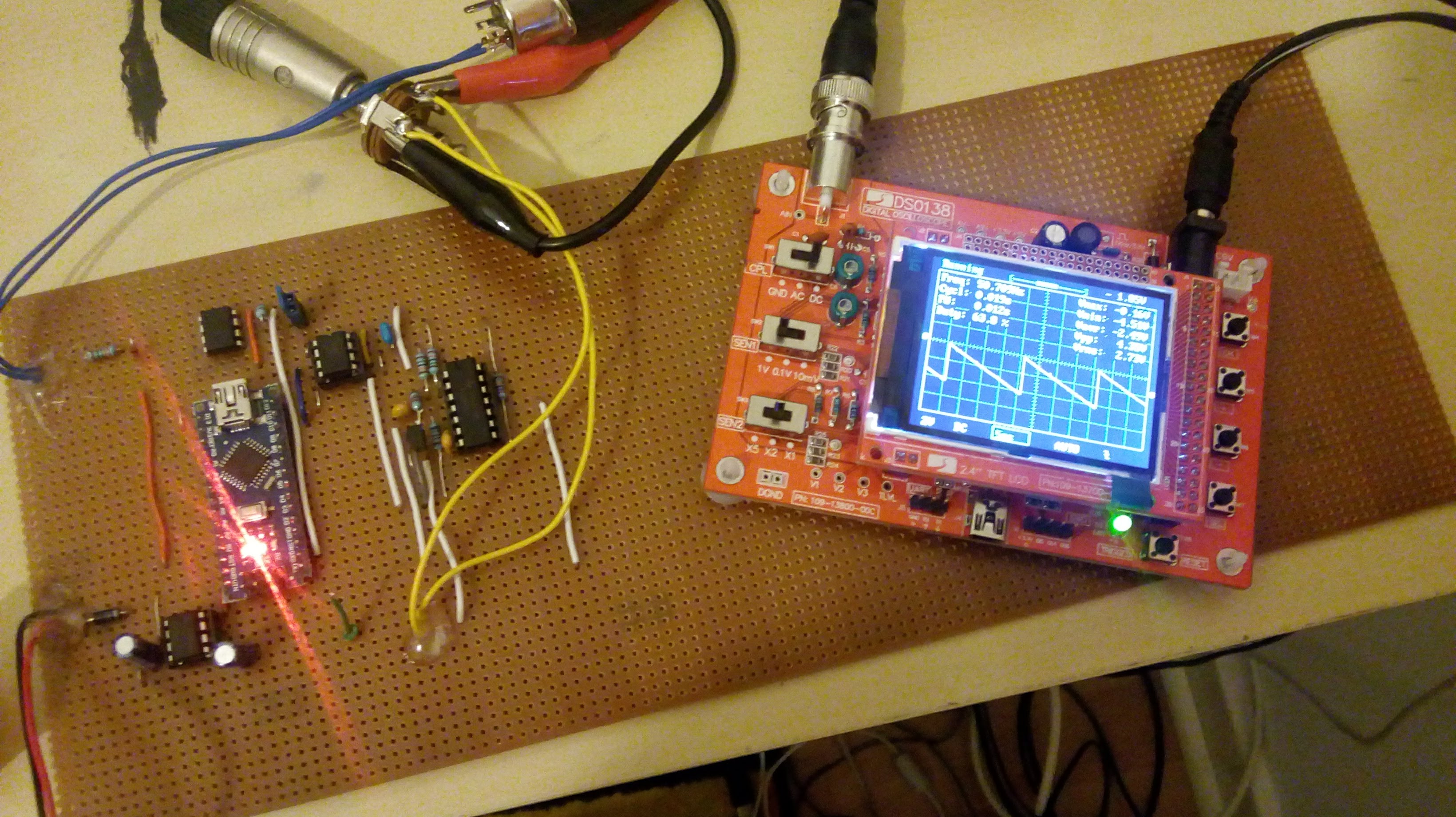

Here is my latest project. It's an oscillator controlled by an arduino.
This is a novel approach - it's a hybrid design, with a standard op-amp integrator to generate a sawtooth much like other analogue oscillator designs.
However, the reset of the integrator comes from the microcontroller, this avoids needing any tempco, matched pairs, calibration etc.
I use the 16 bit timer to generate a square wave of the correct frequency. The rising edge of this will reset the integrator.
So as well as a sawtooth, there is a square wave available as well, I'm not using this yet. If I were to use this, I would suggest buffering with an opamp before taking it off-board.
The integrator drive comes from an SPI DAC. The exponential conversion is done in software by lookup table. The integrator drive level does not need to be precise, any error here will result in a small change of amplitude of the sawtooth, rather than a frequency error, which would be the case with traditional oscillator circuits.
The sawtooth is about 4V pk-pk, and the design works over a 7 octave range.

I used an Arduino nano in my prototype, since that was what I had to hand, but it was originally going to be a pro mini 5V 16MHz.
Note that you need the arduino MIDI library installed. Also the timer is used directly, so it won't work on all Arduinos. It will work on any '328p based hardware.

my prototype

Cynosure wrote:
You should also adjust the voltage so that the higher frequencies do not have a lower amplitude.
That's actually what happens, there are 2 lookup tables, one for timer to get the frequency, one one for the SPI DAC that sets the integrator drive.
The DAC voltage is about 30mV at the bottom end (midi note 21) rising to 5V at the top (midi note 108).
There's a spreadsheet in the github repository showing how it's all worked out.

Grumble wrote:
In the low frequencies I don't see any problems, but how accurate is it in the higher audio range?
You're right, it does get less accurate for higher frequencies, but it's still OK.
the highest note is note 108, corresponding to 4186Hz, here the timer value is 239 decimal, so the precision of the timer is about 0.5% at this point.

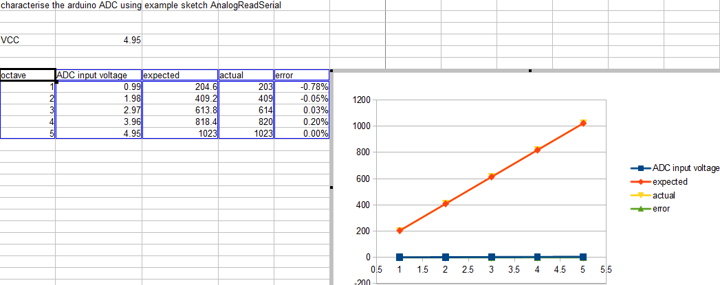

PostPosted: Sat Feb 17, 2018 10:22 am    Post subject: Reply with quote  Mark this post and the followings unread
Sebo wrote:
I did several modules in Arduino using it's ADCs as 1V/Oct input and I could get 5 octaves of decent tracking... Always using look up tables.
Actually, on second thoughts the arduino ADC is not bad, I did a quick characterization using the AnalogReadSerial sketch, and it is better than I had thought.
I think it should be good enough for a 1V/octave control, but you would need a pretty precise 5V supply (or VREF at least). I think I as getting poor results due to my 5V supply being slightly < 5V
