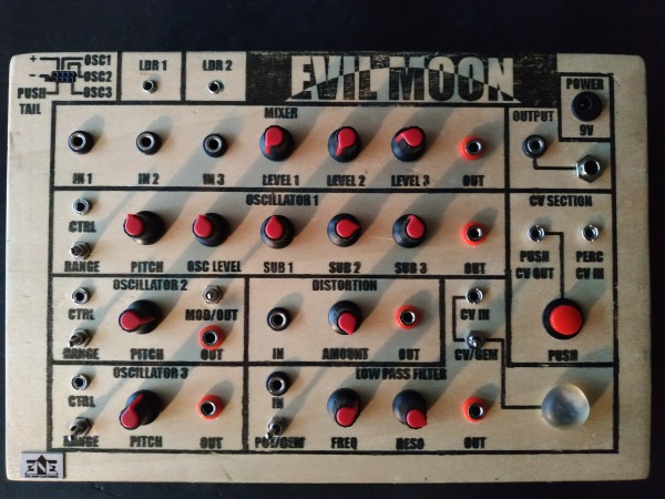

Hello again!! I just like to share a picture of the machine. I need to upgrade the vactrol and ldr "sensitivity" ( I don't know why but vactrol need 2.9v to start affecting the filter cutoff and external LDR's needs also a lot of light to "work" not as expected BTW) and the filter output is a lot louder than the mixer output (it's not a big issue anyway).
I added the Millers cap on the filter and the diode voltage protector on the mixer input with out any notable change on the sound, which is good cause it liked how this little noise box sounded.
I keep 5v for the oscillator (so I guess my future Lunetta "modules" have to be 5v power supplied) and keep the 9 volt for the audio processing "modules"(filters,distortion and mixer). The power supply was already finished so I guess I am to lazy to change it Laughing and makes senses to my to keep it this way.
Well!! I will update schematic with all the changes added just in case anyone like to get inspired with it... and of course it will be great if any one can tell me WHY IS THE LDRs ON THE VACTROL AND THE EXTERNAL ONES NOT WORKING WITH LITTLE LIGHT??
thanks again for all your help.ninreally appreciate it!!!!
