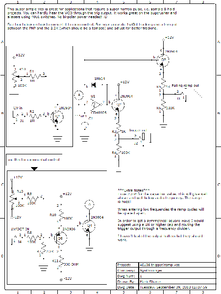

PostPosted: Mon Sep 08, 2008 11:49 pm    Post subject: super simple 40106 VCO with expo or linear control
Subject description: Only uses one gate and it runs on DC or bipolar power
Be sure to read the notes! ;D

Err there's an error in the schematic. The linear cv should be +9 volt not +12. It'll work on 12 but you'll have to change some values I'm sure.

i bread boarded this up the other day on 5v. and got nothing i think im going to try and knock down the 1m's to 100k and see what happens? excited to get a tri out of a 40106 though!!

I was using 9V and 12V. Not sure if 5V will work.
The linear portion really isn't linear and only have a range of a couple volts. Make sure you're connections and transistors are facing the right way, I'm 100% certain this works.

got it going i had a 2n reversed. very cool thanks!!

Remove C1 and add trim pot on the negative end of the manual voltage control to get a high frequency vco.

Ok so I looking at this cuircuit again the other day. On a 5v supply I changed r1 to 10m, and c1 needs to be atleast .22uf. Now I was using a .22uf Mylar cause it was the biggest I had on hand. This gave me a frequency of about 1.6k hz. I wanted more freq I tried a 1uf electro and the top end of the ramp rounds out? Is this because the electro cap? I'm going to be making a local run to a shop that has polystyrene caps in higher numbers. Maybe this is what I need...

sorry for such an amatuer question here but is the Circled A the audio out?

no, i think it's just the point where either the linear or expo CV input are connected to the circuit

Yeah that's right it's just the point where you connect either of the converters. The audio out is the "Falling ramp out".
You could technically use point A as an audio out providing that what ever you connected it to had a high input impedance, otherwise it would load the input of the inverter and stop it oscillating. That's basically what Q3 is already doing in the circuit.

By the way, use an op-amp buffer on the 'sawtooth' output. 4069 inverter gates would probably do the trick too. This gives it better if not perfect symmetry.

Oh and if ya plan to build multiple VCOs out of one chip I'd limit it to a max of 4 so they won't bleedthrough/modulate each other. Keep the middle inverters grounded.
I like to stick with two VCOs in a single chip. I use three inverters wired in series with the first two for the sync input and the last one as the vco core.
Oh and I found a neat way of getting 1-100% PWM using 3 gates. It sounds pretty different than you're typical op-amp pwm configuration.
