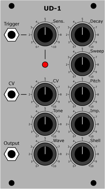

Here's a hastily knocked together Eurorack front panel design for the UD-1 based on the circuit on Scott's site. I've deliberately left the volume pot off but could be persuaded to do another design with it included if there is interest.
Adam-V
Hasty Eurorack Front Panel

PostPosted: Fri May 25, 2007 1:32 pm    Post subject: Reply with quote  Mark this post and the followings unread
Adam-V wrote:
Here's a hastily knocked together Eurorack front panel design for the UD-1 based on the circuit on Scott's site. I've deliberately left the volume pot off but could be persuaded to another design with it included if there is interest.
Adam-V
would be easy enuf to squeeze the volume pot back in: move th trigger led over and up towards the jack, slide up the CV/Tone/Wave pots (and the CV jack), and volume goes where wave was, right next to output where it shd be...
Just make sure you take a peek at my last post. You might want to add the foot controller input also. It will be a stereo jack.

PostPosted: Sun May 27, 2007 5:16 pm    Post subject: Reply with quote  Mark this post and the followings unread
I reckon I could squeeze the foot controller jack in to my layout between the CV and the Output Jacks. Does it have a attenuating pot to go with it?

goodrevdoc wrote:
Also nice layout Adam-V, I had something similar in mind for frac.
-justin
Thanks Justin. Once the design is finalised I'll post the Illustrator file for people here to use (assuming there is interest in me doing so that is).
