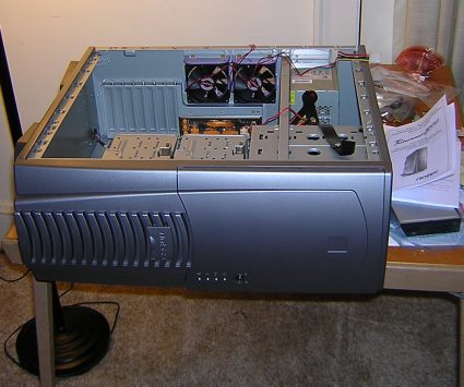

The greatest obstacle to a successful completion of your own DAW is not doing your homework--i.e. not reading your manuals and related sources. Probably the second greatest obstacle is ESD, electro static discharge. You must have an understanding of the hazard this poses to integrated circuits before you actually begin. "PC Hardware in a Nutshell" has a section devoted to ESD that is not as intimidating as the website linked to above. But it is not as thorough, and unlike the authors of that book I strongly advise using a wrist ground strap. These are available at any Radio Shack for less than $5.
So. Here we are. You've got the manuals for the case and the motherboard at hand. You've opened the case removing the door, and have removed the side panel opposite the door. This was easy because when you ran into a bit of trouble you stopped and examined contemplatively the construction of the reticent item and the true path revealed itself to you.
Now place the case on a table that you can access from at least three sides as in the image above. "PC Hardware in a Nutshell" recommends the kitchen table. I think this is a bad idea because--trust me--you don't want to feel any pressure to get this done by the next meal. Now breathe deep and get into a Tao/Zen state of mind.
First check to see if the IO panel on the case matches that of the motherboard. With the particular case and MB we are using, it will not. Remove the old IO panel from the inside of the case by inserting the blade of a very thin bladed screwdriver between the case chassis and the inner lip of the IO panel and twisting the blade to pry the panel inward. Begin this process at a top corner and proceed along the top till the panel is sufficiently loosened to be pushed in and fall free. Consider accomplishing this with grace and without cursing a test of your karma. In the box that contains the MB locate the new IO panel and pressing carefully but forcefully around its edges only, lock it into place. The next picture shows the new panel installed and the old one lying beside it. It also shows that I failed to pry up the optional Ethernet connection on the IO panel.

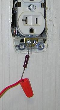

Strip one end of your length of wire. Bend the last half-inch of one of the leads on the 1 meg ohm resistor back on itself and twist the stripped portion of the wire around this. Now screw on the wire nut. WARNING the next procedure provides a risk of electric shock if not done exactly as stated and shown or if your house wiring is defective.
Locate an electric outlet near the worktable and plug in and turn on a lamp. Throw off the circuit breaker associated with that outlet. You will know that you have the correct one because the lamp will go out. Remove the outlet cover, loosen the bottom outlet mounting screw and wrap once around it the free lead of the resistor. Tighten the screw. The photo below shows this connection though your resistor will likely look somewhat different. Replace the outlet cover. You may now turn the circuit back on, though that is not necessary.

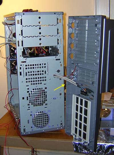

With the MB mounted in the case it's time to mount the drives. To do this we must remove the front cover of the case. The cover is attached by six pronged tabs. From the inside of the case locate the portion of each tab that protrudes into the case and press it inward while pulling outward on the cover. There is only one problem. The middle tab on the side of the case opposite the cover door hinge is obscured by both the upper removable drive carrier as well as the cables that are wired to the cover. So remove the carrier before you remove the cover and examine the area where the cables enter the case from the cover to locate that tab.
