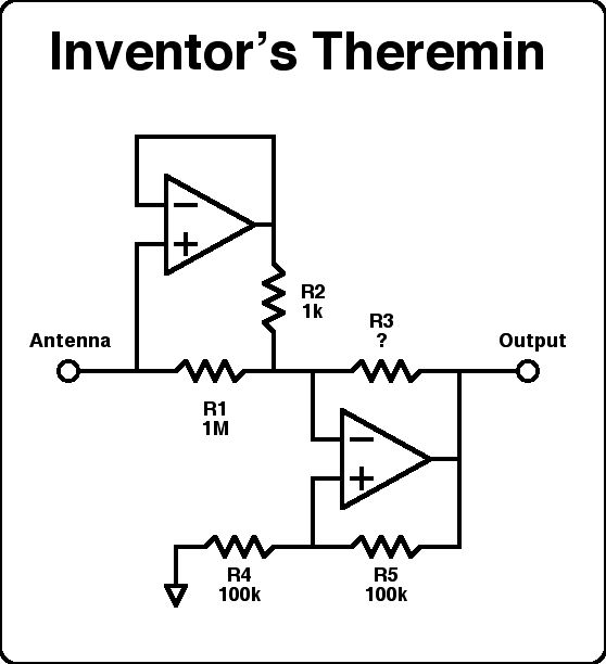

Attached you'll find a schematic of the Theremin that I recall from my NCSU lab days that I put together back then. It consists of a capacitance multiplier and a relaxation oscillator.
The capacitance multiplier multiplies the body capacitance that is being sensed and the relaxation oscillator varies it's frequency of oscillation according to this capacitance.
It is a nifty little Theremin in that it can be constructed with a dual opamp and five resistors, but will it really work? I think so. I guess now that I've posted it I better build it, eh?

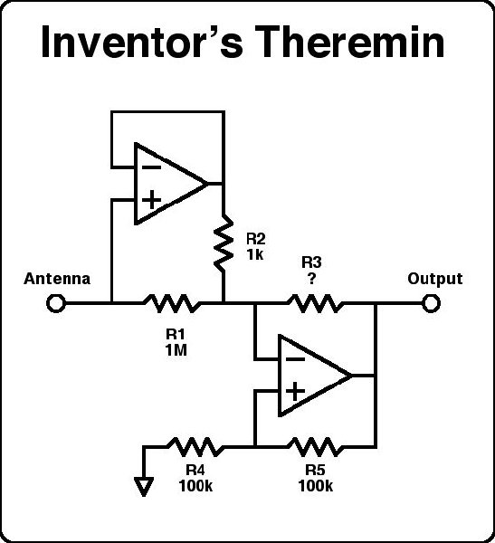

OK, I tested the circuit and had a lot of trouble with the capacitance multiplier. I believe this is because I am using a single-ended supply. So I simplified things by just using the relaxation oscillator itself. See the diagram below. It works at something lke 40 kHz which is too fast to be read by my interface, so I'll have to slow it down somehow. Anyway, it's a start and it seems to vary frequency sufficiently when a small spool of wire is used as an antenna.

I have now prototyped and tested both versions and some variants as well. I was only able to get a capacitance multiplication of about five times out of the capacitance multiplier in practice. The circuit's slowest operation with the multiplier is about 5 kHz nominal and without it is about 25 kHz nominal. Either version works fine.
The 5 kHz version would suffice as a super-minimal Theremin because you could listen to the signal as-is. For use in my project, however, I need an output signal that is either a lot slower or is an analog level, one or the other. To slow it down I could use a CMOS counter chip, and to create an analog value I could create a frequency to voltage converter (but that would involve a lot of design and test). Right now I'm thinking the divider application would work best, though it does require a chip that I don't have on hand...
