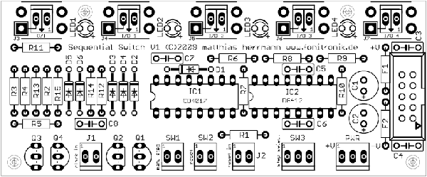

PostPosted: Fri Apr 17, 2009 4:17 am    Post subject: Reply with quote  Mark this post and the followings unread
BTW thank you all for interest. the PCB will get manufactured.
i decided to provide additional footprints for cliff 1384 sockets (.8in spacing, like doepfer).
for the power i did not implement a MOTM .156 header, but a conventional MTA100 3-pin connector and a ribbon connector (eurorack).
this way the PCB is still generic, but with a thing for euro Wink
hope you are all fine with that.

PostPosted: Fri Apr 17, 2009 8:38 am    Post subject: Reply with quote  Mark this post and the followings unread
Yay!
Blech! Wink
The Modcan solution of 3 pin header to 4 pin header cable would work in this case, correct?

PostPosted: Sat Apr 18, 2009 4:26 am    Post subject: Reply with quote  Mark this post and the followings unread
Would have prefered the standard MOTM header. If u don't have the space can u make the mat 100 a 4 pin one (2 grounds in the middle). That way it would be easier to make 156 to 100 cables.
A .156 header would be best tho Mr. Green
Anyway, thanks for that project matthias Very Happy

PostPosted: Sat Apr 18, 2009 5:02 am    Post subject: Reply with quote  Mark this post and the followings unread
I would like the 156 header but if its got to be 100 make it a 4 pin Rolling Eyes
Paul Darlow
www.krisp1.com
PostPosted: Sat Apr 18, 2009 6:51 am    Post subject: Reply with quote  Mark this post and the followings unread
good point. i will do that.
i am not offended, i just want to explain: we have MOTM, DOTCOM and EURO. if i implemented all three headers i would need half of the board to do just this (almost Wink ). there are so many flavours, even about front panel components. so i made a decision this time. i think that is still fine - there are a lot of DIY-boards out there without any standard headers... so "something is better that nothing"?!
