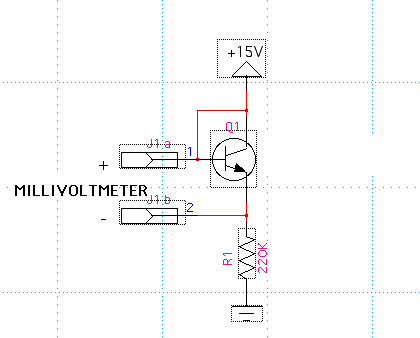

Here is a simple though efficient circuit to match transistors.
It is important that you do not handle the transistor with your fingers (because of temperature), work in a constant temperature place and wait for one or two minutes after powering the circuit before measuring the Vbe in order that the transistor temperature being stable.

Yes the circuit above is valid for PNP provided that you reverse the power supply polarity.
That is replace the NPN by a PNP with same connection Emitter for emitter , base for base, and collector for collector, and the +15V becomes ground and the ground becomes +15V.
The Moog's circuit provides a linear current source while here the current is defined by the collector resistor. When you need to match the Vbe of two trannies the same day, the simple circuit above is efficient enough.

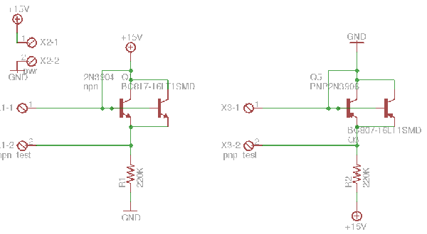

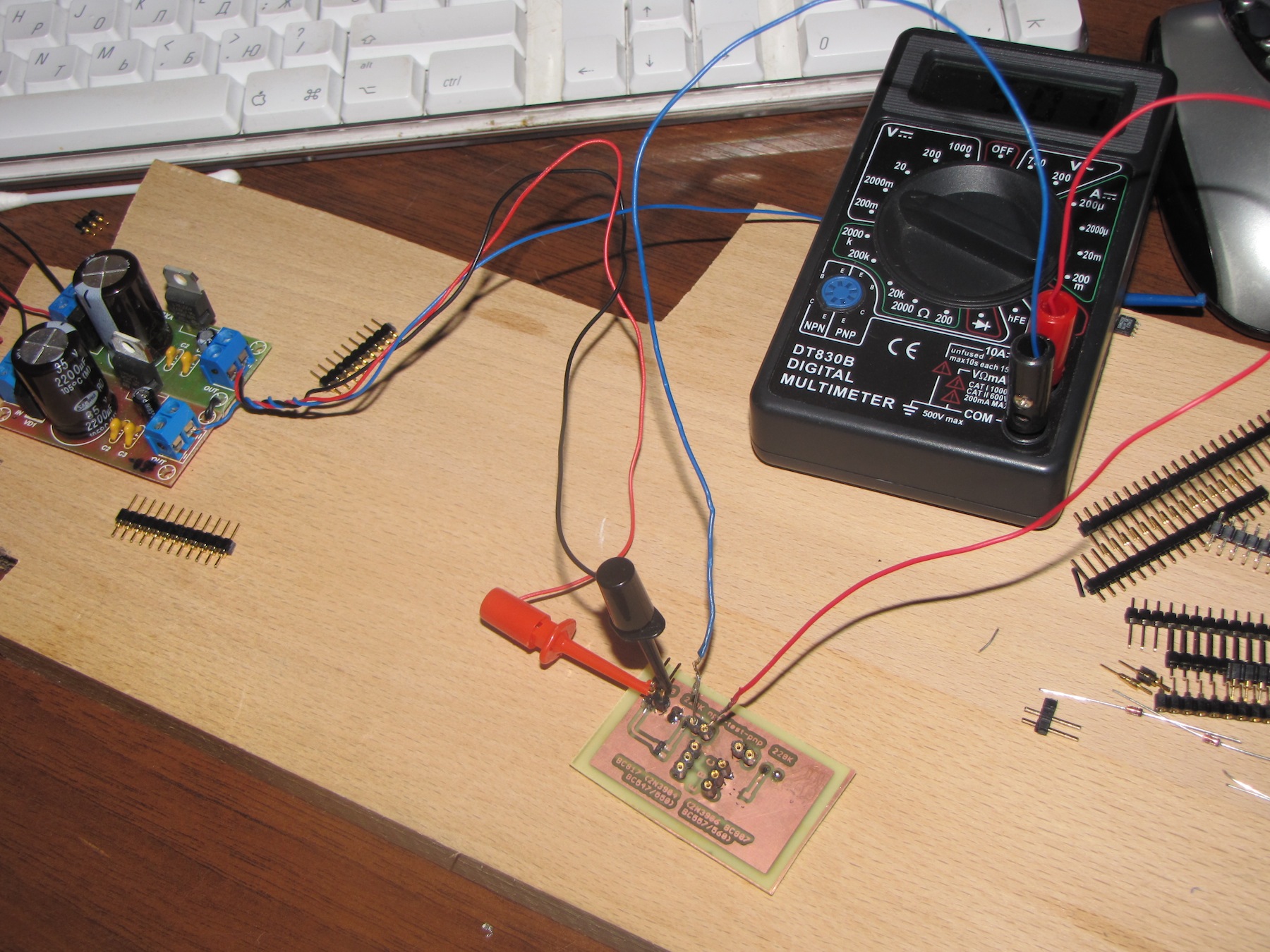

PostPosted: Sat Nov 20, 2010 1:24 pm    Post subject: Reply with quote  Mark this post and the followings unread
just to update the topic: I've made a universal transistor matcher - both for smd and thru holes ones both pnp and npn by the Yusynth's scheme.
smd transistors should be put and pressed to the board with some heat non-conducting material. thru holes resistors could be put directrly into collet-connectors. the direction of putting these transistors is stated as ")" or "D" with the rounded side
transistor matcher in action (smd npn-transistor testing)
 Filesize:  648.53 KB
 Viewed:  800 Time(s)
transistor matcher schematic by Yusynth
 Filesize:  23.47 KB
 Viewed:  863 Time(s)
print_pnp_matcher.pdf
template for negative photo-resist (two layers), should be printed as-is without scaling
 Filename:  print_pnp_matcher.pdf
 Filesize:  90.04 KB
 Downloaded:  679 Time(s)
