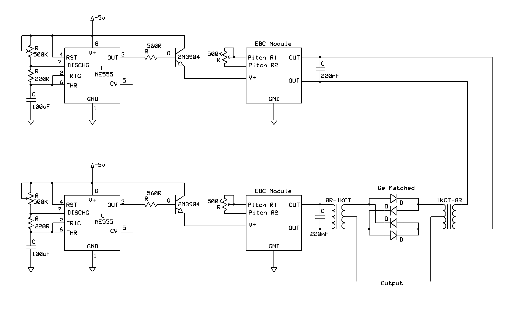

Here's the basic schem at this stage.
Let me know if anything looks amiss.
How do we short that cap Les?

Hi Andy,
The datasheet that I looked up here (I'm at my bro's house and have no access to my hoard of goodies on my Mac mini) says that the output can drive 200mA without buffering. So you probably don't need that 2N3904 buffer transistor or it's base resistor. So that might clean things up a bit if I'm not mistaken.
Next up, the schematic shows that reset is tied high to Vcc. That's OK for normal use but you wanted a reset, so I'd hook that input up to a pull-down SPST switch with perhaps a resistor in series. Pull it up with a weaker resistor and you'll be golden.
Please correct me if I'm wrong or ask questions if I have not been clear enough.
Les

PostPosted: Mon Mar 08, 2010 1:39 am    Post subject: Reply with quote  Mark this post and the followings unread
Les, the problem is that I want it to run as an astable unless it recieves a trigger which I'd like to force a reset of the timing by discharging the cap.

PostPosted: Mon Mar 08, 2010 1:54 am    Post subject: Reply with quote  Mark this post and the followings unread
Andy, when -reset gets a negative pulse, it drives a high value into the gate of the discharge transistor which will accomplish your goal. So you want a signal that is normally high and goes low briefly to discharge the cap, and apply that to reset. If your pulse is normally low with a positive level for the discharge trigger, then just use a common emitter NPN stage to invert the pulse.

PostPosted: Mon Mar 08, 2010 3:54 am    Post subject: Reply with quote  Mark this post and the followings unread
Sorry Les, I think I'd need to see a schem to get what you mean. Do I have the reset only connected to the trigger input?
BTW, I agree that I probably don't need the NPN buffer. I just had it there while I was testing the running of two boards off the same 555. They draw about 100mA each. (Although I don't know how they got 100mA out of 3 button cells!?! Laughing )

PostPosted: Mon Mar 08, 2010 5:48 am    Post subject: Reply with quote  Mark this post and the followings unread
Yes Andy, just connect the reset inputs to the trigger signal. This should accomplish your goal if the trigger signal is normally high and goes low for the trigger. If it's the other way around, just invert the trigger with a hex inverter or a transistor switch. Hope that helps.

PostPosted: Tue Mar 09, 2010 3:56 am    Post subject: Reply with quote  Mark this post and the followings unread
I've decided I'll use a switched trigger socket for each which will leave them in astable unless the trigger is plugged in. More intuitive and saves on panel components.
