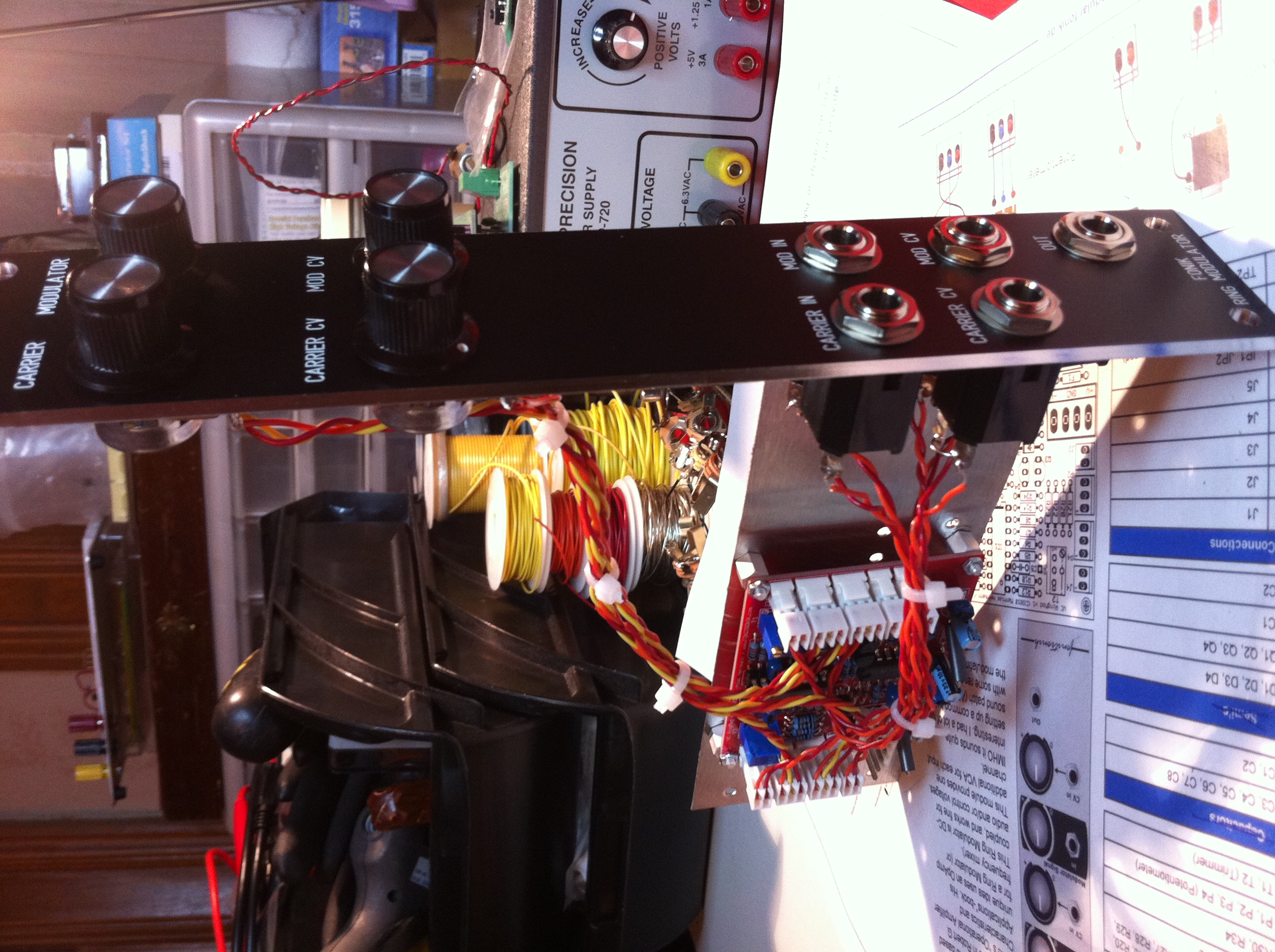

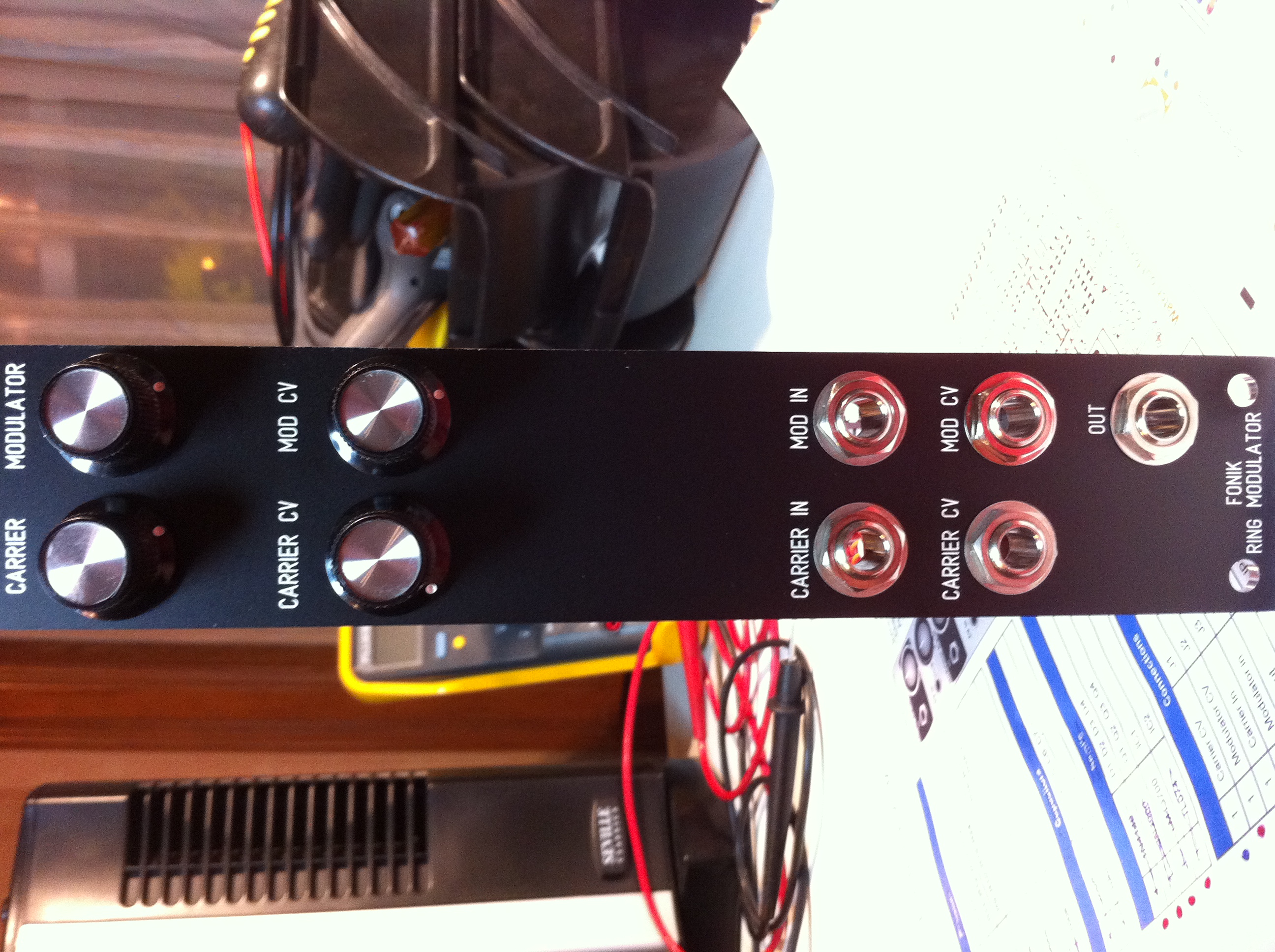

PostPosted: Fri Nov 19, 2010 6:41 pm    Post subject: Reply with quote  Mark this post and the followings unread
A couple photos. Thanks so much for sharing this module!
Edit - not sure why they're being rotated when I attach them.

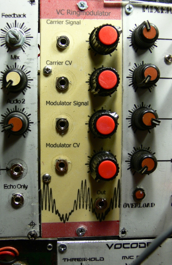

PostPosted: Sat Nov 20, 2010 1:19 am    Post subject: Reply with quote  Mark this post and the followings unread
I wish I ordered two of these. It sounds great!
vc ring mod in my crappy looking but functional modular
 Filesize:  258.31 KB
 Viewed:  719 Time(s)
My DIY stuff Flickr
