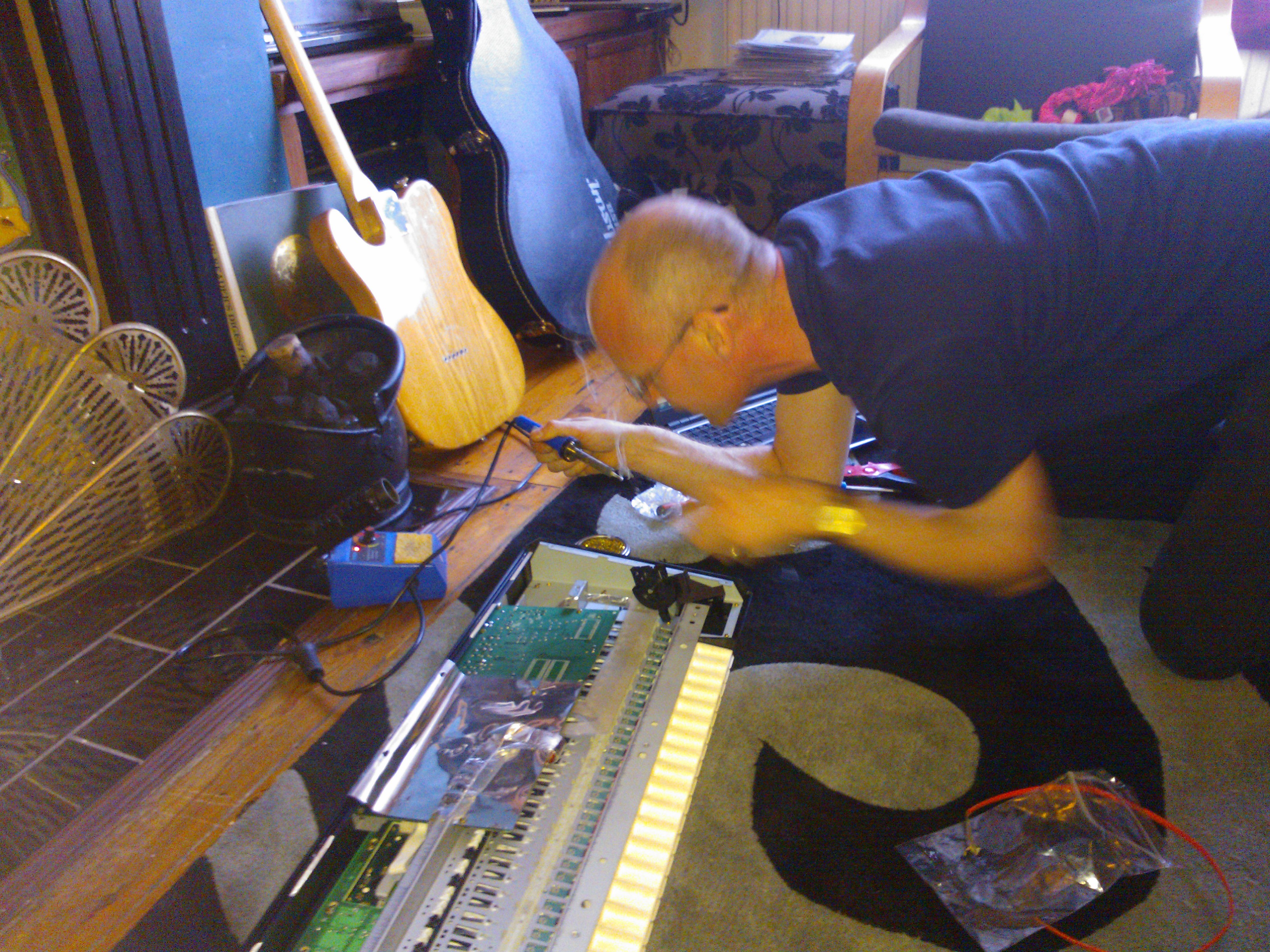

I had exactly this problem on my D5 and I just tracked it down to a bad capacitor on Vref. I was getting a roughly 1 MHz, 1V sinusoidal ripple on Vref. When I added another 10 uF cap (in parallel with the 10 uF C49), the Vref ripple went away and the spurious bender hash went away as well! The bender and modulator functions are now working perfectly, as verified by the test mode described in an earlier post.
Note that I did not remove and test C49; I'm assuming it had failed open.
It just occurred to me that one could apply this fix without removing the circuit board. Just try connecting a 10 uF cap between Vref (yellow) and AGND (brown) on the bender pot.

PostPosted: Sun Sep 21, 2014 3:43 pm    Post subject: Roland D5
Subject description: connecting a 10 uF cap between Vref (yellow) and AGND (brown) on the bender pot
I just got friend to do the above and can confirm it worked a treat.
Thanks very much for the advise.
Jim
