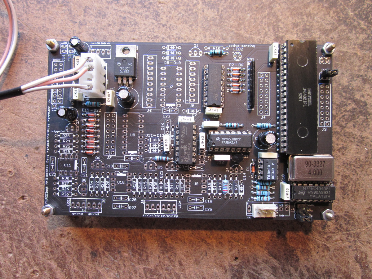

Dave Kendall
Joined: May 26, 2007
Posts: 421
PostPosted: Tue Aug 09, 2011 6:55 am    Post subject:
Subject description: 4mHz XTAL oscs
Hi all.
Testing today....
A quick note- Get 8-pin 4mHz Xtal oscs if you can, the 14-pin ones only just fit on the PCB. They will be fine, but are very close to the IC socket legs for U1 and U3. Sockets are essential for U3 and U2, and recommended for U1 and the others.
A quick peek... it shows the components necessary for testing the basic operation of the circuit. With these components fitted you will get a basic 24PPQN clock, and the other START STOP etc pulses at J5.
Build notes to follow.
 Filesize:  746.52 KB
 Viewed:  628 Time(s)
"Everything in moderation, including moderation"

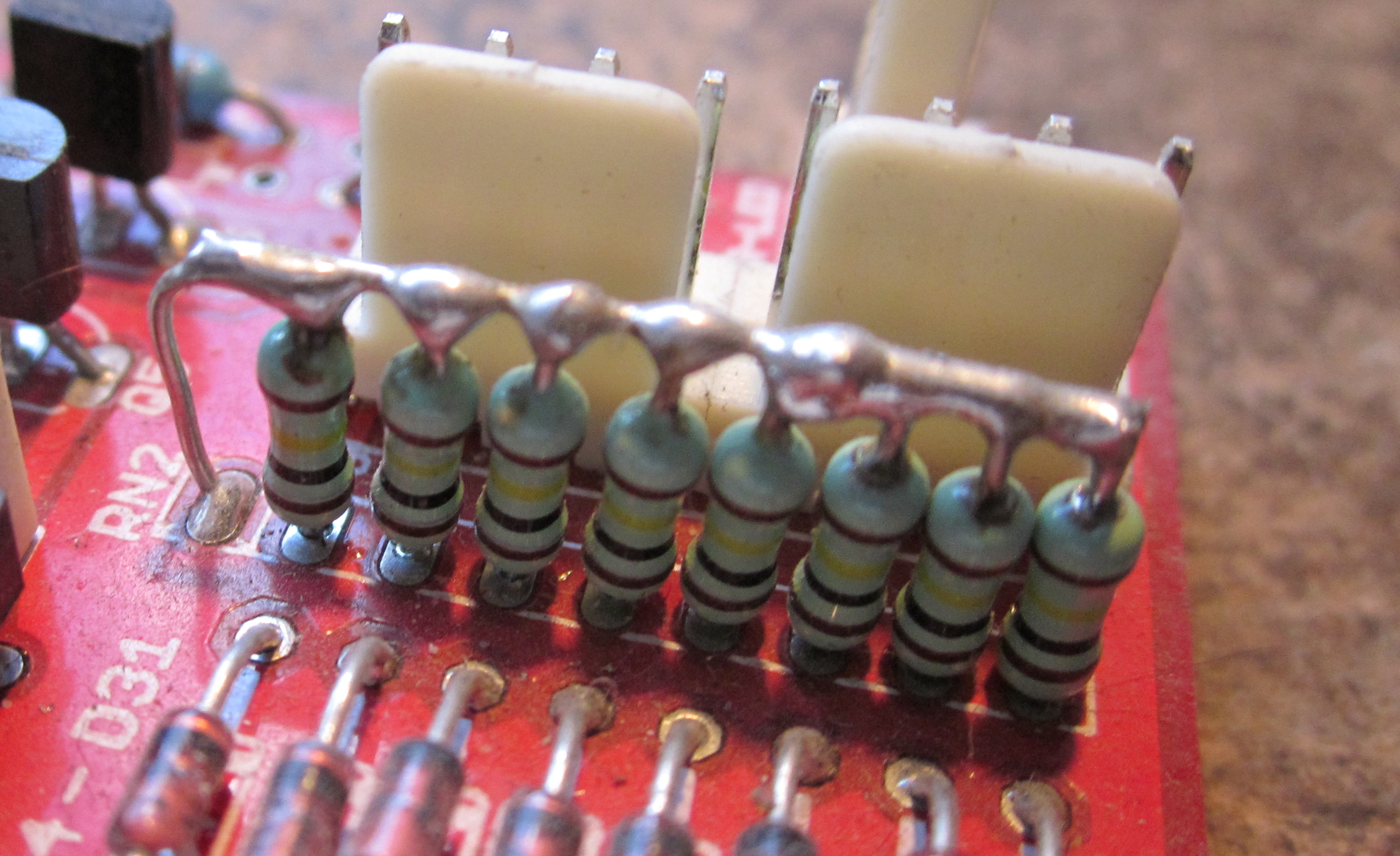

Dave Kendall
Posts: 421
PostPosted: Tue Aug 09, 2011 10:49 am    Post subject: Reply with quote  Mark this post and the followings unread
Hi Marv.
It's a 10K 9-pin Commoned resistor network. Pin 1 is the common, which is connected to GND in the M2C circuit. The other 8-pins are the other ends of the resistors. You can make your own RESNET, by inserting 8 x 10K resistors vertically, and joining their "top" leads together. These joined leads connect to pin 1 via the lead of the resistor at the top of pin 2.
The photo shows the bodge-up I made for the beta test of the fonik VCPS (which is the exact same spec as for the M2C.)
eurohm 009103 is one part number.
(edited for clarity)
 Filesize:  1.37 MB
 Viewed:  731 Time(s)

marvkaye
Joined: Mar 14, 2011
Posts: 225
Location: Fla
PostPosted: Tue Aug 09, 2011 11:11 am    Post subject: Reply with quote  Mark this post and the followings unread
Phew, that was quick... lemme catch my breath....
Thanks, Dave, it's all very clear now. I like your "bodged" up network, gets the job done is the main thing. Found them at Mouser right off. Thanks for your support, you get my vote. Very Happy Very Happy
<marv>
