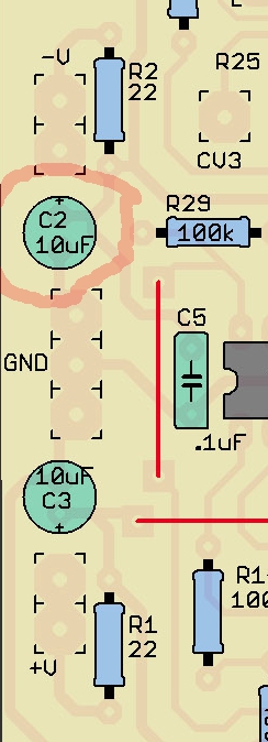

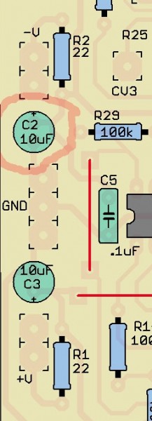

here's a shot from the manual (proto board), i guess the negative electrolytic cap (C2) should be reversed, no?

PostPosted: Wed Sep 21, 2011 5:23 am    Post subject: Reply with quote  Mark this post and the followings unread
You are correct! The board has a mistake on it. Sorry about that!
NOTE: MAKE SURE TO INSTALL C2 OPPOSITELY BIASED TO WHAT THE BOARD LAYOUT/SILK-SCREEN SAYS!
(Edited out the error for clarity to avoid any confusion)

marvkaye
Joined: Mar 14, 2011
Posts: 225
Location: Fla
PostPosted: Wed Sep 21, 2011 5:45 am    Post subject: Reply with quote  Mark this post and the followings unread
HexInverter wrote:
The negative supply filter capacitor's positive lead should be at -V, and its negative lead at GND.
Huh?? On the negative supply the ground is at a positive potential compared to the negative voltage, so the + lead of the capacitor should connect to ground, the minus lead to the - voltage, shouldn't it? Unless I've been missing something along the way (not impossible, I'll admit Rolling Eyes )
<marv>
rosch
Joined: Oct 03, 2009
Posts: 164
Location: germany
PostPosted: Wed Sep 21, 2011 5:48 am    Post subject: Reply with quote  Mark this post and the followings unread
i'm wondering if i'm missing something here.
i think normally it would be like -V _ C-C+ _ GND _ C-C+ _ V+
i haven't analyzed the whole circuit though, might be i miss something essential
HexInverter
Joined: Aug 21, 2010
Posts: 338
PostPosted: Wed Sep 21, 2011 6:11 am    Post subject: Reply with quote  Mark this post and the followings unread
YIKES! Sorry guys. Good call!!!
I will make a large warning in the assembly manual to install it in the correct position.
This is why engineers have an entire design team behind them...so when someone makes a silly mistake, the others catch it. Thanks guys Smile
Paradigm X
Joined: Feb 15, 2011
Posts: 363
Location: Null and void
PostPosted: Wed Sep 21, 2011 8:26 am    Post subject: Reply with quote  Mark this post and the followings unread
Thanks for the shems and the update.
Interesting how mattias got his working with it reversed (although if i understand it right its a non critical part of the power supply (?))
The schems are wrong too then if the above is correct. (I think) - only this capacitor tho.
Cheers, ben
HexInverter
Posts: 338
PostPosted: Wed Sep 21, 2011 8:38 am    Post subject: Reply with quote  Mark this post and the followings unread
Cheers, ben
Yes, the way the layout software works is that whatever is in the schematic winds up in the board. I will have to update the schematic eventually!
Well, its just a filter capacitor, but they can blow up when reverse biased sometimes D:
