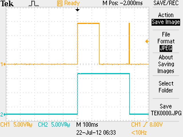

Ah small breakthrough perhaps Smile
was doing some more testing tonight after work and
still getting nowhere fast when out of frustration more than anything else
i tried manually stepping the sequencer, it was stepping through fine but
fortunately or i probably would never have seen it i still had the clock incoming from the M2C running very slowly and the damn thing kept resetting itself to the first step on every clock pulse Shocked
So i tried a another clock signal into the reset jack [an even slower clock]
with the M2C clock still running into the clock input
and eureka it worked. Smile
a bit of quick thinking and i next tried tying the reset input to ground
and again the sequencer is stepping fine. Smile
so that makes my next suspect actually part of the reset cct
specifically R52 - 100k which ties the reset to ground to stop the input floating when not in use though how this affects the clocking only when it is above a certain level is Confused I will run over it in my head to see if i can figure out a proveable theory

it actually is R43 that ties the counter ICs reset input to ground. the parts R52, C27, D16, R53, R39 form a simple clock to pulse converter.
so this behaviour is intended: the reset is just a reset and not an inhibit. it resets the sequencer to step 1. from the rising edge of any incoming reset signal (squared) a short pulse is created, so that the sequencer keeps running (now starting from step 1), no matter how long your reset signal is.
hope that helps.

PostPosted: Wed Oct 26, 2011 5:11 pm    Post subject: Reply with quote  Mark this post and the followings unread
Thanks Matthias your cct description does indeed help a great deal
I had only had a quick glance over that part of the cct previously
I suspect this input must be floating and getting an induced voltage
from the clock input which is only high enough to affect the reset
when the clock pulse exceeds 9 volts [the two inputs wiring runs next to each other and are loomed together] thus R52 is still the most likely candidate.
This problem never arose before simply because previously the sequencer was never clocked with an high enough signal to produce this affect
so a mix of two problems most likely
it would explain very nicely why the sequencer sits on step one and refuses to move if it is being clocked and reset at the same time.

PostPosted: Thu Oct 27, 2011 12:09 am    Post subject: Reply with quote  Mark this post and the followings unread
thanks Matthias and Dave for your support
fault is now fixed
ground side of R52 proved to be open or at least greater than 20 meg to ground
reflowed solder on both sides of the board
sequencer now stepping happily away
there was indeed a very noticeable short spike [above 1 volt certainly]being induced from the clock input to the reset input before i fixed R52 there is nothing above 50 mVolts now but i also ended up moving the reset and clock wiring away from each other afterward just to be on the safe side.

PostPosted: Wed Jul 04, 2012 7:06 pm    Post subject: erroneous trigger ? Reply with quote  Mark this post and the followings unread
As there were no boards left I made one based on Matthias' board and comprehensive schematics. It works perfectly with the one exception that an extra trigger is generated at "end of gate". If anyone has a clue why that might be I'm keen to know, I've tried everything I can think of without success.........billy

PostPosted: Sun Jul 22, 2012 8:46 am    Post subject: Re: erroneous trigger ? Reply with quote  Mark this post and the followings unread
In case it makes the situation more apparent I've included a screenshot,
only stage 1 on. top trace, trig; bottom trace, gate.
It's easy to see the extra trigger pulse.
Could anyone confirm that it's the expected behaviour ?
That would help, thanks, Billy
