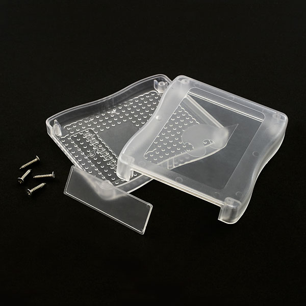

Here are the instructions for the Solar Power Module. Also shown below is an image of the Sparkfun clear plastic enclosure that would make a great companion to solar powered eChucK projects.
Les
