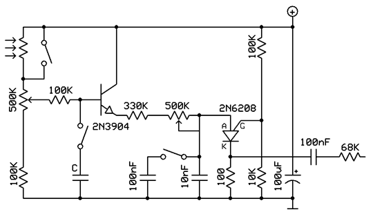

Right now I'm trying some ways to modulate the pitch. Instead of connecting the Anode with a resistor
directly to the positive supply rail I added another NPN transistor (2n3904). With the Collector connected to
the positive supply rail and the Emitter with a 100K resistor to the Anode of the PUT. This worked but the oscillator
only starts from a fairly high input voltage. So I did some more reading and noticed this:
In this circuit the base of the transistor is held at 5v (with a 10v supply) by the two 1K resistors. Equal values give a 'stand-off ratio' of 0.5. Obviously this UJT is programmable so this ratio can be changed at will, say between 1K:10K and 10K:1K.
So I replaced the 18K resistor with a 100K and the 33K resistor with a 10K and got a much wider range now.
I will do some more experimenting with that setup and post results.

That's pretty much the same as I'm doing except for the transistor, which has a high input impedance and low output
impedance. However the circuit itself allready isn't really low impedance, so modulating it directly (especially with a 555)
should work, except that you might get a small range like I did before I adjusted it. I also added a capacitor for a glide
effect (this is where the transistor comes in handy), just labeled C since it's value is dependent on your own
preference. Maybe a rotary switch with a couple of caps and/or a potentiometer in series is useful here.
Anyway here's the circuit for one oscillator, (I left the filter out of the schematic). you could feed a modulation
signal to the 500K pot at the point where it's connected to the LDR/Switch. (Leave those out is you do or use a diode in series)
O and I left the 10K waveshape pot out of this one since it reduces the range quite a lot.

I built the "Original Schrödinger II schematic with PHOBoS mods" circuit, except removed the LDRs and 10k pot from the oscillators, and increased the 68K's to 220K. I kept the 18K & 33K on the PUT's gate.
Another problem is that I tried building PHOBoS's buffered range control mod, and it doesn't work! I tried a couple of times, I'm quite sure I wired it correctly, but the output signal is extremely faint. I am using 2N6027s rather than 2N6028s (which is erroneously marked as 2N6208 on his schematic). Could that account for a difference?
Embarassed
how soft is it?,. I probably tested it having a line out signal, which is much lower than what you would normally get from a lunetta.
No idea about the 2N6027, I'd have to check the datasheet.

I also retried the buffered range control variant on one of the oscillators in a pair and still, the signal is extremely faint compared to its sibling.
I looked at the datasheet for 2N6027 and 2N6028, and to my basic knowledge, they look pretty much the same thing.

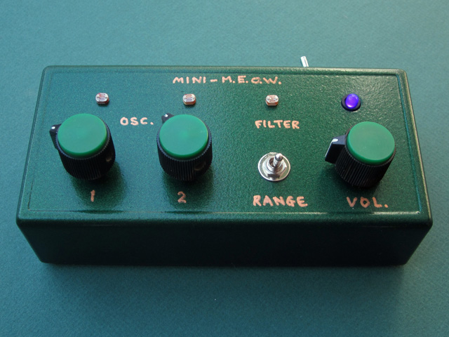

PostPosted: Sun Dec 07, 2014 9:58 am    Post subject: Reply with quote  Mark this post and the followings unread
After complicating things, then simplifying things, I've built the Mini-M.E.O.W. based on this circuit.
M.E.O.W. could stand for "Melliloquent Effable Oscillator Weirdness".
Originally I was thinking of making a 5-note keyboard, then settled on something that made more sense, with lead & drone oscillators, and filter controlled via CV or built-in LFO. That was the M.E.O.W. But I decided it wasn't worth the trouble, since the sounds would still be pretty limited and thus I probably wouldn't use it much.
Hence, I made the simpler mini-M.E.O.W., which is pretty much the same circuit I demo'd a while back. I just added a switch to change the capacitor in the oscillator pair to help with different ambient light conditions. The metallic green turned out darker than the spray can indicated, and doesn't quite come out in the photo. The "on" LED is purple.
Short demo video here: http://youtu.be/wrjFjAE10a4
-- James.
The Mini-M.E.O.W. box.
 Filesize:  120.23 KB
 Viewed:  540 Time(s)
