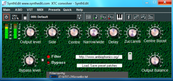

VST looks like this:
VST looks like this
