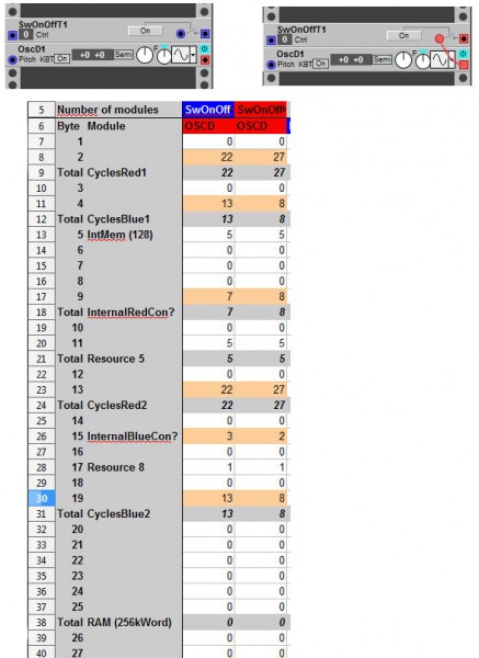

About the patch load calculation, I think I made some progress, by studying the manual again and some experimenting:
Resource 3 (byte 5) represents Internal memory, max 128 bytes.
Resource 10 (byte 20..25) represents RAM, max +- 260000 bytes (256kWord)
This fits for most modules, but there is still a factor missing
So memory calculation should be:
Mem% = max ( (100*R3/128) , (100*R10/260000), (100*R?/?))
And the Cycles, I made a discovery by uprating a module, so a module that has normaly blue output, turns to red output when modulated with a red source, as shown in the picture.
So I think Resource 1 (byte 1,2) and resource 6 (byte 12,13) represent Red Cycles and Resource 2 (byte 3,4) and resource 9 (byte 18,19) represent Blue Cycles.
Don't know why they are put in twice, and don't know exactly what the max values should be. Resource 5 also plays a part in the cyles. So for know I have this formula which comes close:
Cycles% = max( (100*R1/1352 + 100*R2/5000), (100*R5/258) )
So far the patchload.

PostPosted: Mon Feb 11, 2013 11:45 am    Post subject: Reply with quote  Mark this post and the followings unread
nice progress..seems to work.. what missing factor in the memory calculation? sofar the formular worked on all the patches i looked into.. can you point me to one where this dont works?
brunov
Joined: Aug 03, 2011
Posts: 227
Location: delft
PostPosted: Mon Feb 11, 2013 12:15 pm    Post subject: Reply with quote  Mark this post and the followings unread
It's the 2Out module, which has no internal memory usage and no RAM usage but the clavia editor shows 0.4% Mem.
What I find really strange is the difference with the 4Out module, which uses no memory at all, according to the clavia editor, and only 0.1 cycles. The 2Out uses 1.7 cycles, so 17x as much cycles.

PostPosted: Tue Feb 12, 2013 11:01 am    Post subject: Reply with quote  Mark this post and the followings unread
i ve some patches where byte 1,2 are not identical with 12,13
and also patches where 3,4 is not identical with 18,19
byte 13 seems to relate to the missing resource..
while byte 1 is identical with byte 12 in most cases , but not all.. byte 2 is not identical with byte 13 when only output modules are used.
byte 9 an 11 seem to be involved in the cycle counting too, at least byte 8 and 10 get higher than zero when cycles go above 100%

PostPosted: Fri Mar 01, 2013 3:03 am    Post subject: Reply with quote  Mark this post and the followings unread
I've seen that also, for example with the lfo. There are probably two factors involved that determine the amount of cycles of a patch, each with a certain maximum. Maybe we'll have to find two modules, one that uses more of the resource of byte 1/2 and the other that uses more of 12/13. Than put as much of each module in a patch until you reach the 100% to determine the maximum of the resource.

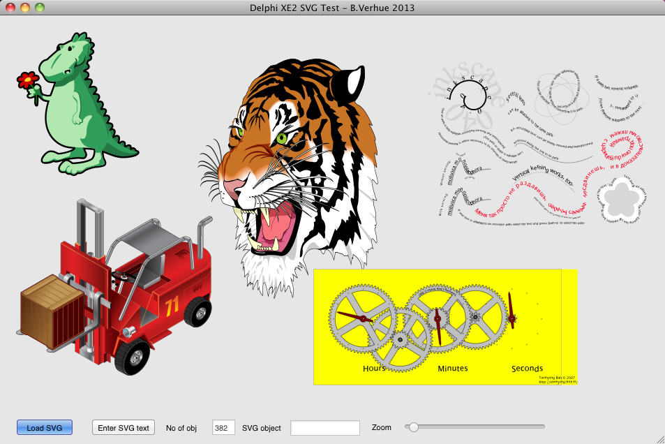

Sorry for the late reply. I've also been busy with the idea to use SVG graphics for the editor's interface.
I've made a test app. for OSX and Windows in wich SVG graphics can be loaded/tested. You can find it here : http://www.bverhue.nl/SVGControl/Delphi_SVG_control.html
There is a graphic in there called the "animated clock". You can manipulate the clock arms with the mouse. That's a bit like how the G2-modules representations could work.
So I imagine we could make knobs/sliders etc. as SVG graphics and put some of these together on a panel to create the modules. These can will than be linked to the G2 editors application logic using ID's you can assign to graphic parts.
 Filesize:  105.39 KB
 Viewed:  459 Time(s)

If Im the only one to want this function, forget that!
Maybe not exactly what you asked for, but something that I might be able to do relatively easy is a "patch buffer" function. I made a mock up as to illustrate this.
So with the knob "Add patches" you can load a selection of patches from disk.
Knob "VA to clipboard" you can select the VA part of a buffered patch and put in on the clipboard. So the you can past this in one of the active patches in the 4 slots.
Knob "FX to cliboard" does the same for the FX patch part.
Then you could als make a specific selection of a patch from the buffer, put in the clipboard and paste in in an active patch.
Or you could just load the whole patch in a selected slot with button "Load patch".
This could also be usefull if you build your patches from building blocks.
