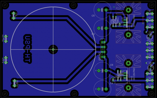

I'm in the process of building a PSU and wanted some advice/guidance before I commit.
I thought I would use a Thomas Henry design because this comes with an well written article, that breaks down the design choices and construction. I will also be making use of resources provided by our very own PSU wizard Osal, so I'm hoping he can help out here.
Links to the resources:
Linear Power Supply For Modular Synth Application
http://electro-music.com/forum/topic-51694.html
Nuts and volts article – Thomas Henry – Power Supplies for Electronic Music
http://www.nutsvolts.com/uploads/magazine_downloads/11/January%201998%20Thomas%20Henry%20-%20Power%20Supplies%20for%20Electronic%20Music.pdf
I've attached a redrawn schematic of TH design as well as a PCB layout depicting the parts placement. I pretty confident I’ve covered and understand most of the theory in this design, but I just want to double check a couple of things I’m not a 100% on. Also it would be good for someone else to review the schematic and PCB before I build it, just in-case I've missed or overlooked anything. I have made a couple of slight changes to the basic design but these are really related to component choices and PCB layout. These include a dual primary/ secondary transformer, 1N4002 diodes replaced with a bridge rectifier package (GBU4D) and added an extra set of smoothing Cap's in parallel.
So with this first post I was wanting to concentrate on the Mains wiring, Dual Primary / Secondary Transformer wiring and how the transformer secondary windings connect to the rest of the circuit (bridge rectifier - GBU4D)

Right down to brass tax. In the UK Main voltages are 230V + / - 10% and has a frequency of 50Hz. The colour code for Mains wiring is as follows
Post-March 2004 the UK standard was changed to:
Live = Brown
Neutral = Blue
Earth = Green and Yellow sleeving (no change)
(Note: This new colour coding is the same as used for appliance flexes in the UK for many years.)
Useful page for UK Plug wiring
http://web.onetel.net.uk/~uncletony/mains%20stuff.htm
I've opted for the safest Mains wiring scheme by using IEC Inlet and insulated Crimp connectors. The crimps are 6.3mm in size and can be attached to the IEC Inlet solder lugs as-well as PCB inter-connectors with the use of 6.35mm PCB mount blades.
Here are links to the parts and their respective data-sheets.
Connectors, Inlets
Insulated Female Connector 6.3mm
http://www.rapidonline.com/Cables-Connectors/Davico-Insulated-Female-Connector-Red-6-3mm-Pack-of-100-33-1062
Blade PCB Connector (Vertical) 6.35mm
http://www.rapidonline.com/Cables-Connectors/Blade-PCB-Connector-Vertical-6-35-x-0-8mm-100-33-4022
IEC inlets- switched and fused
http://www.rapidonline.com/Cables-Connectors/Polysnap-horizontal-switched-and-fused-inlets-66200
The IEC inlet has Live, Neutral & ground lugs marked clearly on the back of the device. It also has a box draw for a fuse, as well as three extra lugs that make up connections for the inbuilt Illuminated SPST switch. So the three unmarked solder lugs make up the SPST switch. Two lugs are accounted for by the SPST connections but that leaves an extra lug unaccounted for. (I’m not sure what the third one does as of yet, something to do with the LED in the switch).
By testing with a multimeter you can figure out how this IEC inlet works. Live Mains (230V) has to pass through the 20mm fuse before it passes to its solder lug on the back of the device. Neutral & ground pass straight through to their respective connections on the back of the IEC inlet. From there you have to wire the Live Mains to one end of the SPST switch.
The Transformer.
Here is the link to the transformer I’ve obtained. http://www.rapidonline.com/pdf/82719.pdf
It is rated as a 60VA and has Dual Primary/Secondary windings. I'm based in the UK so I will need to configure the primary windings to 230V Mains input by connecting them in series. If you look at the schematic or the transformers data-sheet you will see the colour code and schematic symbol for the transformers inputs.
Red wire = Live
Blue Wire = Neutral
Grey & Violet = connected together
By making these connections I should step down 230V to 18V - 0 – 18V.
The Thomas Henry design calls for a 36V centre tap Input to the rest of the circuit. With our dual secondary we accomplish that by once again connecting the winding in series.
RED = AC+
YELLOW + BLACK = Centre tap / Ground
ORANGE = AC-
The problem I’m having here is related to the GBU4D bridge rectifier. Because the Thomas Henry design used individual diodes for his rectifier, so it's easy to see the physical connections to the transformers secondary windings. With the GBU4D you are given AC1 & AC2 connections.
In the schematic I have connected AC+ (RED wire) to AC1 and AC- (ORANGE Wire) to AC2 of the GBU4D. YELLOW & BLACK wires form the Centre tap and the PSU Ground.
I guess my main question here is do you have to make specific connections from the Transformer secondary winding's (AC+, AC-) to the bridge rectifier AC inputs?
I think that should pretty much cover the basic wiring and connections of the various parts. Please correct me or add anything you feel is important.

I have to say my PCB layout is pretty much based on this:

Quick update.
I've redone the layout with the new heatsink, thought i would post an image like.
I've also added a star ground connection onto the board.
 Filesize:  131.33 KB
 Viewed:  414 Time(s)
Osal
Joined: Aug 16, 2011
Posts: 147
Location: Here
PostPosted: Mon Aug 12, 2013 3:25 am    Post subject: Reply with quote  Mark this post and the followings unread
Just to say that 3cw is for one reugulator. The same heat-sink for both regulators should be under 2cw.

mrmrshoes
Joined: Feb 19, 2011
Posts: 73
Location: Newcastle Upon Tyne
PostPosted: Wed Aug 14, 2013 5:03 am    Post subject: Reply with quote  Mark this post and the followings unread
Cheers for the head up man. well spotted like.
After carrying out some more research on heat-sinks i think I've got it cracked.
I had been basing my layout on parts from rapid electronics, but they don't have a wide enough range. Once i started rooting through the PCB mount heat sinks at Farnell I've found a number of suitable candidates.
I've went for the original PCB Mount heat-sink foot print (25mm solder pins), So i'll have to up date the PCB layout again. I should be able to get two PSU's out of one 100mm * 160mm board
anyway here are links to 3 C/W heat-sinks.

Regarding the PCB layout:
I would assemble the transformer on the case, close to the PCB, instead of on the same PCB.
I have seen that your case is wood made, a very nice suitcase I have to say.
In this case I wouldn't assemble the transformer on the case.
To house the power supply in a wood case could be dangerous. So, take special attention to the correct size of the fuse and to the sector of the PCB from the secondaries to the regulators. Protect it to avoid any accidentally short.
Avoid to assemble the transformer directly on the wood. You could assemble it on an aluminum sheet, and it on the wood, separated 1cm or so.
Another possibility could be a an external power supply, but this, I guess, is not so useful for a mobile device as a suitcase-synthesizer.
A draw·back of the suitcase could be a poor ventilation. This makes more difficult the heat dissipation of the power supply.
However this could be measured after you finish the synthesizer and if it is needed you could consider to open a few holes to add ventilation to the device.
