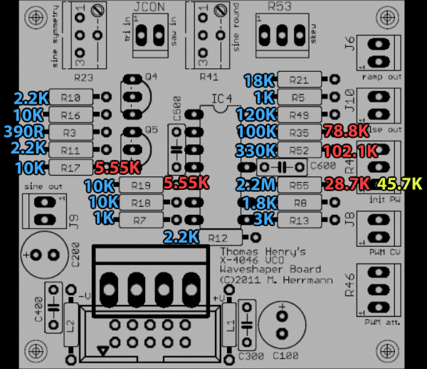

What is going on? Look at what my multimeter gave me for resistor readings. I made doubly sure I was only touching the legs of the resistor. RED = multimeter shows wrong value. BLUE = BOM value. I re-tested R17 multiple times, even testing it from the bottom of the PCB. All resistor markings are correct, but the value isnt?!?!?! Shocked
What's more interesting? The PCB I have not wired (my other waveshaper) shows the correct values on my multimeter! Shocked Shocked Shocked
Edit: On my second waveshaper, the multimeter shows 45.7K for the 2.2M value (R55). That's the only resistor that shows the wrong value.
Edit: RE-uploaded image. YELLOW = 2nd waveshaper wrong values.

When the resistors are soldered in, they will be connected to other components that can and will give you readings different than the nominal value.
For the really basic example, if I have a 100k resistor that is mounted parallel to the CW and CCW legs of a 100k pot (this is not a real world example), if I try to measure it I will read 50k--because it's seeing the two 100k's in parallel.
There's not likely to be anything QUITE that simple in this circuit, but I have never been able to read resistance reliably once the circuit is soldered together. It *is* dependent on the details of the circuit, however....
like elmegil said, measuring resistors in circuit is not that simple, actually. it might be that there are resistances in parallel that you don't see at the first glance.
wit ICs inserted? anyways, without wiring, and this wiring might cause parallel resistances...

Yeah, I think my next step is to wire my other X-4046 VCO and put this one (the one we were debugging) through an oscilloscope to ensure the DC trimmers are correct. I do want to correct the weak sine signal. I'll have to debug that later. I know Dave Brown does debugging. Is there anyone else I might ask to look at my waveshaper if I can't figure it out?

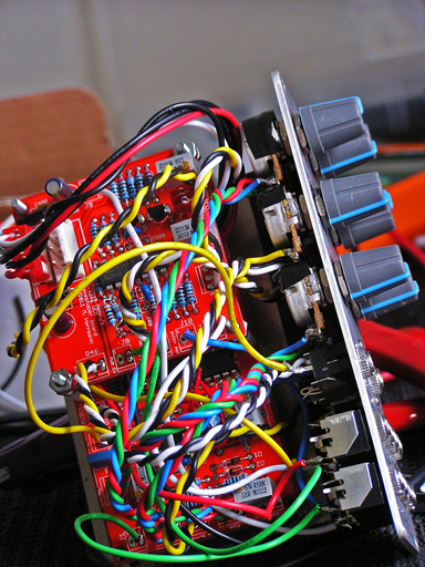

COMPLETED!!!! This is my second build, works flawlessly. Now I have this one to compare with my other one.
FINALLY!! FINISHED!!! JEEZ!!!
 Filesize:  243.91 KB
 Viewed:  38263 Time(s)
and some wiring pr0n.
 Filesize:  300.87 KB
 Viewed:  38264 Time(s)
