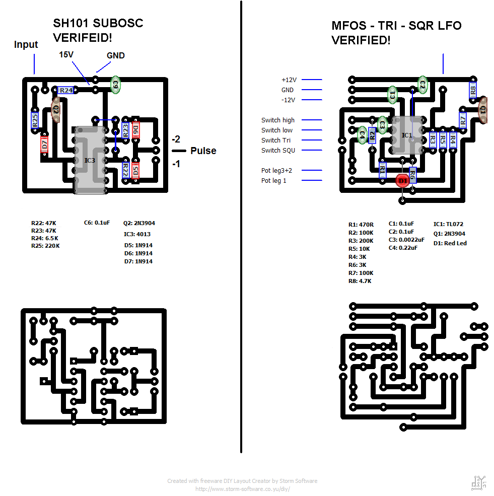

Hi Guys.
those are my layouts for the mentioned in the headline.
they are both verified and working great.
the LFO is from 0.01hrz to 1.43khz
i advice you to use 1M log for the rate pot, its very gentile when turning.
with the log pot is was ok.
for the putout you may use 100k lin.
those are small pcb designs, you can stuff them in addition to any design your making Wink
enjoy.
Isak E.

i've just etched and populated the suboscilllator and i really love it
unfortunately i dont get anything from the pulse output but i also dont need it so much. i didnt used a trimmer as u suggested and i didnt found 6.5k resistor but the closest that i had 6.8k worked fine anyway
actually i will use it for the thomas henry xr2206vco
i also added a 100k pot to blend the original signal with the sub.
pretty easy: just connect pin 1 to the original and pin 3 to the sub output; the wiper will be your mixed output
thanks a lot for sharing such an easy but useful layout.

I will try soon also the lfo, for now i etched already 4 more subosc. pcbs to use for a small analog groove box im building to get the fat bottom i was missing from my square waves

has anyone tried the lfo in 15 volts? I want to add it to my motm rig.

Hi there.
Works like a charm with 15V without changing nothing.
Enjoy.

hello all,
i recently found this. thanks for your work on the layouts. that sub osc is very nice.
i too had problems with the pulse output. i fixed it by inserting an 18K pull-down resistor to the pulse output. now the pulse outputs as well as the other two.
the lfo is nice too.
good work again

its nice to hear that you got the pulse working!
all you did is connecting the output of the pulse to ground through 18k?
cheers

yes sir. works great

thank you for this findings.
i never understood why the pulse was not working, maybe i'll remake the board with your 18k resistor.
thank you for your kind words my friend, enjoy the boards.

what switch do you recommend? SPDT?

If you mean the subosc then yes SPDT is fine.

i mean the lfo. i want it to be a quad lfo in motm format

For choosing the waveshapes Youll need spdt.
for the HIGH / LOW you can use spst or spdt.
