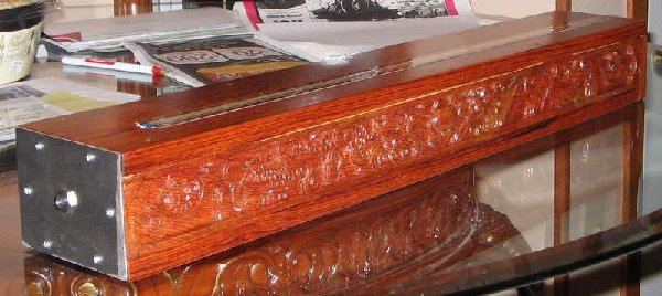

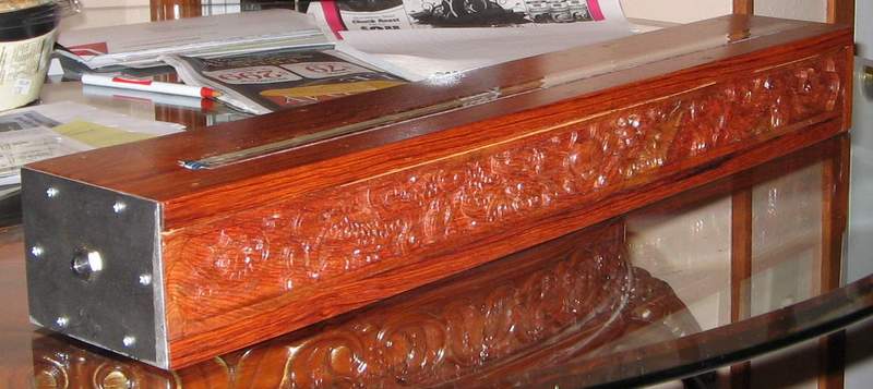

A BEAUTIFUL EXAMPLE OF THE TOUCH RIBBON CONTROLLER RIBBON ASSEMBLY BY SCOTT STITES
 Filesize:  45.97 KB
 Viewed:  1534 Time(s)

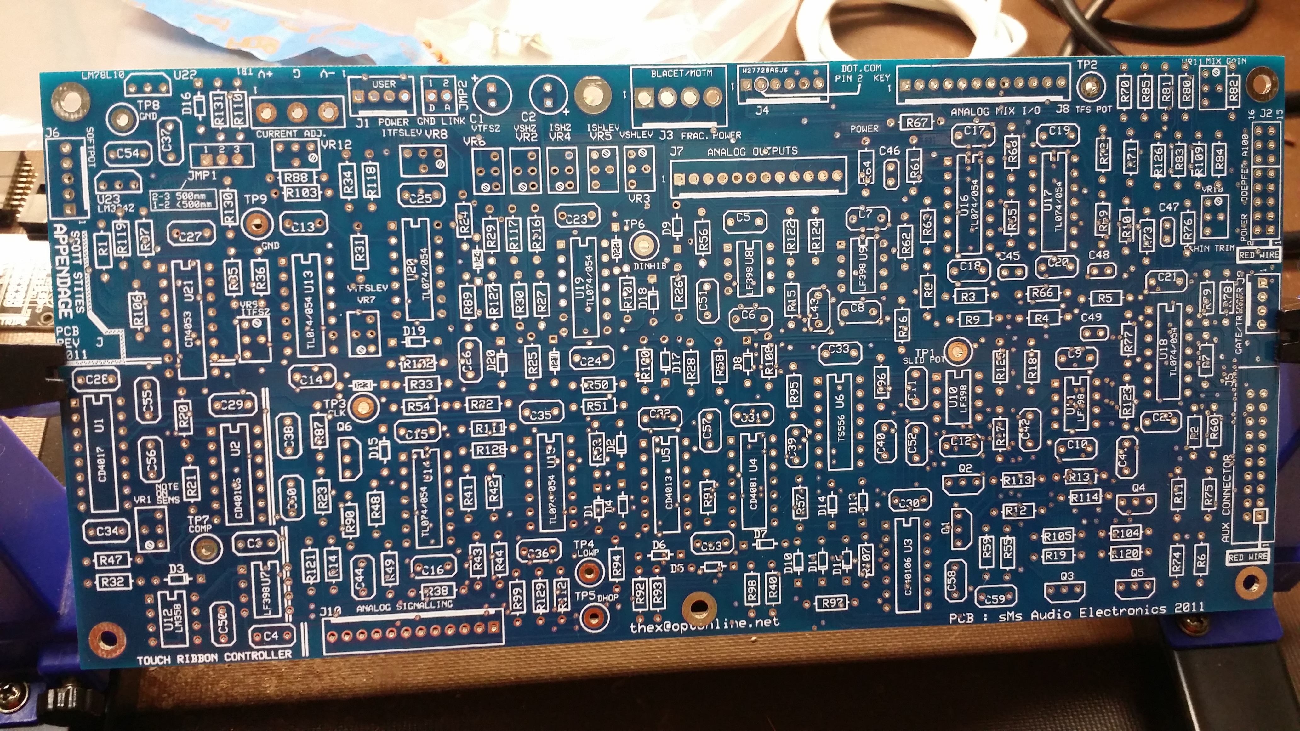

REV "J" PCB
 Filesize:  4.01 MB
 Viewed:  1098 Time(s)

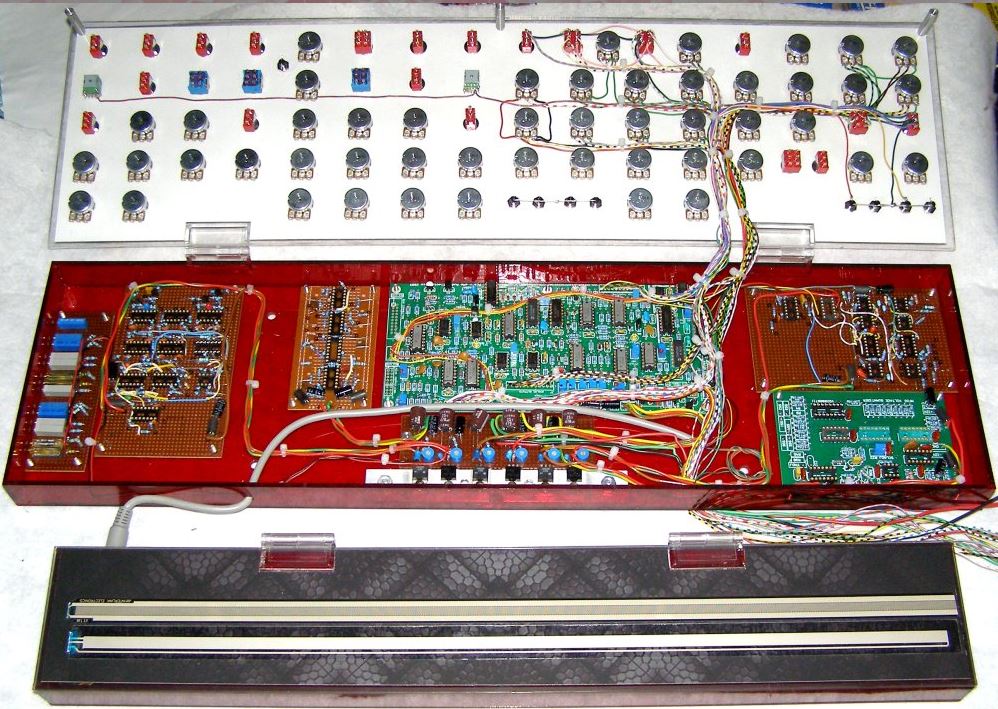

SynthBend Controller showing an assembled Appendage PCB
 Filesize:  195.55 KB
 Viewed:  1046 Time(s)
the SynthBend Controller constructed by The Electronic Peasant.
 Filesize:  138.3 KB
 Viewed:  1018 Time(s)
