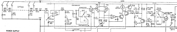

Hello,
I'm repairing a Korg Micropreset M-500 synthesizer that has one problem left that I'm not sure what the cause or solution is.
When portamento is on, the pitch of the instrument will drop up to a semi-tone. The higher the portamento time, the lower the pitch drops. I've attached what I think is the relevant part of the schematic, if anyone can suggest a likely candidate please let me know. There are trimpots, but I'm reluctant to adjust them without knowing what they are trimming.
Just to clarify, I do know what portamento does.
Thanks for any help.
Korg micropreset M-500 schematic, portamento section.

Hi tonewill.
I repaired a micro preset 500 with the exact same problem (and a bunch more), but this one was puzzling alright.
The portamento wiring runs along the pcb in two parallel tracks if my memory is correct.
Its a high impedance circuit and you need to keep it that way or else, you loose some precious electrons through the pcb and your pitch drops accordingly.
The solution is to clean thoroughly the pcb near that high impedance circuit. Along those tracks that go to the pot.
Use isopropyl alcohol, or regular alcohol if you don´t have isopropyl (its high impedance, but not condenser microphone kind). I like also like to use a pcb cleaner from kontakt chemie.
Also dry it well under an incandescent lamp. Humidity is low impedance.
In my case it was completely solved this way.
Hope its the same thing with you.

I have the same problem. When portamento is on, the pitch of the instrument will drop up to a semi-tone. The higher the portamento time the more extreme. Did anyone have any thoughts. I have changed 33uf capacitor.
Thanks

Perhaps it's a similar issue with impedance? Is there a trace on the PCB running from the lfo to something affecting the voice perhaps? If so, maybe try cleaning it with some isopropyl?
