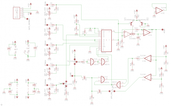

I'm going after the EFM VC-RADSR mentioned here:
http://electro-music.com/forum/post-224210.html#224210
schematic: http://www.modular.fonik.de/files/EFMforum/orgEFMfiles/vcradsr.pdf
I've got a euro-friendly layout pretty close, and I will make a prototype soon. Anyone see any problems with this capture of the schematic? I added the supply decoupling capacitors -- the CMOS are at middle left and opamps are on the bottom left. I did not put in the offset amplifier from the original.

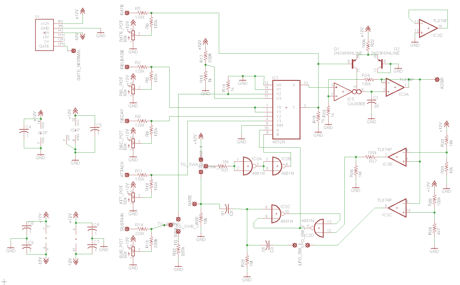

That first schematic missed a 10k resistor between Q1 and the OTA. Here is my prototype - will try one soon.
Eagle stuff here: https://github.com/jbeuckm/EFM_VC_RADSR/tree/master/eagle

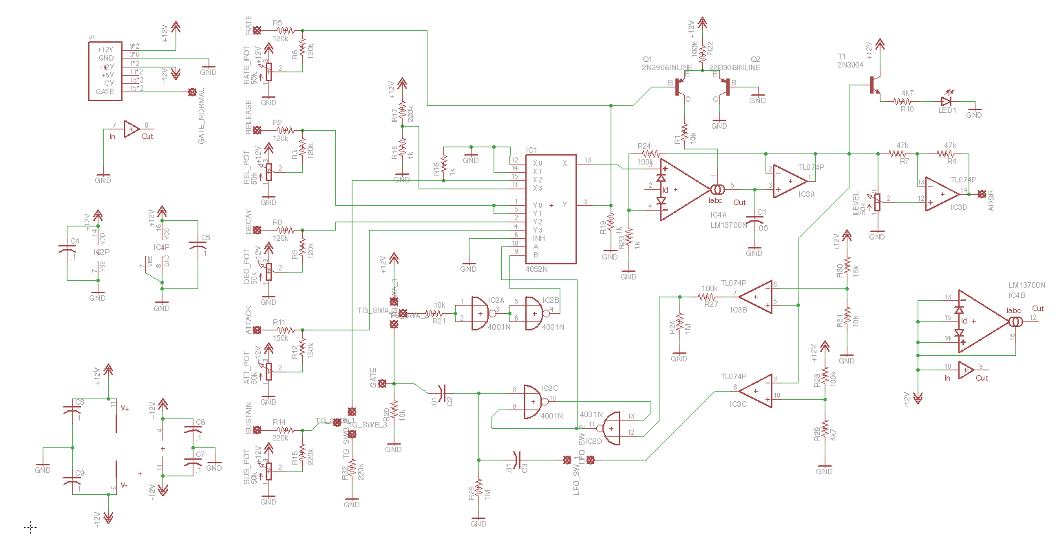

would you add a footprint for the lm13700 the ca3080 is only getting more rare and expensive

one thing: why did you leave out the attenuverter? all you need to do is add 2 extra resistors and a pot somewhere... you could make it optional, just the pads for flying wire installation... there's a spare opamp anyway...

@roglok I'll probably add the offset amp back if this works. I usually try to mount on the 16mm right angle pots. Is there a particular way you would do the mounting holes? No production run but my work in Eagle will be open if someone wanted to.
@glot I'll look into that lm13x00 substitution.

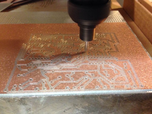

VC-RADSR prototype in progress

Here is an update with LM13700 instead of CA3080, offset amp from the original and an indicator LED with transistor driver. Let me know if you see any problems before I make one tomorrow.

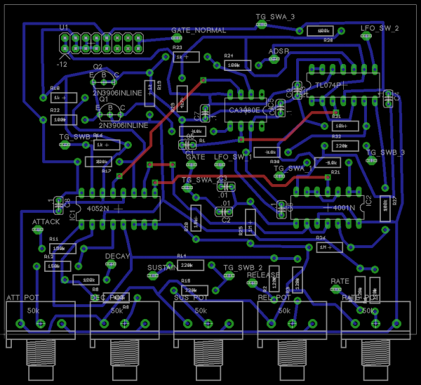

It works. Here is the layout. Eagle stuff available here:
