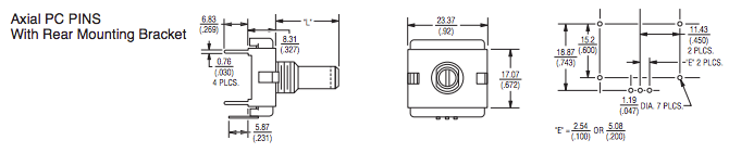

The part is PCW1J-C24-BCB104
This one at Mouser looks very close but the ones I have don't have the screwdriver slot. The footprint should have seven holes.
http://www.mouser.com/Search/ProductDetail.aspx?qs=TvYXSR6pz%2f2B%252bjErtushyA%3d%3d

Here is a shot at the package. Have not tested physically yet. Rename .txt to .lbr to use with Eagle.
bourns_slimline_panel_pot.lbr.txt
