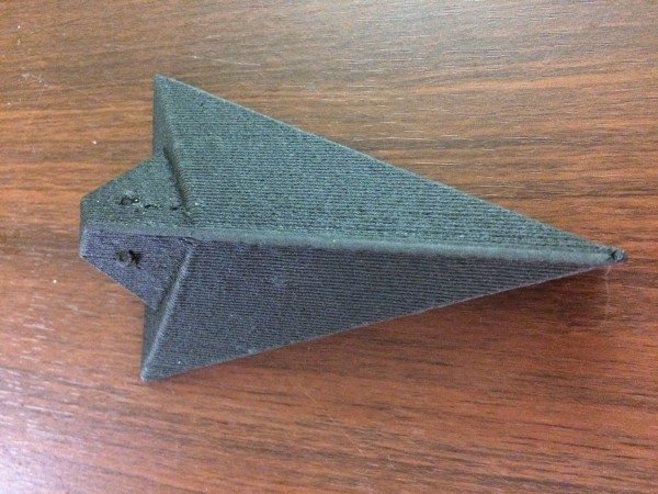

Hey all,
This morning I had a creativity moment and came up with the attitude shape, which I printed in carbon fiber PLA filament. There are a lot of things that can be done with this shape.
What I am planning to do is simple, very simple. I will make a resistive controller out of it by printing in conductive carbon fiber filament. The resistivity of this material is 1200 Ohm-cm, which means that you tend to get resistances in the 100k and MegOhm ranges, perfect for low-power Lunette circuits.
I will design the print to be paused and then received insert consisting of a stereo audio jack with three wires soldered to it. This insert will be pre-formed on a jig such that the print may be paused, the insert placed in it, then the print resumed and run to completion. The ground, tip (left) and ring (right) contacts will connect to the three wires, which will travel with their insulation intact to the three corners of this device where they will make contact with the print.
If all goes well, and I stick to the project, the result will be a controller that can be worked into a circuit in a variety of ways. Alternatively the wires can be sent to contact pads internally and an insulating material used for the print.
In the first case, moving your hand in physical contact with the conductive carbon fiber shape will alter the resistances between the three terminals, making your fingers provide shorting resistance to the shape, varying it's terminal resistance.
In the second case it may be driven as a capacitive touch sensor so that placing your fingers on or near the shape will change the music that is created by a capacitive touch sensor circuit.
In either case, example circuits will be provided or sold (assuming I stick with this project - time will tell).
If you think this is cool or would like to suggest an alternate shape, please advise, thanks.

PostPosted: Wed May 13, 2015 2:38 pm    Post subject: Reply with quote  Mark this post and the followings unread
sounds interesting, have you tried the pausing inserting something before ?
as for shapes, would a sphere with varying thickness work ?

These are interesting questions, PHOBos. I have not tried the pausing method before and upon reflection I am a bit concerned about doing it. Certainly the notion of a fully sealed device is appealing, however the risk of a wasted print due to nozzle leakage is a genuine concern. I'd rather avoid that part of the equation. Besides, that way the part becomes non-serviceable.
Before I get to the sphere, I'll interject that I thought of a great external treatment to turn this and other flat-ish shapes into controllers. I happen to have, from Adafruit, a kit for making FSRs (Force Sensitive Resistors). I thought I would make a pair of these and run the wires through a strain relief then onto a circuit board. That would give two variable resistors on a durable enough surface though not commercially viable, certainly quite usable for hobbyist purposes.
Now for the sphere. Yes, I can design a sphere with varying thickness and print it in flexible filament. I just happen to have bought a replacement extruder kit that comes with all the hardware, gears and such to print and build your own experimental extruder that prints flexible filament. So it's a project to get to that point. Once there, however, I can definitely print flex.
Now in addition to being flexible, your sphere must vary electrically. I happen to have, also from Adafruit, some flexible rubber chord. This material is 1/8" in diameter and I just measured it to have resistance of about 50 ohms per inch, varying to 100 Ohms when stretched by 30% or so of it's length. So a doubling of resistance with a bit of flex. The Sphere could be designed to be not solid but open aired with infill or webbing inside of it and channels to accept this chord, then the chord could be crimped at it's ends and sensed by the circuit with a current source or voltage divider or some such circuit. The low resistance of 100 Ohms could be brought up to a few kOhms by using a foot or so of the material in a few passes through a three inch sphere. The sphere would have to be flat on the bottom to be printed, but that's good to keep it from rolling away!
So there you go, yes and yes are your answers, PHOBos! Shall we collaborate?

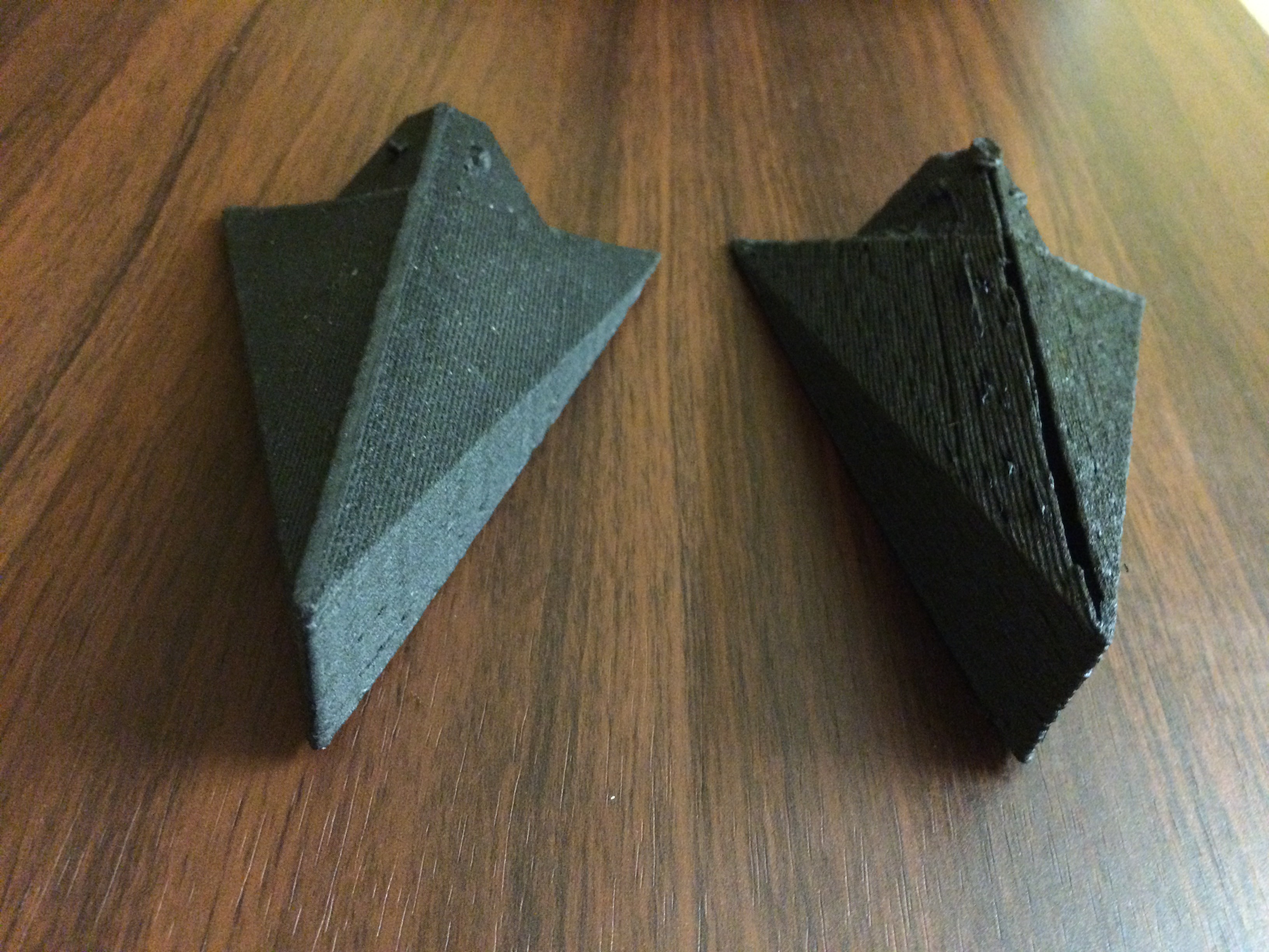

PostPosted: Wed May 13, 2015 11:24 pm    Post subject: Reply with quote  Mark this post and the followings unread
Actually PHOBos, if you are interested, I'd be happy to send you one or more prints for free including free shipping. I have the little priority mail boxes and plenty of postage that my Mom got for me before she went galavanting around the world again on a cruise ship, so it won't cost me a cent.
What I can send you is either the shape on the right, which is hollow inside and has an opening running down the center plus slightly lower quality of print, and the one on the left which is solid and higher quality.
My only stipulation would be that you do something cool with them and post about them here - no big deal as you do that all the time!
I'm happy to do this to help get the ball rolling in the use of 3D printing at electro-music. What do you say?
Les
p.s. I can make other prints too, if it's not overly time consuming (hours not weeks), like a favorite logo or a small project enclosure - as long as it fits in a small flat-shaped Priority Mail box.

PostPosted: Sat May 16, 2015 4:18 am    Post subject: Re: Robotica
Subject description: A Music Enclosure and Project
Forgive my ignorance, but how does that work? I've built ribbon controllers using resistive videotape, and if one wires it as a variable resistor, there's a terminal at one end of the tape, and another on a conductor wire. Pressing your finger makes the tape and conductor contact, thus completing the circuit. If I'm understanding correctly, what you are describing works without the conductor part?
Another question I have is how durable is the conductive carbon fiber filament? One problem I had with my videotape-with-guitar-string-suspended-above style controller is that it wasn't long before the resistive material started to degrade.

PostPosted: Sun May 17, 2015 11:42 am    Post subject: Re: Robotica
RingMad wrote:
.:James:.
Unfortunately carbon fiber filament, which used to be conductive with 1200 Ohm-cm is no longer conductive. I just measured it and there was zero conductivity in the filament. This is disappointing to me but I guess it is a result of process improvement of the filament supplier.
As far as its durability, it is extremely durable as it is stiff and strong but inflexible. I have a small carbon fiber object to a large man with a strong grip, stronger than mine and asked him to break it. He tried and could not. Neither could I. This object was long and thin (a Christian cross), so I'm surprised it was that strong. Then the nurse said something about polymer bonding and I realized it's more than just mixing the fiber together with the processed corn oil polymers.
So that controller type is out, but I do have some carbon fiber so if anyone has some guitar mount or some other thing that is not strong enough, give a holler.

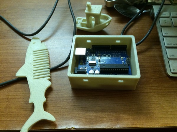

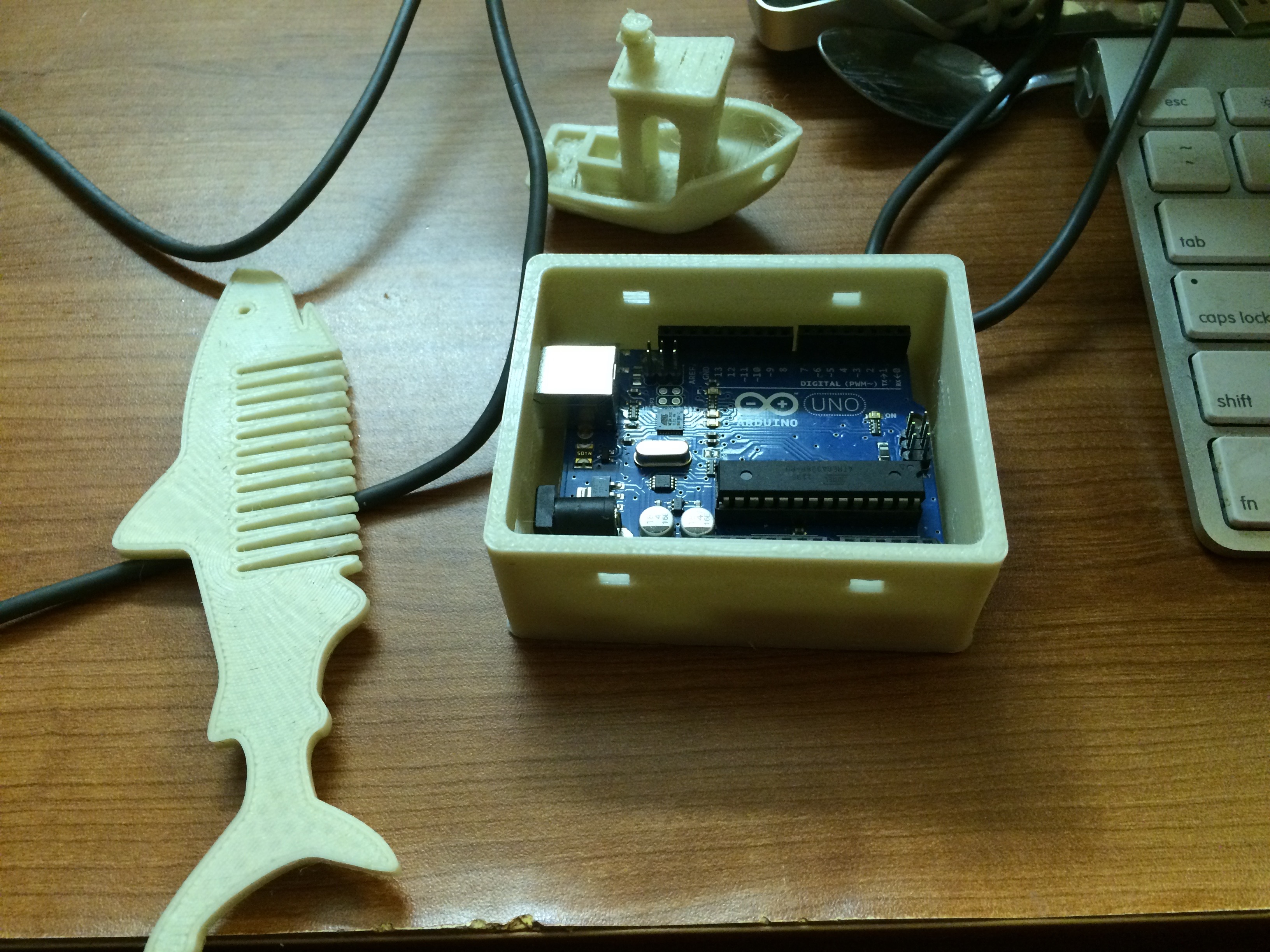

PostPosted: Thu May 21, 2015 1:44 am    Post subject: Reply with quote  Mark this post and the followings unread
Here is a photo of a standard 3D printed project box, printed in glow-in-the-dark filament.
Les

PostPosted: Thu May 21, 2015 10:54 am    Post subject: Reply with quote  Mark this post and the followings unread
Glow-in-the-dark filament? Cool! I'll have to think of something for that.

PostPosted: Thu May 21, 2015 1:24 pm    Post subject: Reply with quote  Mark this post and the followings unread
.: James :.
Sure James, just let me know. The stuff I have is pretty strong and it prints fairly well (ColorFabb GlowFill). There are all sorts of materials out there - the metals and the woods, brick and just about anything you can grind small enough to put into a filament!
