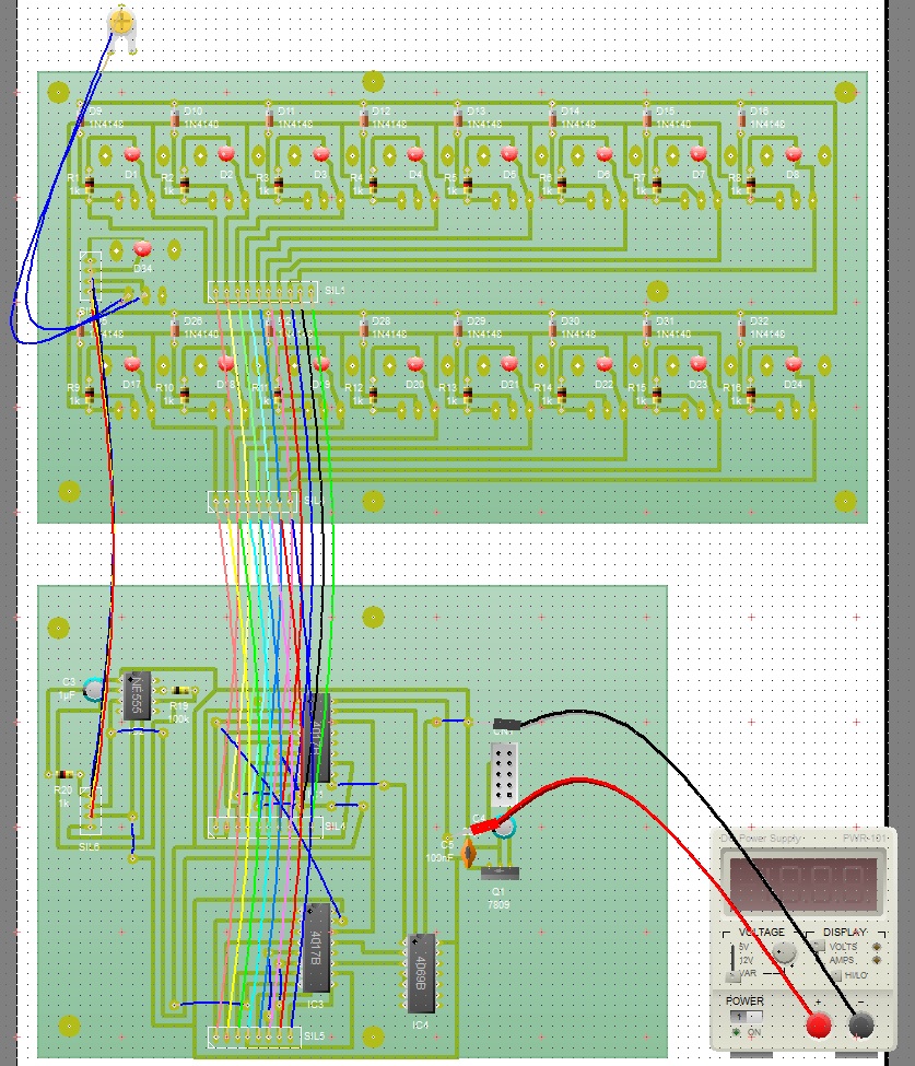

01012k7
Joined: Aug 31, 2013
Posts: 25
PostPosted: Fri May 15, 2015 11:31 pm    Post subject: Reply with quote  Mark this post and the followings unread
baudrate wrote:
6581r4AR wrote:
I haven't tested this myself, but I'm pretty sure this will work. I also don't know how it compares to what is shown on page 6 of that datasheet either. I hope it helps though.
I just put this together on the breadboard and verified this works!
Ok was working on this on Friday but the software I have is easy to use and because I only make single sided boards and don't get them made buy a company yet..so this the problems I can see with the design
there is a delay between step 8 and 9 its a step which makes 9 more like 10 also the speed adjustment it works the wrong way round so I turn it the other way its the same Smile I am hoping its the software may not be I have change the hex chip to see if that was the problem but its not works the same I just have them in stock .. the picture has clear shaft pots also lots of wire you see the boards will plug into each other so think at the moment I will have about 11 links which I will look into later

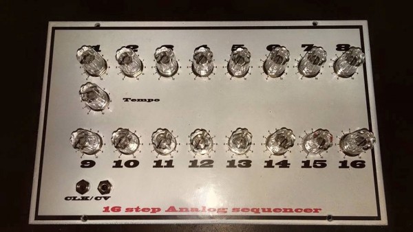

01012k7
Posts: 25
PostPosted: Wed Jun 03, 2015 12:26 am    Post subject: Reply with quote  Mark this post and the followings unread
That's the plan now switches and gate out.
completed version .

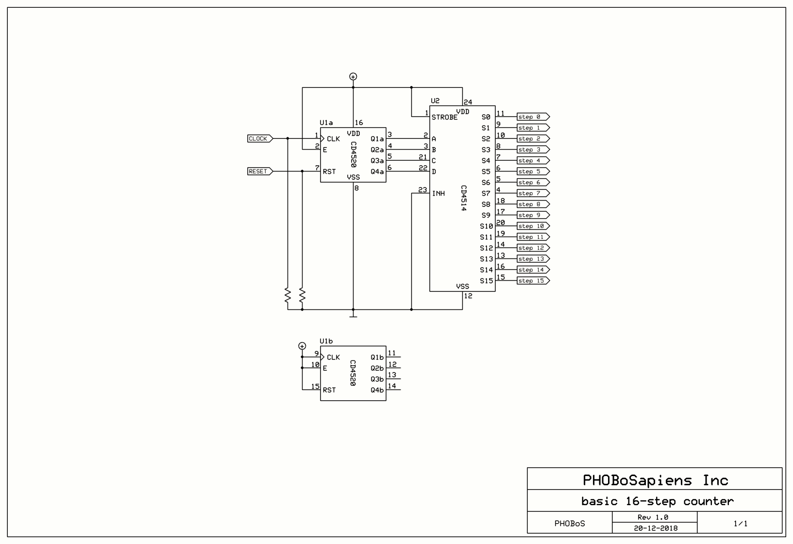

PostPosted: Tue Sep 29, 2020 1:24 pm    Post subject: Reply with quote  Mark this post and the followings unread
Hi everyone,
has anyone managed to get a 16 step, cascading 4017 sequencer with selectable number of steps working yet?
I've got the cascading part working fine. Just followed the suggested schematic on the datasheet and paid attention to which of the output are "decoded". It's the number of step that i am having problems with as i see others have had in the past.
Any working approaches to this problem would be very well received.
NM
Posts: 5947
PostPosted: Tue Sep 29, 2020 3:46 pm    Post subject: Reply with quote  Mark this post and the followings unread
As some others suggested in this thread it's far easier to just use a binary counter followed by a binary to decimal decoder.
The attached circuit diagram should be enough to get you started.

NuttyMonk
Joined: Jun 30, 2020
Posts: 63
PostPosted: Tue Sep 29, 2020 4:58 pm    Post subject: Reply with quote  Mark this post and the followings unread
Thanks for the quick reply Phobos. I was trying BCD counters and Mux's and then i went onto 4017's but this seems a lot easier to work with then the 4017's. I was hoping there was a 4017 with 16 stages but no such luck.
Will try out some schematic ideas with these two chips instead.
NM
p.s. why the resistors to ground on the clock and reset pins? Is this to drain off some of the current going to those pins?

Posts: 5947
PostPosted: Tue Sep 29, 2020 5:30 pm    Post subject: Reply with quote  Mark this post and the followings unread
That's to keep them from floating if you don't connect anything else directly to them for example if you use them as patch points.
If you do leave pins on CMOS chips unconnected they are sensitive to (electromagnetic) noise and can switch between states
which can cause unwanted behaviour. If however you hardwire them as part of a circuit you don't need them. For some more
info see basic guidelines for digital circuit design.
p.s. has anyone ever tried putting a switch and inverter between the bit outs of the counter and the bit ins of the 4514? That should create some different and unusual sequences shouldn't it?
yes, you can get some nice patterns by messing with the bits. Instead of inverters you can use XOR gates which work
as switchable inverters and if you invert all the bits it will count backwards.
