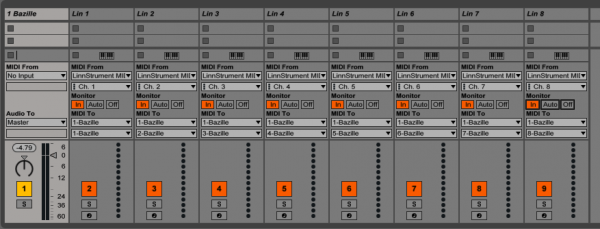

In Live you can just use one instance of plugins that support multi channel midi like Bazille and route the midi to the correct track, you no not need to replicate the plugin.
I have included an image showing Live with one instance of bazille using 8 channels from my Linnstrument.
I also find playing chords with my left hand on the linnstrument difficult and I'm a guitar player, my left hand seems upside down to me!

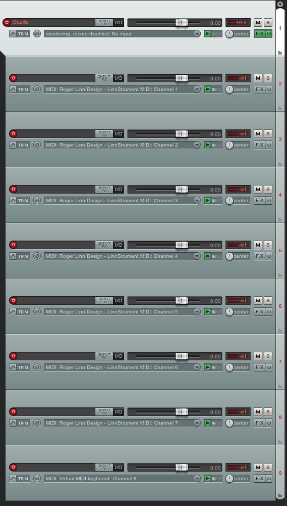

PostPosted: Tue Sep 08, 2015 12:02 am    Post subject: Reply with quote  Mark this post and the followings unread
Hi Des,
I looked how to do it in reaper.
First create an instrument track with Bazille on it, set midi in to none.
Now add 8 midi tracks, set each track to the linnstrument and correct channel.
Now select all 8 midi tracks and drop them onto the Bazille track, now the midi tracks are "owned" by the Bazille track and the midi from them is automatically routed to the plugin.
Enable record monitoring on the midi tracks and off you go.
I have included an image.

Interesting wrt your Live solution. I have heard that Live always merges all the data coming into a track which would take away the individual MPE data from each channel. I suppose it would be easy enough to test....Load the layout and then play/hold two notes and then pitc one up the other down. If it goes smooth its working. if it jumps the data is merging.
You've tested it like your setup? That would be so cool if it worked! Would save me some grief in my setup.... I wonder then if it would work that way with Omnisphere or M1? I guess the difference being Omni and M1 are setup with discreet channels while Bazille is not. Btw...if you have the Korg M1 plugin, load the Guitar 1 patch in each slot and set each slots channel sequentially...then play some Linnstrument riffs. Sounds pretty cool! Different then the Omni Steel patch, but still cool.
Interesting bit with Reaper. I had started playing around with the same idea...just thought it would 'neater' to just have everything on one track.

Yes it definitely works, works with Omnisphere and M1 as well as long as you use multis. Basically it will work with any multi channel plugin, old style (omnisphere, Kontakt, m1 etc) or new style (braille, diva, Aalto etc). I have has conversations with Roger about this, I hoped he would update their site with details of how to do it in Live.

Wow! I just tried the Ableton Maneuver and it works great! The thing I guess that is being missed by most is the second MIDI To slot assignment. Most people are leaving it set to Track In where the trick is to set it to the plugins input. Very Happy I know I never gave it a second look when trying to get it to work before. THANKS!
