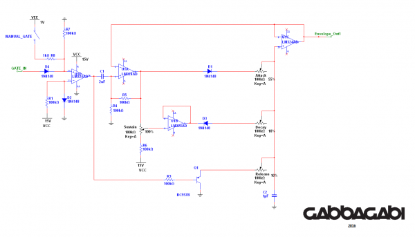

This is the Basic ADSR circuit i drew up.
The circuit is heavily influenced by the Nicolas-ADSR and the YUSYNTH-ADSR .
I was always attracted by the simplicity of the Nicolas ADSR but the sustain Part I found always a bit imperfect.
Additionally I am obsessed with realizing all circuits only with Resistor values of 1k, 100k, and 1M, Transistor free when possible.
And then as I saw the Sustain MOD of the YUSYNTH ADSR --> bingo.
The Idea is a bit older so I developed some variations over the time, I will put them in the next posts.
Circuit is tested with 15V Supply Voltage.
The circuit works very well with one exeption: you will always find a more or less little offset voltage on the output, during the tests I measured between 0,2V and 0,5V! (It may can be avoided if you use a FET instead the PNP Transistor??? But I haven’t it tested yet.)
EDIT: i think not using a poa-cap is the solution
A little about the circuit:
The Gate Trigger Level is at about 0,6V (the Voltage Drop of D2), it is designed like that because no change is needed when you change the supply voltage.
The Value of C1 is not so critical. I have tested on the Breadboard values between some hundred pF and 10nf.
The Amplitude of the Envelope is determinate by R4 and R5, when both are equal the Amplitude will be about 0,5x Supply Voltage. Choose the values according to your needs, especially if you change the supply voltage.
Choose the A-D and R Pots and C2 according to your needs.
The Value of the S-Pot itself is not critical, but the value of the pot and R6 has to corespondend to the propotion of R4/R5.
The opamp is lm324 because it is quite robust and can work on single supply.

Hi g.gabba,
Thanks for posting this nice envelope generator, I think its a simple but elegant design.
I immediately wanted to simulate it. At first I had a little trouble getting the circuit to work right (perhaps I copied it incorrectly), but with a bit of fiddling I got it working correctly I think.
I have attached the schematic I simulated (with some of my tweaks).
There were a few things that puzzled me that I set out to try and fix.
First up I think the offset you mention is caused by the diode drop of the pnp transistor, so it cant ever quite release down to ground. I offset the collector and base a little to compensate.
Second, your input comparitor opamp seems to have its negative rail tied to ground which I assume is presumably to clamp its output to ground also. I instead fed the pnp threw a diode, allowing that opamp to have its negative rail set to -12v (in my case). Now that all the opamps have the same supply it should allow everything to run from a quad opamp. I saw however you seem to already be using a quad opamp so have I perhaps missed something here?
Lastly, I had to add a 200k resistor between the schmidtt trigger and the sustain pot so that the sustain pots leg is held effectively at 0v. Thus the sustain pot wiper ranges from 0v to Vcc/2.
Have I done something wrong when I copied the schematic?
With these tweak it certainly acts like a great little envelope Smile
Thanks for sharing this design!
EDIT:
I think I misunderstood the original design, and it seems obvious now that the opamps are all of course fed from +12/gnd. I'll leave my original questions up since I think they are still interesting.
Modified g.gabba envelope

PostPosted: Sat May 14, 2016 12:34 am    Post subject: Reply with quote  Mark this post and the followings unread
yes, there is something wrong.
the connection R1*R2 should be before C1, or else you will not get a sustain level of the same width as the gate.
but by doing that, remember to place a high value resistor between C1*+In U1 and ground or else, depending on the type of opamp, the cap C1 might charge from the bias current of +In U1 effectively locking up U1

PostPosted: Sun May 15, 2016 3:56 am    Post subject: Reply with quote  Mark this post and the followings unread
Hi Pantheon ur welcome,
and thx for reminding me that there are a few things left to do Smile
Your simulation schematic looks good.
I think i will find time next week to work on the offset quest on the prototype.
The negative supply pin of the quad opamp LM324 was tied to ground because the circuit was designed single supply as it was mentioned above, but may i should place a note in the schematics, like others already do.
But you did exactly what was needed to make it working dual supply (the 200k resistor).
I have the schematic not posted because I thought that recently everyone wants to have only single supply circuits. I post it now.
@Grumble with equal value at R1/R2 u will have the Attack peak at half supply voltage level (6V in Pantheons case), so i cant see something wrong there.

I'm sorry, just noticed that U2 is a Schmittrigger Embarassed

PostPosted: Tue May 17, 2016 1:04 am    Post subject: Reply with quote  Mark this post and the followings unread
The reason you need a dual supply for this type of ADSR is that the PNP needs a negative voltage on its base (at least -0.7V negative) in order to fully drain the cap during the Release phase when the gate goes low.
Another thing to watch out for with this is that some PNP transistors will behave badly if the base goes all the way to -15V, hence some variations on this ADSR arrangement have an extra resistor to prevent it going too negative during the gate-off phase.
And another thing to watch for is the current capabilities of your opamp when operating near the limits. The LM324 when on a single sided supply can put its output down to ground only if the current it is required to sink is really tiny, like microamps. A lot of opamps are like this, they can swing their outputs near the rails, or they can handle milliamps of current, but not both those things at the same time.
Nicolas

PostPosted: Tue May 17, 2016 9:39 am    Post subject: Reply with quote  Mark this post and the followings unread
thx nicolas,
sometimes is the obvious so obvious that you cant see it.
For the moment i will leave it like it is, the single supply version has an offset the dual supply version not.
Do you know for what i have to look for in the datasheet to check the opamp current sink capabilities, eg TL0x4 which i use regularly?

PostPosted: Wed May 18, 2016 2:40 am    Post subject: Reply with quote  Mark this post and the followings unread
To run this ADSR on a single supply without major modification to the circuit I would use a couple of resistors and an extra opamp to create a virtual ground. If you are building a module which will have its own battery then that is job done. If the ADSR has to share its power supply with other modules then you will need to add a level shifter to remove that offset. Give me a minute and I will try to draw it.

PostPosted: Wed May 18, 2016 3:33 am    Post subject: Reply with quote  Mark this post and the followings unread
Here is a drawing of what I am talking about - a 1.2V virtual ground which will allow the PNP to get properly biased, but will create a 1.2V offset in the output, so we add a 1.2V level shifter as a final stage. Also adding in a diode to create a crude offset in the sustain level to keep the pot range about where it should be. All of this is completely untested, so I there may be errors in the details I have drawn, but the general principle is sound I think. One thing to note is that current through the diodes should be small and matched between the virtual ground and the level shifter.

PostPosted: Fri May 20, 2016 10:41 am    Post subject: Reply with quote  Mark this post and the followings unread
thx nicolas for the input,
looks interessting, but iam not so into virtual ground technics,
so iam working on a (more basic) solution by replacing the PNP with a double NPN.
the offset by now is a little noise @20mV, not bad i have guessed. But then i hooked this up to my thruZeroVco together with a LFO --> a regular auto triggering has happend. Maybe a voltage can sneak to the negative input of the triggerOPA via the direct connection to the output.

PostPosted: Sat May 21, 2016 3:59 am    Post subject: Reply with quote  Mark this post and the followings unread
Yes, the NPN solution should work well. Let us know what configuration works best.

after a hard week, i burned the last opa and broke my glasses, i had the (hopefully) problem-solving-idea under the shower (no joke) for the single supply adsr. No more autotriggering observed.
I observed one nice strange behavior, there is a spike before the release if u set the attack to zero (right scope), if u set attack a little bit over zero the spike will disappear (left scope), it is a unique feature-bug i like to keep it
the offset is down to 20mV (ch2 scope left, both channels meassuring same point),

Schemo update,
i gave up the single supply idea,
usefull or not some features added,
the previously observed spike at sustain end was due to bouncing of the manual gate pushbutton, debouncing action is advised here
cheers

i'm diggin on these minimal module designs you're posting, sometimes I feel like it's diminishing returns with people's more complex designs! i like the idea of building a whole synth on a 4x4" perf. that would be true genius.
PostPosted: Thu Aug 31, 2017 3:39 pm    Post subject: Reply with quote  Mark this post and the followings unread
I'm quietly looking forward to gabbi's freq shifter, those usually use a monstrous amount of components. So his version should be very cunning!
