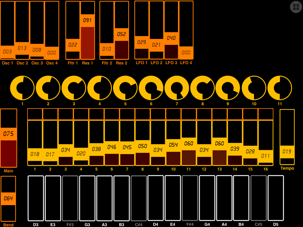

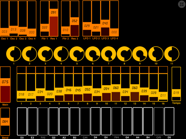

Too bad that thing only has a MIDI interface. It could easily choke on the 64k buffer limit using all those CCs. USB is a saving grace in that regard. I have a BCR-2000 that I love, but you have to remember what you assigned where.
Right now I am using my iPad 2 and a custom MIDI-Touch template to control the G2 Engine. See pic below.
