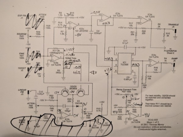

hello everyone,
My 555 VCO produces nice waveforms, but their output voltage varies with frequency.
The sawtooth and square measure about 4 V
the triangle about 2 V
The effect is most pronounced with triangle signal, as, increasing its frequency it gets to almost 4 V and therefore gets much louder.
I wonder whether or not this is normal.
i believe voltage output should be the consistent regardless frquency.
Any ideas? thanks |

pin 2 on IC 3a may be considered as a "virtual earth summing point" of the inverting amp built with it (http://www.electronics-tutorials.ws/opamp/opamp_2.html)
so that being (around) 0V should be OK.
That being said, I am surprised by the -3.3 V at the pin 6, since IC 3b is also an inverting amp |

Yes, I realised this later on that pin 2 on IC 3A would be pushed towards ground by the feedback resistor, was a bit tired there after troubleshooting several hours and I'm just learning about all this
By twisting the Coarse pot I can get from -0.3V to +0.25V on IC3A output pin 1.
IC3B pin 6 is actually around -3.8V now (I've twisted pots and exchanged the 3906:s so maybe because of that)
Could you elaborate on that? I'm still trying to understand how this circuit should work
There's around 10V on the output from that opamp, but there's a cap going from the output to the inverting input so no DC coming through there. |

hedefalk wrote: |
The DC current flows through R23 and Q2, by the way since this is a PNP transistor with the base at 0 V, the emitter should measure something like + 0.7 V, so the -10.5 V also surprises me |

Check IC3 and it's connections. Pins 8, 9 and 10 should all be the same voltage. _________________ My synth build blog: http://gndsynth.blogspot.com/ |

hedefalk wrote: | Could you elaborate on that? I'm still trying to understand how this circuit should work  |
as i see it this is a clever approach of the classic integrator(IC2A)/comparator(IC3C) VCO with C4 being the timing cap, only that the switching is done by the 555 (ISO a JFET).
BTW how did you measure the voltages? It would not make much sense to measure the voltage with a DMM at pins IC3C/p8&9 and IC1/p2&6 since this is where the actual core oscillation happens. Or do you have a scope for the measurements? _________________

They are not. non-inverting input (pin 10 is negative close to ground, -0.2V and and 8, 9 (output and inverting input) are saturated pos on around +10.3V it seems. Why should they be the same? There's no feedback resistor?
This circuit is really hard to understand for me, I guess it was probably not the best thing to start with as a newb  |

fonik wrote: | hedefalk wrote: | Could you elaborate on that? I'm still trying to understand how this circuit should work  |
BTW how did you measure the voltages? It would not make much sense to measure the voltage with a DMM at pins IC3C/p8&9 and IC1/p2&6 since this is where the actual core oscillation happens. Or do you have a scope for the measurements? |
I'm using this cheap ebay 18$ digital scope. I actually bricked my multimeter so I'm only using that scope to measure everything.
I HAD oscillation at one point on these pins but at 47kHz (could this be what a saturated +12V CV would give?) but at this point I have no oscillation, but around +10V constant. |

are you powering this circuit from 12V or from 15V?
measuring the voltage on the control pin of the OTA is not that simple. this input is a current input. it normally sits on the negative supply and should go up just a little bit when you feed this circuit a CV.
anyways, maybe you should start from scratch with just the OTA, IC3C and the 555.
leave off the expo for a start, just connect a 100k pot (between +V and -V)with wiper via 56k to the OTAs control input. _________________

fonik wrote: | are you powering this circuit from 12V or from 15V?
leave off the expo for a start, just connect a 100k pot (between +V and -V)with wiper via 56k to the OTAs control input. |
I'm using 12V (eurorack)
Thanks, I'll try that! Sorry if stupid question, but that's the amp bias input you mean on the OTA? Pin 1? |
Joined: Jun 07, 2006 Posts: 3950 Location: Germany
Posted: Thu Aug 31, 2017 3:27 am Post subject:
yes, pin1.
and if you measured -12V on the OTAs pin1 then this is the negative supply. i think it is a safe bet that you either got no control voltage/current to this pin (see my post above), or that your OTA is fried.
pin1 (pin 16 resp) sitting on the negative supply no matter what you do is a safe sign for a dead LM13700. _________________

hedefalk
Joined: Aug 29, 2017 Posts: 51 Location: Stockholm, Sweden
Posted: Thu Aug 31, 2017 3:59 am Post subject:
I'm more and more expecting these cheap Chinese breadboards I'm using…
And yes the OTAs pin 1 stays at -12V no matter what. I'm into my third LM13700, I'll try one more (only have 5) before I rebuild from scratch. Not good if my current setup is instantly frying those chips
I did what you suggested with the current one though. I have triangle oscillation in OTA pin 5. YEY! And I can control the frequency with the 100k pot. I'll probably just sit here and twist that knob all day - this is the first time I've heard anything, been just watching that scope for a few days
Still, the OTA pin1 is constant -12V. So the voltage drop over the 56k resistor is the whole diff between anything I turn the pot voltage divider to. Anything from -12 to +12 and the other side of the resistor is still -12K. You sure about the OTA being dead then?
By the way, when I probe pin 1 with the scope, the tone rises a couple of octaves - I guess the scopes impedance isn't very high? Or is this just the case since this is a current input?
Thanks a lot for all the help |
Posted: Thu Aug 31, 2017 4:18 am Post subject:
hedefalk wrote: | I did what you suggested with the current one though. I have triangle oscillation in OTA pin 5. YEY! And I can control the frequency with the 100k pot. I'll probably just sit here and twist that knob all day - this is the first time I've heard anything, been just watching that scope for a few days  |
now this is a starting point, isn't it?
so you just have to re-build the expo section now. make sure that you have the transistors in the correct pinout and orientation. if you are in doubt refer to the datasheet, or take a look here:
Quote: | Still, the OTA pin1 is constant -12V. So the voltage drop over the 56k resistor is the whole diff between anything I turn the pot voltage divider to. |
the 56k converts the voltage to a current that is suitable for the OTA (Ohm's Law). remember, the OTAs bias input works with current, not with voltage.
Quote: | Anything from -12 to +12 and the other side of the resistor is still -12K. You sure about the OTA being dead then? |
IIRC one expects just a tiny change in the mV range. maybe you simply cannot see it on the scope with the current setting. _________________
