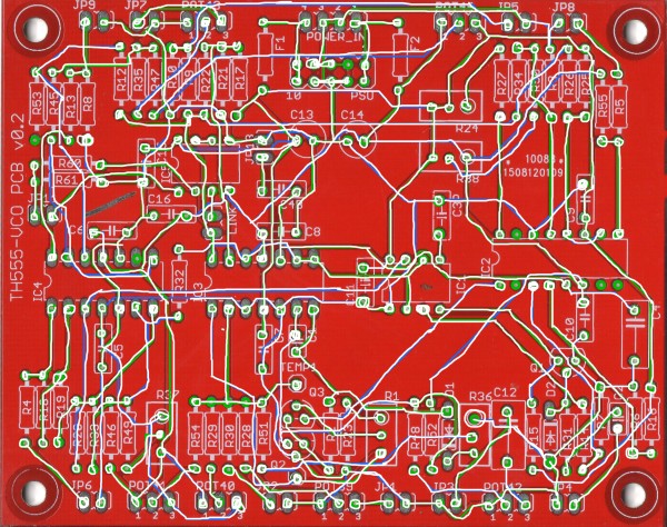

NathanS wrote:
It looks to me as if R2 and R23 should be swapped around. At least according to the original schematic, R2 should go to ground and the trimmer R1, but it's going out to D1 and IC3-pin7 - as R23 should.
Thus in that pcb, R2 should be 22 kOhm while R23 should be 390 Ohm. Does this match up with how it's been put together?
Yes, there was a mistake in the print which I corrected, before R1 was unable to operate after change R1 works but still R36 doesn't.
I think the PCB has a routing error.

PostPosted: Mon Feb 08, 2021 7:03 am    Post subject: Reply with quote  Mark this post and the followings unread
The main way to find a routing error is to follow the schematic and the PCB with the continuity setting on your meter, and trace all the connections, marking them off on the schematic as you go.

PostPosted: Mon Feb 08, 2021 7:56 am    Post subject: Reply with quote  Mark this post and the followings unread
But for tracing the circuit, understanding how it works is not necessary.
You have component R2 connected to R3, connected to pin 5 of U6 (just picking random numbers). Verify that there is continuity between them all and not between other things that are placed nearby on the PCB. The schematic shows all the connections.... verify that they are there.

PostPosted: Mon Feb 08, 2021 1:51 pm    Post subject: Reply with quote  Mark this post and the followings unread
Hi, verified continuity in all the pcb tracks, everything seems correct...
White lines=Checked tracks.
 Filesize:  4.47 MB
 Viewed:  643 Time(s)
PostPosted: Mon Feb 08, 2021 2:10 pm    Post subject: Reply with quote  Mark this post and the followings unread
Then whatever is going on is not strictly a PCB layout fault. One might argue that silkscreen problems (wrong designators/values in the wrong places) was a layout fault, but I wouldn't, that's simply a silkscreen fault and is easily enough found by correlating designators to the original schematic.
So: You said you do, or do not see the voltage changing on the wiper of the trimpot? What is the voltage at pin 7 of IC3 when you have no linear FM input? What about pin 1? Pin 1 shoudl swing a bit with the coarse pot, a fair bit less but still visibly with the fine control and the HF trim, do you see those things happen?
To be honest, the effect of the HF trim should not be very significant, it's basically just feeding a little extra bit of CV in at higher frequencies (higher voltages) to compensate for the core's tendency to go flat because of the finite reset time. Bit it should be visible at pin 1 of IC3 regardless, assuming all your values are correct.
You have a meter that can read in the 10s of mV, correct?
