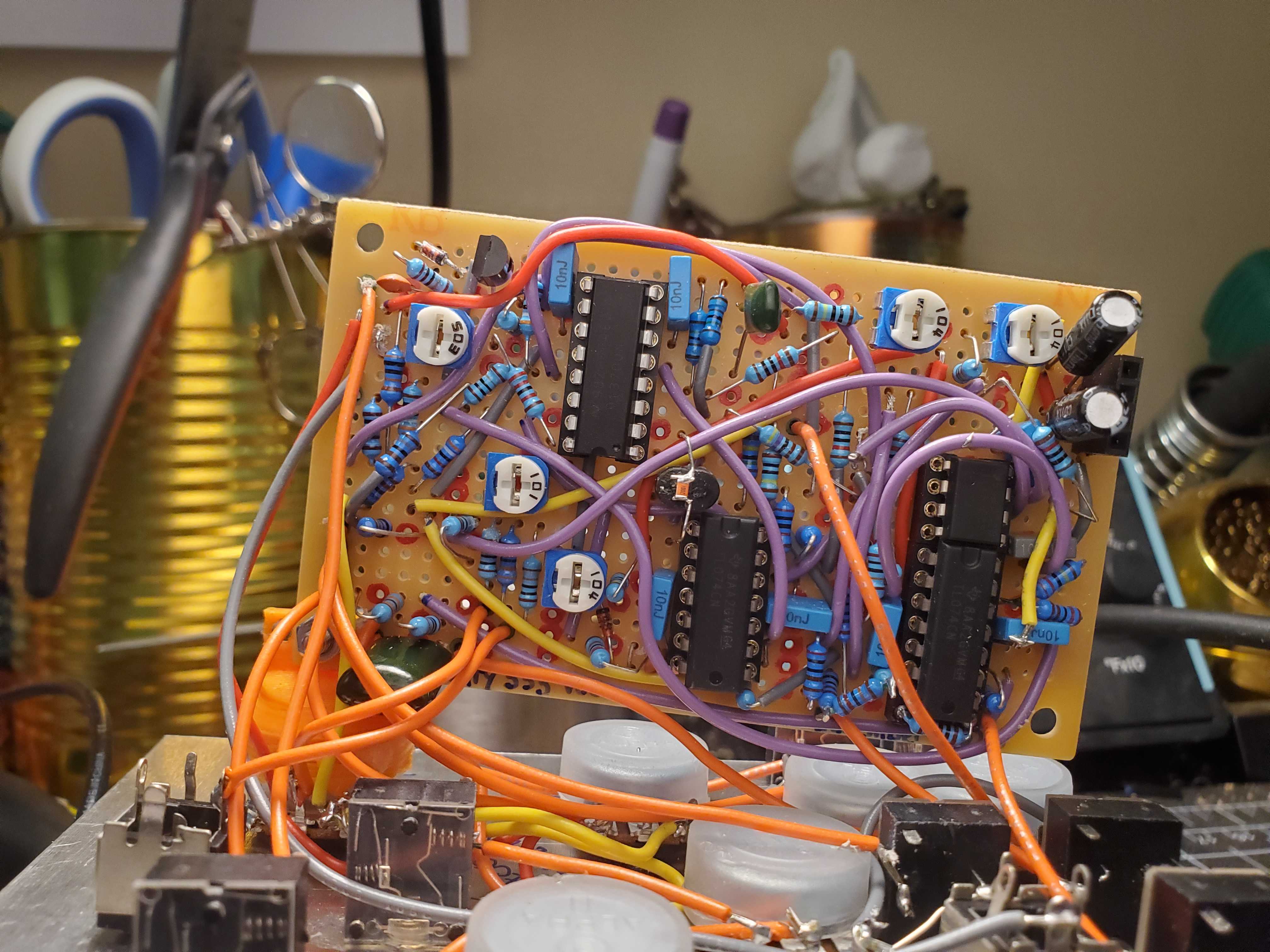

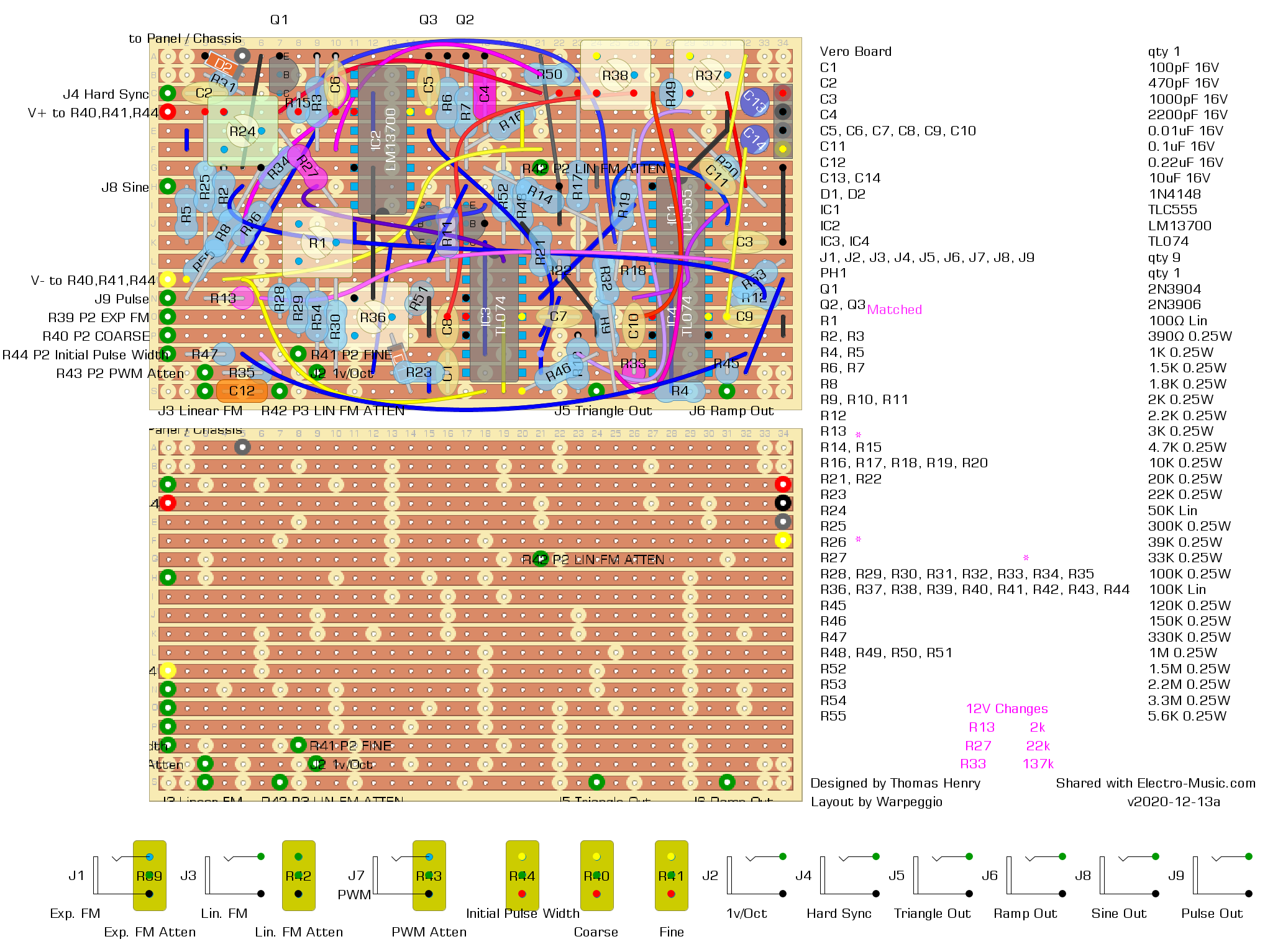

PostPosted: Sun Dec 13, 2020 1:56 pm    Post subject: Reply with quote  Mark this post and the followings unread
Greetings, fellow synth nerds!
I've made a stripboard layout for Thomas' design. I was running low on stripboards in my parts bin, so my goal was to fit the whole shebang onto a single 93x55mm stripboard. I think the result will make some folks bristle, as I've broken some of the usual layout rules. However, i can confirm this layout works, as i've spent the weekend with it on my bench.
When constructing this board, my method was to work from left to right across the board, soldering 2-5 components at a time, which allows me to build up clusters of components relatively easily. The area around R14 and R32 is particularly prone to shorts, among some other areas. When you see that component legs may come together like that, its a good idea to slip some wire insulation over the component leads. You'll see examples of this on my board.
I will admit that i made errors both in the draft layout, and in my construction. Friends, you must stick with troubleshooting to get far in this hobby! My draft was missing 1 jumper wire, and 3 trace cuts on the left side of R36. The trace cut issues nearly overheated IC3. I made a construction error of omitting the jumper that ties the emitters of Q2/Q3 together, which resulted in the circuit having a narrow oscillation range in the supersonic.
Sorting all these issues out, the build tracked 1v/Oct nearly effortlessly. I am getting 5 octaves now with my inaccurate CV source. I will update when i am able to test with a precise CV input.
The BOM shows values for 15V supply as in the original schematic. The values for 12V supply are provided as well. Also, per Fonik's PCB notes, i've used his part numbering for R25, R26, and R55.
Changelog
v2020-12-13a: The colors on the power connector (PH1) on the right side of the board were wrong. This has been corrected.
v2020-12-13: Initial upload

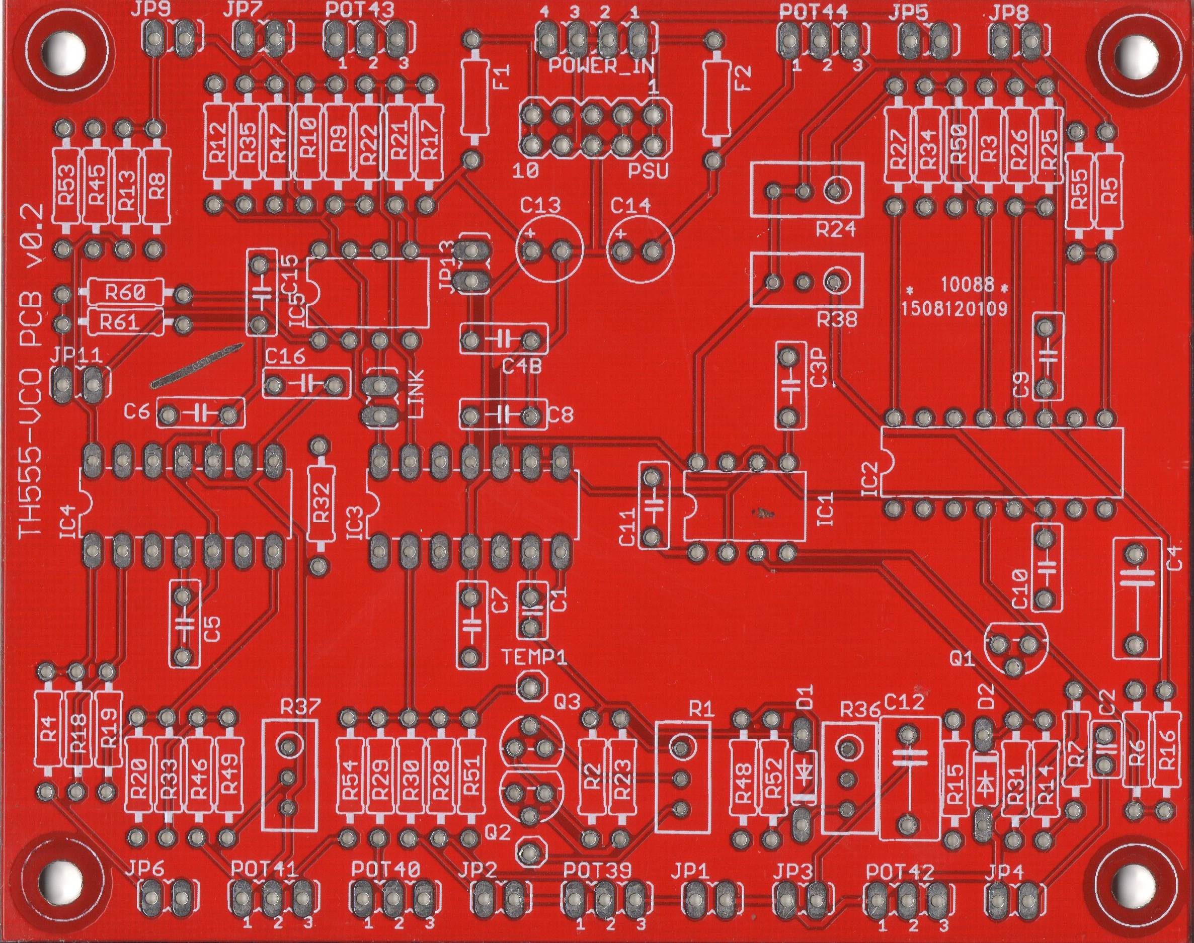

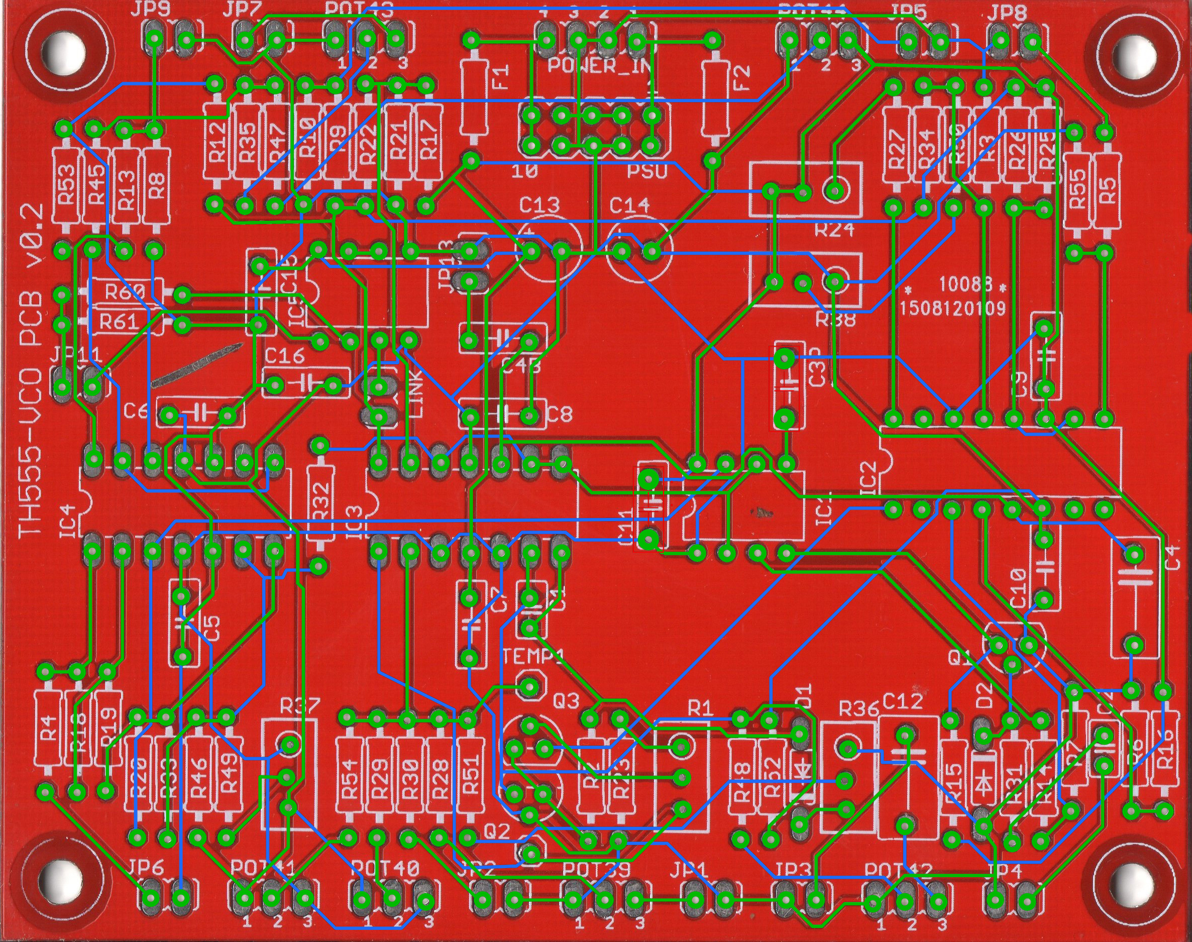

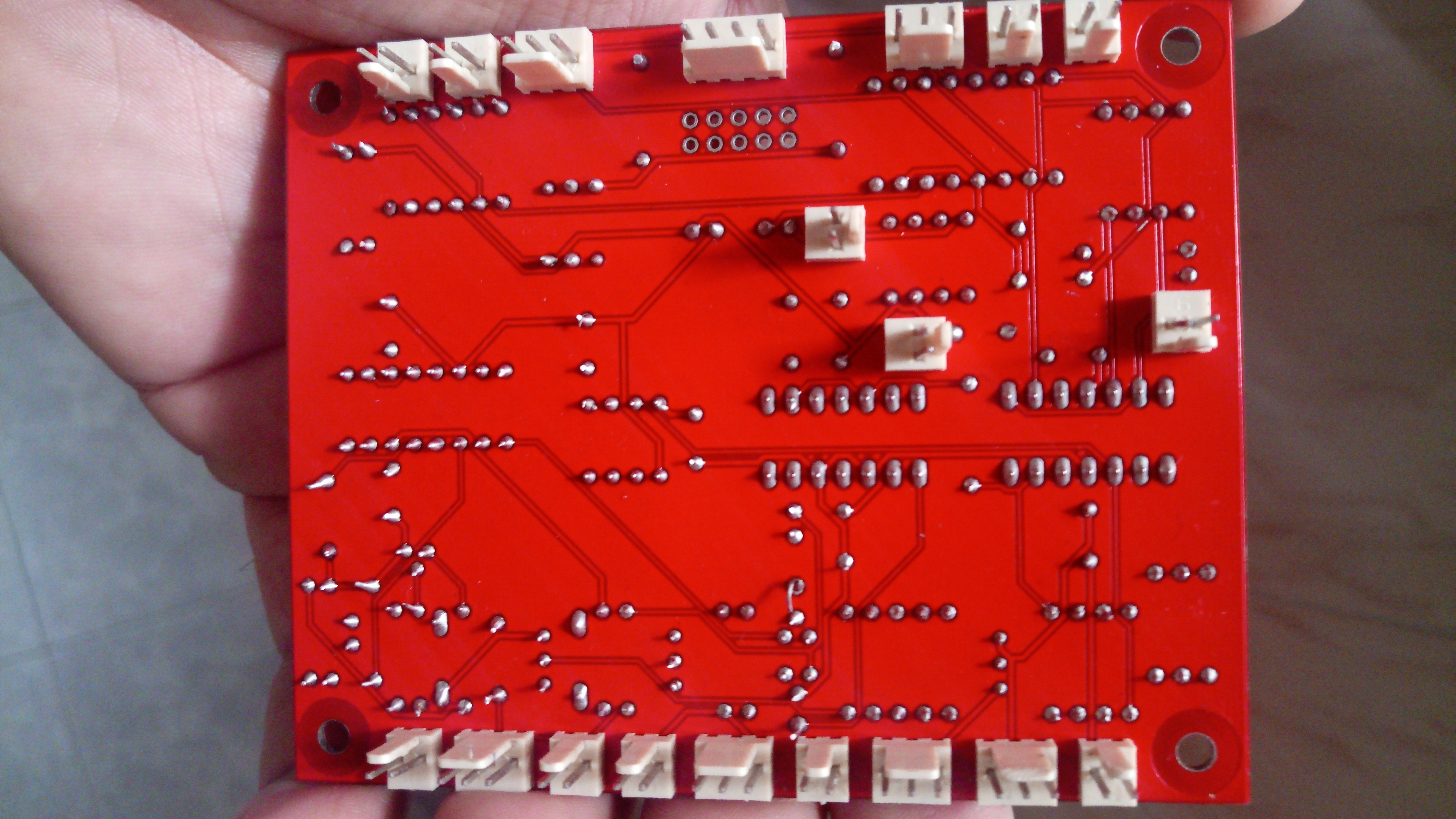

PostPosted: Sun Feb 07, 2021 1:18 pm    Post subject: Tuning issue Reply with quote  Mark this post and the followings unread
I have this board that someone gave me for free. Look very similar to the Fonik one and sound fantastic, all potentiometers work as it should as well as the modulation inputs. Only problem is I can't calibrate because the HF trim R36 doesn't do nothing,maybe the person who designed the board made a mistake, anyway my knowledge is not sufficient to detect the problem.
I show you some images of the plates in case someone can see the problem.
Any help appreciated, thanks!
https://www.youtube.com/watch?v=co-Rp9sCECs
 Filesize:  2.79 MB
 Viewed:  252 Time(s)
 Filesize:  3.72 MB
 Viewed:  242 Time(s)
 Filesize:  4.31 MB
 Viewed:  247 Time(s)
PostPosted: Sun Feb 07, 2021 2:03 pm    Post subject: Reply with quote  Mark this post and the followings unread
Did you mirror your bottom-side scan around with software? Normally there's no way to scan it so that the holes on one side line up directly with the holes on the other, but that's what it looks like to me.
So the circled leg of R36 is supposed to be ground, it ties to D2 where D2 is also supposed to be ground. I would verify the continuity between those two points, that your solder joint there was good, and that both points show continuity to ground. That would be the most likely cause for a problem.
If that all seems correct, next thing would be to measure the cathode of D1 when things are powered on and verify that you're seeing control voltage there, that tracks the linear FM input with the pot all the way up. Then measure the wiper of the trimmer and make sure that it's changing when you turn the trimmer. It is possible that the trimmer is defective if your solder joints are solid and it doesn't do anything.

PostPosted: Sun Feb 07, 2021 2:16 pm    Post subject: Reply with quote  Mark this post and the followings unread
It looks to me as if R2 and R23 should be swapped around. At least according to the original schematic, R2 should go to ground and the trimmer R1, but it's going out to D1 and IC3-pin7 - as R23 should.
Thus in that pcb, R2 should be 22 kOhm while R23 should be 390 Ohm. Does this match up with how it's been put together?

PostPosted: Sun Feb 07, 2021 2:48 pm    Post subject: Reply with quote  Mark this post and the followings unread
Hello elmegil, thnaks for your answer. I scan the board with a desktop scanner and mirrored with photoshop, then I followed the tracks and drew them with a Sprint Layout software so the image of the third photo is the same as the board.
Verified continuity between circled leg of R36, diode and ground, I tried various trimmers, this timmer seen don't do nothing, no changes in pitch or voltage when turn it. I thing the PCB has a routing error but i don't have enough knowledge to compare schematic and board Sad
