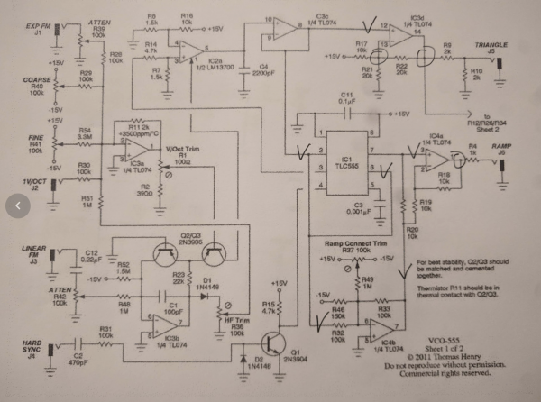

Just an update: my nudge issue turns up in KHz range, it isn't visible in lower frequencies. Also, the square and ramp is pretty slow rising/falling in the kHz range but looks ok in lower frequencies. More oscilloscope pics:

Ok, found one thing. The pulse is the one thing that looks the worst, its slow rising and falling. Noticed with the scope that that the output from 4D (pin14) peaks at 14V with a 12V supply…(!?)
So I'm thinking that's that's some kind of surge happening which might effect the other outputs through the "triangle core". Then I remembered - I was out of really high valued resistors and took a 1.5M instead of 2.2M for the feedback on the comparator for the pulse output, R53. Could this be the issue?
I guess that feedback resistor if for a bit of hysterisis? Maybe I'm better of just cutting it for now 'til I can stock up 2.2M resistors again?
* Tried that, didn't help.
* Tried beefing power rails with external wires.
* Tried beefing up with extra 104 caps on suspected IC's.
* Tried changing same IC's
* Tried beefing up electrolytcs power caps to 200 uF
Nothing of these changes helped and the oscilloscope pictures wasn't even effected so it really has to be something else that just power I think.
The pulse is starting to become a triangle already at 4kHz so it's something weird I've done here…
https://photos.app.goo.gl/amJB5CXoEDz4eyyy1

the pulse Looks like the comparator doesn't work in the expected range... the treshold seems to be too high, so that it looks like a pyramid with a flat top (which is the Point where the comparator has switched)...
If you don't have a 2M2 at hand try reducing R12 from 2K2 to 2K or 1K8 first to see if your comparator works...
As you say your Pulse is getting a triangle at 4KHz then i guess in the lower ranger it is okay or does it only look a Little bit more like a square?
Also does the Amplitude of the triangle Change when in low and then turning to higher frequencies? Does the Amplitude go down?
What kind of 555 timer you're using in the circuit?
Can you look what the triangle looks at pin8 of IC3c? I don't have much insight how the 555 and the OTA interact but to me it Looks like either the reset voltage for the timer on pin 2 or the Output of the timer (pin3) fed to the OTA to load the cap is out of range.
Maybe check all the resistor values connected to the OTA if they are as per schematic... especially i would have a look at the both 1k5 resistors... don't know if when running this on 12V those values shoudl be a bit higher like 1K8 or something... or simply the 4k7 R14 should be 4K3 or 3K9 for example... This can maybe answered by someone who has some more Knowledge and Know-how as i have..
The threshold on 4D pin 13 I can pull from -4V to +4.4 V with the pulse witdh modulation which seems about right? I mean, I should just be able to set it at 0V and get 50% duty on the pulse.
At this point I have actually disengaged the feedback resistor alltogether. That, I guess could cause some fluctuations/jitter when changing state, but that's not the problem I have here.
It's a triangle that's offset positively a lot. See picture:
https://photos.app.goo.gl/No6rQNsGLUReGTqf1
(yellow one)

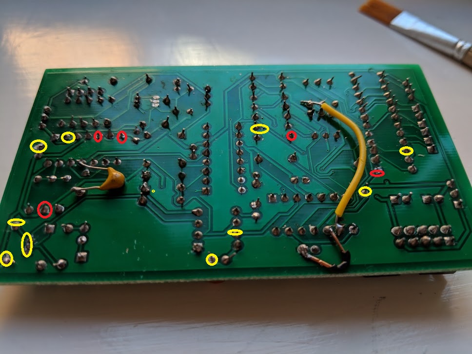

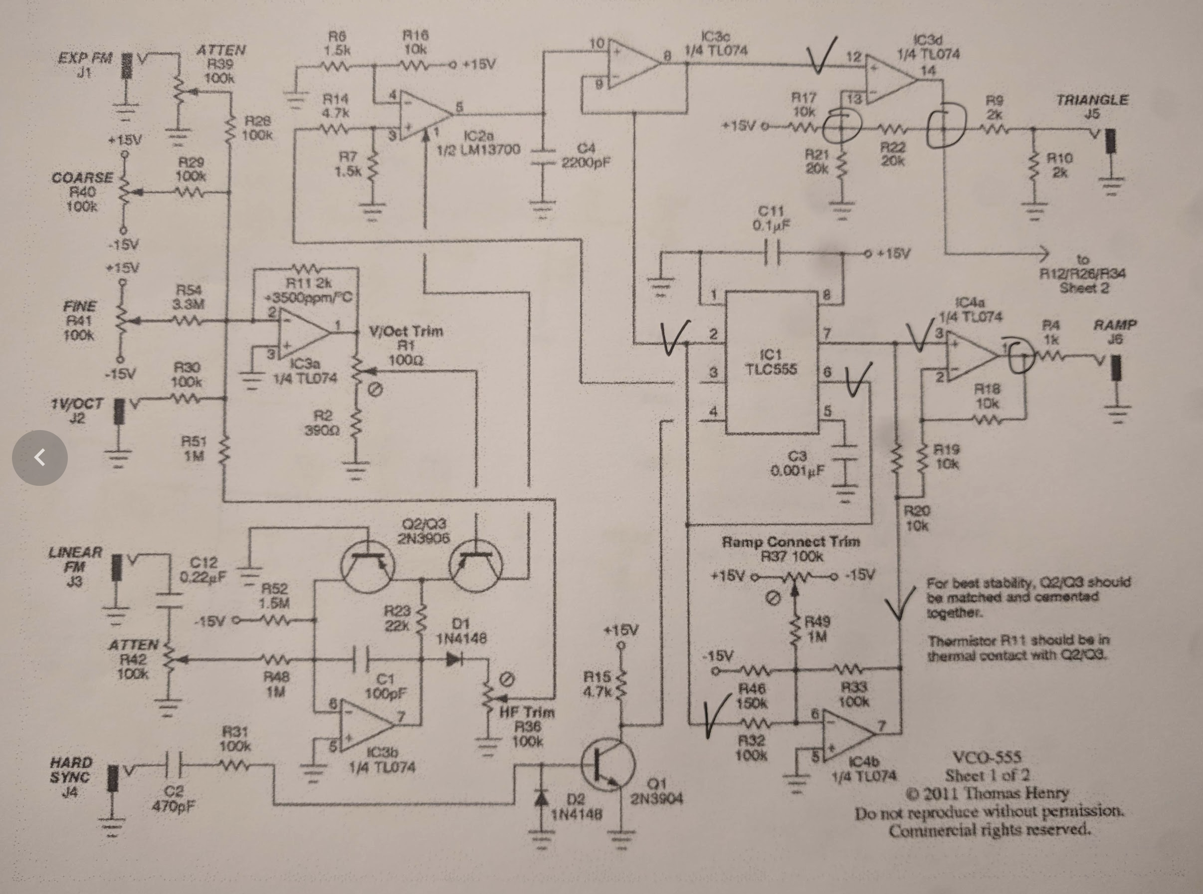

Ok, so now I have systematically just marked on the schematic where I have the nudges and where I don't, and turns out I have it on what I would consider different places not connected by anything but signals that _doesn't_ have it. I've marked with rings where the nudge is present and where with ticks where it isn't. As you can see, it's present on both the triangle and ramp outputs but not any shared connection between the two. Other than power rails that is…
https://photos.app.goo.gl/RYWvpgKMGVF9e4rX6
I feel this really has to mean there's some kind of power surge thing. I've replaced IC3 and IC4 many times so not them.
Also before disconnecting the pulse out, I measured it again and it really did peak at something like +14V. That gotta mean it's draining from a cap somewhere or what does it mean?
How does this work - a comparator that just goes max high or low, I've just thought that would be something a little less than the power rails, but in my case it actually peaks at more… Anyway, that's a sidetrack 'cos the pulse output isn't even connected now and I still have that dint.

On the nudge issue: well, actually I have been feeling maybe I'm a little bit of a princess on a pea there. It's a pretty small nudge that gets visible from maybe around 2kHz and more and more visible the further up I go. But I actually haven't even listened to the VCO yet, just used a scope Smile
However, the second problem is that ramp and pulse are pretty slow rising at these frequencies too. I mean, here's the pulse again at 4.4kHz:
https://photos.app.goo.gl/TeQ6c6xnCEVhP1CH2
Rise/fall time seems pretty constant so at 9kHz the pulse does become a triangle.
Ramp isn't as bad, but still this can't be right can it?
https://photos.app.goo.gl/CjwWi30waHFfuVvj1
No, definitely not. Slew rate of TL07X should be 10V/uS and this is something like factor 50 from that at least. The square slew is waay more than that: https://photos.google.com/photo/AF1QipMQBFeboNE66KXS4dfbymDXrqAg6pgpew-5e0d0
There must be some short to some cap somewhere right? Or something something. This is killing me!

Perhaps also post some pics of your VCO from both sides of the PCB, maybe someone can spot something we didn't discovered yet.
hedefalk
Joined: Aug 29, 2017
Posts: 51
Location: Stockholm, Sweden
PostPosted: Thu Jun 07, 2018 7:17 am    Post subject: Reply with quote  Mark this post and the followings unread
Hehe, I was a bit reluctant since this really isn't my proudest piece of output, but here it goes:
https://photos.app.goo.gl/yFzUq0QtT2W3MguD2
I think this was the first PCB I made as part of learning KiCad. I also wanted to home etch it at first so really tried hard to minimize no of vias, but somewhere in the middle said fuck it and when with jlcpcb. So there are very weird placement/routing choices I guess.
Also made the following errors already at schematic:
* mirrored one of the expo transistors
* mirrored an opamp in the pulse output
* made one too few bypass caps which I for some reason didn't even notice on the layout later
These errors are patched though:
* Resoldered Q 180 degrees
* cut a trace and added wires for the opamp
* added bypass cap on back side
Aaand also soldering is pretty bad, I think I had a really worn out tip and I never cleaned out the flux, but I haven't found any bad connection or short and I did reflow a few suspicious places. I don't think mentioned schematic errors are to blame, I think all the fixes are solid. The cables and bypass caps are _not_ shorting anything, promise Smile

there are some suspicious Looking solder Points... if i'm not totally wrong from the first glance i would say there could be the culprit among them…
Also i would clean the flux, flux can cause several problems, especially when it's between the traces and can cause capacitances or other things...
Also what Solder do you use, is this lead free??? I only use SN60PB39CU1 solder wire, that flows best, unless it's not healthy if you inhale this too much… (reason to Keep a nice airflow over your workplace or wear a small mask over nose and mouth (which for doesn'T work out for me as it's really uncomfortable))…
Would be my first tip to get some better solder wire and perhaps check the temperature youu're soldering with… not too hot and not too Cold...

still think there are some suspect spots, either the Resolution is a bit too low or i'm just too much nit-picking… Smile
do you use a magnifier? i Always have one at Hand when inspecting my PCB's after soldering… sometimes pretty useful as i have often spotted small Errors i haven't noticed with my bare eyes…
some of the point's i've noticed i have marked red and yellow… These are either suspicious Looking Points or where i think flux is not properly removed and also at one Point perhaps a small solder Bridge (not sure, wasn't easy to see without Holding the PCB in my Hands)

Since the signal path of the triangle and ramp aren't really connected through anything but through the 555 which doesn't expose this problem I'm really thinking this is crossover distortion in the output opamps.
I've been really trying to triple check everything related to those and I'm trying to understand what possible errors in say resistor values that would make such a problem worse. That video I linked seemed to suggest adding a constant load towards the negative rail to make one of the output transistors of the opamp always source current. But that setup was for single power rail and I'm not sure how to apply it in this circuit.
I figured that the whole setup of R10 as well as R17, R21 and R22 would be related to this, but I've triple checked all values and measures them so I really think my circuit is as the original schematic.
Sorry for the noobness here, but I'm really not sure if this notch possibly is considered normal or way off. I guess it's not terrible on the "sound" really, but still annoying.
