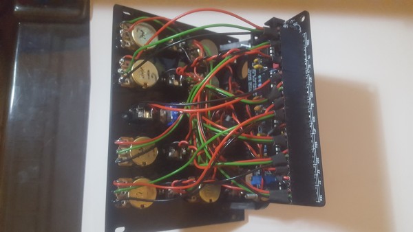

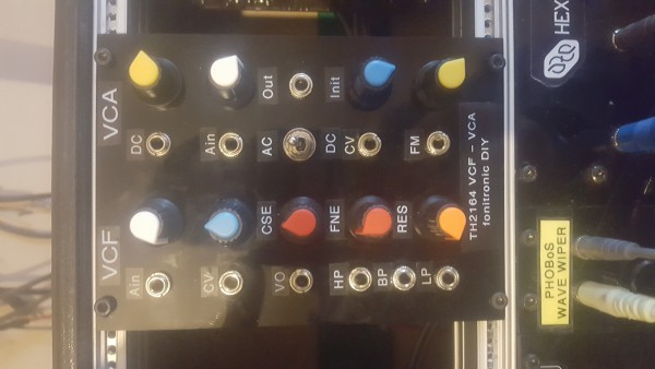

PostPosted: Tue Dec 20, 2016 10:18 am    Post subject: Some pics of my build Reply with quote  Mark this post and the followings unread
 Filesize:  4.3 MB
 Viewed:  616 Time(s)
 Filesize:  4.15 MB
 Viewed:  614 Time(s)
PostPosted: Tue Dec 20, 2016 10:39 am    Post subject: Reply with quote  Mark this post and the followings unread
Classic manual wiring and DIY panel. That's the right spirit!
