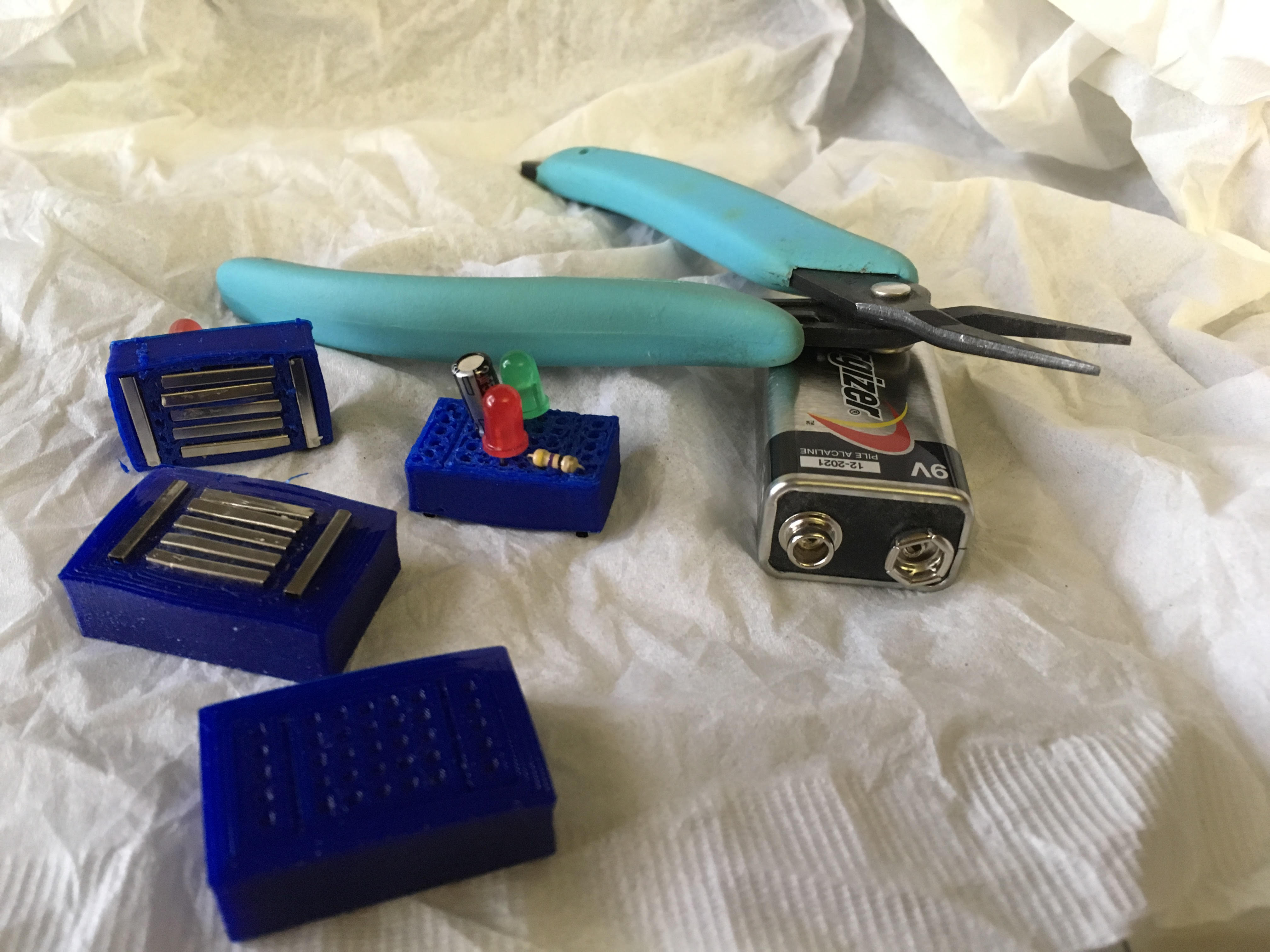

Check out the attached photo for a glimpse of the first four breadboards in a new series of custom breadboards. These are tiny in size, just a 5x5 array surrounded by a pair of 1x5 power busses (on either side). They are cool because it is rare to find two things: such a small size and power busses on a very small design.
The goal here is to continue my ongoing theme of customized circuit construction techniques, in this case the technique is the venerable breadboard with a new twist. I have released designs on thingiverse.com since about 2014 or so, revisiting the topic occasionally over the years.
At the moment I'm ordering parts and planning to construct a transistor-level set of designs that work by shining light at others of their kind. Right now I'm stuck with finding a way to power the boards. It looks like a 9V snap with3D printed battery holder is going to become the solution.
As usual I look forward to reading your thoughts - please do take a moment to reply!

Very cool! I like that idea. How did you make the buses? Are they printed too?

Hi Cyno, great to hear from you.
All of the electrical connections are recycled from an old breadboard. They are 5x1 positions of 0.1 inch spaced "grabbers" that provide the physical and electrical behavior of the breadboard's interior mechanism.
It would be best to find a supplier or find a way to make these grabbers however for prototyping and test purposes recycling is a good approach.
The power busses are just additional 5x1 grabbers that are oriented differently. The power busses can be made longer via soldering. Also the breadboard ties have the same ability, so we can have breadboards that are 10x1 in size on either side of a chip, multiple columns, or just big patches of conductors. Neat huh?
