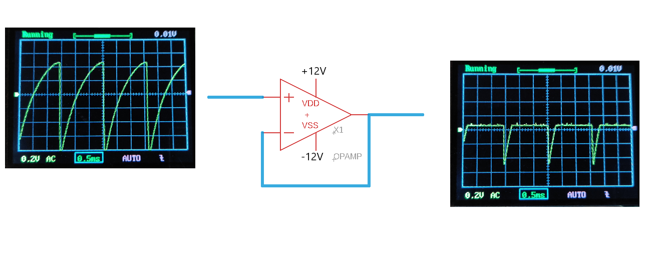

Hey,
I'm was building a buffered multi and noticed something strange on the outputs, so I went and breadboarded the simplest non-inverting buffer schematic, and look what I get... I'm at a loss here...I used tl072 and tl074 and both give the same output...
what am I doing wrong? is this because I buy the cheapest opamps on ebay? Confused

It looks like the positive portion of the signal is being clipped just above zero volts. Measure Vss and Vdd at the opamp power pins. It's possible that a bad connection prevents the full positive voltage from entering the opamp. I'm assuming that this circuit is driving nothing. If it's driving some circuit, disconnect the load and measure the waveform again.
I can't say that it won't or doesn't or can't happen, but a bad opamp is probably not the problem. If you have known good opamps, try one of those to be sure.

Hey, yeah the circuit is not driving anything, but that doesn't seem to affect it anyway..
will measure power input, and buy some chips at the local shop to compare.
thx
That’s hard to tell because the scope is set at ac, so the voltage could be positive, negative or around 0volt.

I agree that there's no way to guarantee that the OP set zero on the scope properly, however it is standard practice for some of us. There is most definitely clipping going on there. One of the simplest ways to account for clipping in this extremely simple circuit is for a supply line to be severely degraded with resistance or disconnect. It was only this intuition that caused me to suggest what I did. And I did not rule out a bad opamp, a blown output driver transistor could cause this as well.

hey,
think I found the problem. setting the scope to DC showed me the OSC was oscilating at around 12V... hence the clipping...
thanks for helping look in the right direction! Wink
