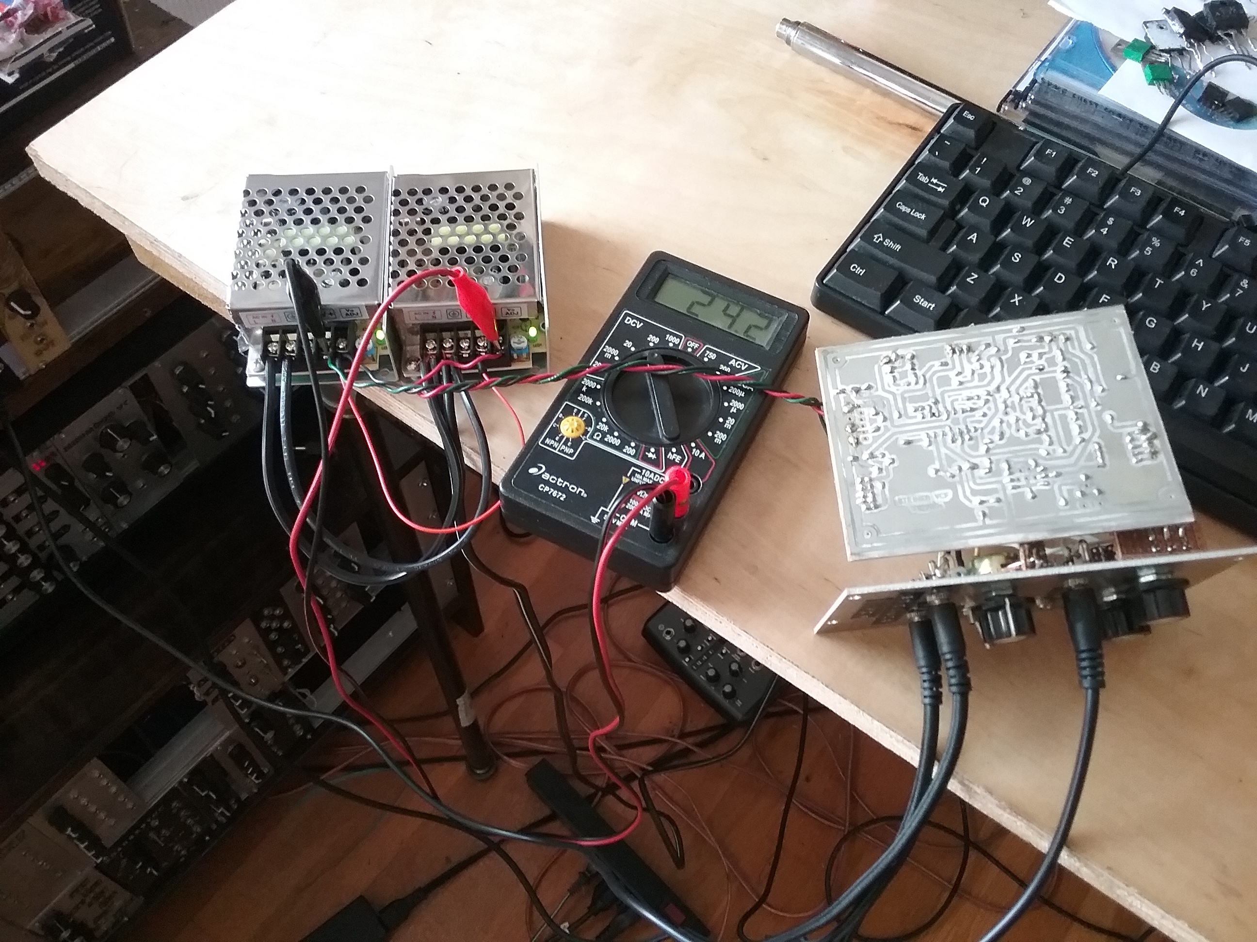

A while ago I was looking at euro cases and noticed that some brands had what looked like two switching power supplies in them hooked up in series to create a bipolar power supply. I had seen those cheap Chinese SMPS intended for LED strips on eBay, but of course they're single rail.
I did a little research on whether or not it was feasible to hook up two SMPS in series, and read a lot of opinions saying everything would blow up, and a lot of opinions saying everything would be fine.
Anyway, I decided to do an experiment, and bought two small 3A LED power supplies, for less than $5 a piece, and hooked them up in series. I've had them under a small load, (a Yusynth Steiner filter,) for about an hour and everything seems fine. The voltage is nice and stable. The sound is fine and doesn't seem to be effected by the switching, (which is to be expected because it's well above audio range,) and the power supplies are nice and cool.
Figured I'd share because less than $10 for 3A of stable power is not a bad deal. I really wasn't sure it would work, and hadn't read any posts about anyone doing this before. As much as I love linear power supplies, switching supplies would be a cheaper alternative, especially when you factor in available amperage for larger cabinets.
I haven't put them under any significant load yet, (worried about damaging modules,) but I might hook up some DC motors later and let them run, monitoring the voltage output and whether or not the power supplies continue to seem healthy.
If you're curious about sound quality, I've attached a sample of a Wogglebug going into the Steiner filter, with the cutoff being modulated by a Sloth Chaos, then going into my computer with a little reverb, flanging, and EQ added.
Also, if one were really concerned about ripple, they could buy 15V supplies, put some beefy caps after the supplies, and then parallel some LM7x12 regulators to handle a few amps of current.

You mean in series and not parallel, right? Wink
There's a thread over at Muffs regarding switched PSU's... From what i remember some DIY Shops do offer some of them. Those are as i remember correctly PSU's with two separate outputs.

Ha, yeah, series. I should correct that.
I've looked in to dual rail switching supplies, (Meanwell makes a few as I remember,) but with the added cost it didn't seem worth it compared to a standard linear supply, which is why I tried this.
Posts: 5881
PostPosted: Thu Aug 31, 2017 1:04 pm    Post subject: Reply with quote  Mark this post and the followings unread
I assume you mean the input (mains) in parallel and he outputs in series. It can work as long as the V- output of
the supplies isn't directly connected to the chassis/earth. I measured on a similar supply and that does indeed not
seem to be the case.
edit: ah you posted just before me

PostPosted: Thu Aug 31, 2017 1:11 pm    Post subject: Reply with quote  Mark this post and the followings unread
Yeah, before I hooked it all up I made sure the earth and negative output were isolated, which they are, and which I should have probably noted for anyone else wanting to try this. And yes, mains in parallel, output in series.

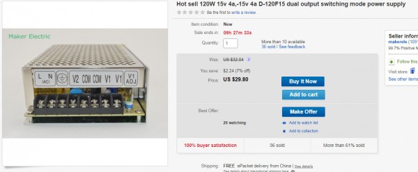

Actually, I may have spoke too soon regarding bipolar SMPS being significantly more expensive. There don't seem to be a lot of +/- 12V options out there, but +/- 15V is easy enough to find, which allows plenty of headroom for filtering and linear regulating, so that's probably actually better. And, the price difference is negligible. ($30 for 4 amps doesn't seem so bad. Could probably run 4 or 5 rows of 84HP off that.)

PostPosted: Thu Aug 31, 2017 2:39 pm    Post subject: Reply with quote  Mark this post and the followings unread
it's a nice compact solution, but I was looking at some specs and would indeed advice to add some regulators
as the ripple voltage seems to vary somewhere between 75mVpp and 150mVpp. But for eurorack the +/-15V
would do fine with some 12V regulators and you can add them per row to spread the dissipation. Not sure if
everything works the same at those high switching frequencies though.

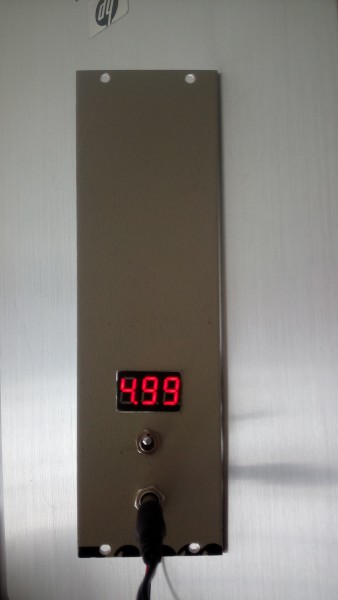

https://www.aliexpress.com/item/Mini-Digital-Voltmeter-Voltage-Tester-Meter-0-28-Inch-2-5V-30V-LED-Screen-Electronic-Parts/32854836483.html
Cool

I think I'd find an ammeter more useful. after all the voltage is constant unless there is something major wrong.
https://www.aliexpress.com/item/Mini-Digital-Voltmeter-Ammeter-DC-100V-10A-Voltmeter-Current-Meter-Tester-Blue-Red-Dual-LED-Display/32947073204.html
Posts: 5881
PostPosted: Sat Jan 19, 2019 6:26 pm    Post subject: Reply with quote  Mark this post and the followings unread
Being able to see the current draw or in this case even better both voltage and current is great. But I wonder if it could affect the
voltage since you need to place it in series* with the power supply. Just voltage is useful too though, if it starts to drop you know
the current requirements are higher than what the supply can handle. It might not drop a lot but it is definitely measurable.
* unless it uses induction to measure the current.

I use those voltmeters on each rail; on lights with an additional safety feature.
If there's a fault, accuracy is not the issue, immediacy is.
For Grumble's application I like these
https://cpc.farnell.com/webapp/wcs/stores/servlet/ProductDisplay?urlRequestType=Base&catalogId=10001&langId=69&storeId=10180&partNumber=PM11273
I found a 270k from input to positive and negative to ground, gave a nice +/-15V swing.

halfshavedyaks wrote:
I saw a spec for the ammeters resistance somewhere once IIRC it was less than 100milliohms.
I was more thinking about possible high frequency noise as they are digital or maybe problems if something goes wrong with them.
Not really something to worry about it though. I actually looked at those meters when I was making my own supply but they were
too large to fit on the panel so I settled for some small digital volt meters.
I agree that accuracy isn't that important it just has to indicate if there is a drop in the supply voltage.
