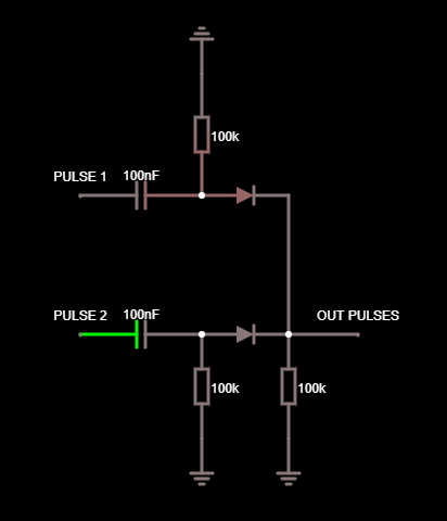

Posts: 1318
PostPosted: Wed Jan 09, 2019 8:34 am    Post subject: Reply with quote  Mark this post and the followings unread
You could try this, but probably have to tinker a bit with the values of the c's and R's
 Filesize:  7.09 KB
 Viewed:  7225 Time(s)

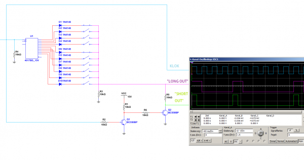

The most common way to do this is to connect the output(s) of the 4017 and the CLK signal to an AND gate. I have noticed this can cause
some unwantend triggers so have a look at the "Little Gate" sequencer as I used some extra components to solve that problem.

PostPosted: Wed Jan 09, 2019 9:52 am    Post subject: Reply with quote  Mark this post and the followings unread
something from the simulator
the simulator needed R3 to work properly, dunno if it could be ommited in the real world, i would say it depends on the following stage
edit: Senhor Grumble, you are still using this falstadt thing! Very Happy
 Filesize:  64.35 KB
 Viewed:  510 Time(s)
