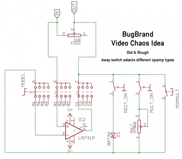

PostPosted: Mon Jan 21, 2019 2:33 am    Post subject: Reply with quote  Mark this post and the followings unread
Someone emailed me to ask about the circuit I mentioned, so I'm going to share what little info I have... I did this back pre-2010 I think and had zero idea about video signals so the approach is shonky as anything! But the results (with, I think, a Time Base Corrector) were interesting - the box was used by a video guy for Portishead live visuals. The only documentation I have is a schematic I drew a month or two later. I used various different opamps with the same pinouts & had a switch to select different ones.
Looking at the schematic today, I'm not really sure why it works - it is clearly f***y as anything! But that's roughly what I did, so sharing it if anyone wants to try it out.
Nice to see, 10 years down the line, just how far LZX Video works have come!

jondent
Joined: Oct 04, 2013
Posts: 8
Location: Australia
PostPosted: Sat Jan 26, 2019 1:17 am    Post subject: Reply with quote  Mark this post and the followings unread
It's great to see these old circuits again.
and how far video synths have developed over the last decade
