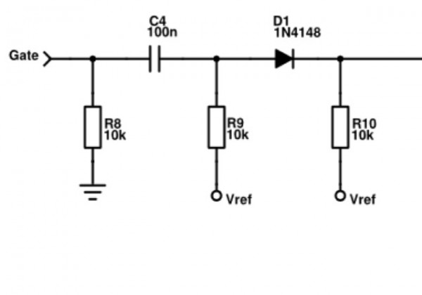

Hi there,
I have a question about Ken Stone's gate to trigger converter, although this might be applicable to a wider range of circuits.
When I measure the voltage out of the trigger that is produced, it reads around 7.5v, but when I connect it to any of the twin t drum circuits I have tried out with it, the voltage level at the output drops a lot. I've tried putting a 1n4148 diode at the output as well as a 10-20k resistor to ground. With the diode its a little better, but still only reading 3v. I can tell its not hitting anywhere near 7v just by ear- when i connect my dr-110 which is supposed to output 5v trigger, the drum circuit smacks much harder.
I was having a similar problem with an LFO I made based on the edp wasp lfo circuit, but putting a diode and a 20k to ground at the output seemed to solve the issue.
I looked at the dr-110 schematic to see whats going on with the trigger output there and it looks like there's a bit of circuitry after the initial trigger out is produced but I'm not savvy enough to really be able to tell whats what.
I know this is probably basic beginner stuff, but I'm struggling to find much information about this on the web.
Any ideas about whats going on here with the drop in voltage when the trigger is connected? is this normal? suggestions? any response would be really appreciated!

How are you measuring the voltage ? Since it works with a comparator the output should either be 0V or something close to the supply voltage.
Unless the inputs of your drum circuits form a voltage divider with the 1K resistor on the ouput. Maybe the pulse is too short for your application.

I'm measuring with the voltmeter on the breadboard. It reads out 7.5v when the trigger hits, but as soon as I connect the trigger to the drum circuit it goes down to 3v read-out. I've tried it with a number of circuits all using similar input circuitry. Here's the input circuit of the one I have on the breadboard now. would this form a voltage divider?

With that input circuit there shouldn't really be a need for the gate to trigger converter as that is what that circuit does.
But you could try increasing the value of the 10nF cap to see if that makes a difference. Also if you plan to hardwire it you
could leave out the 1K resistors on the output of the gate-to-trigger converter. It does indeed work as a voltage divider but
the voltage should be high enough.

Do you have a voltmeter with a capture mode or is it analog ? Because the pulse is rather short and to get a good look at the level an oscilloscope would be
preferable. I also don't really see anything in the circuit that could cause the level to be so low.

Well I changed the cap in the gate to trigger converter to .1uf and it did make some difference. I also decided I'll run this at 12v whenever I decide to solder it together, so that brought the voltage of the trigger up to 5v according to the multimeter. It is now noticeably fuller although it still doesn't slap quite as hard as when I trigger it from the dr.110. Ok it's not a huge deal:) Just mostly curious. When I have time I'll try to breadboard the 110 trigger out.
As for the voltage reading- I know its def not the most faithful measurement ever. I'm just using a cheap voltcraft multimeter. But it does seem odd to me that it reads 7.5v before connecting to the drum circuit input and then as soon as I connect it, it goes down to 3v. Also, I'd have thought that a diode at the trigger output of the ken stone circuit wouldn't really do anything since there's already one on the trigger input of the twin t, but it does seem to help a little bit somehow.
Speaking of which- my understanding, please correct my if I'm mistaken, was that the diode at the output of a cv source is just there to protect the cv source in case you connect it to anything that's not playing nice. Which in fact I fried 2 4069's by connecting lfo to a cv input of a -5/+5v synth (even if the datasheet of the 4069 says it should be able to handle receiving up to -10v). But adding the diode protection also kept the range of the lfo intact when routing it into other single supply circuits I had on the same breadboard. In that instance I had a cv controlled cross fader circuit, and plugging the lfo output into the cv input without the diode and a 10k to ground changed the range from 0-8v to something like 3.5-6.5v - which regardless of how vaguely inaccurate my measuring tool is , the difference was very much audible in the resulting sound.

Another thing you could try is leave the capacitor out, actually just leave everything out up to the 100K resistor to GND
connected to the opamp. I don't really see why you'd need a gate to trigger converter in the first place and this would
just boost (and shape) the signal.

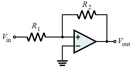

I found that I needed the gate to trigger when using a 4017 as a sequencer. I tried several different variations but wasn't able to get it to trigger reliably unless I made a gate to trigger for each of the individual steps' pulse output ie 10 steps - 10 gate to trigger converters. I seem to understand that people are able to get various twin-t's to trigger without all that circuitry but for whatever reason it's been the only thing that's worked for me.

This is never a problem when a differentiating gate-to-trigger is used. I would suggest a schmitt trigger gate buffer at the output however. That will "square up" the differentiated output signal and give a nice clean trigger at logic levels.
Could a trigger gate buffer be accomplished by just sending the trigger/gate through the input/output of something like a 40106 with a feedback loop, r1 and r2 equal values? Or would I need an op-amp for that?
is it maybe possible that with the trigger gate buffer I wouldn't need to create a separate gate to trigger for each individual pulse output of the 4017?

Because of the schmitt trigger input of the 40106, it would not make a good "linear amplifier". If you want to simply buffer, then an opamp in voltage follower mode (output connected directly to inverting input and input signal applied to non-inverting input) would be best (and no resistors needed).
With a buffer such as 40106, the circuit can drive several inputs, so the buffer would eliminate the need for a gate to trigger circuit for each. Note that a 40106 is an inverter with schmitt trigger inputs. This means that the output will be inverted. You can do one of two things to correct the inversion. Simply add a second 40106 gate, or use an opamp inverting amplifier with a gain on one. (inverting amplifier where feedback R is the same as the input R. I'd probably just use another 40106 gate unless there is a need for an opamp buffer closer to the circuit's input, then I'd use an inverting opamp circuit which creates one inversion and then a single 40106 gate will correct it.
