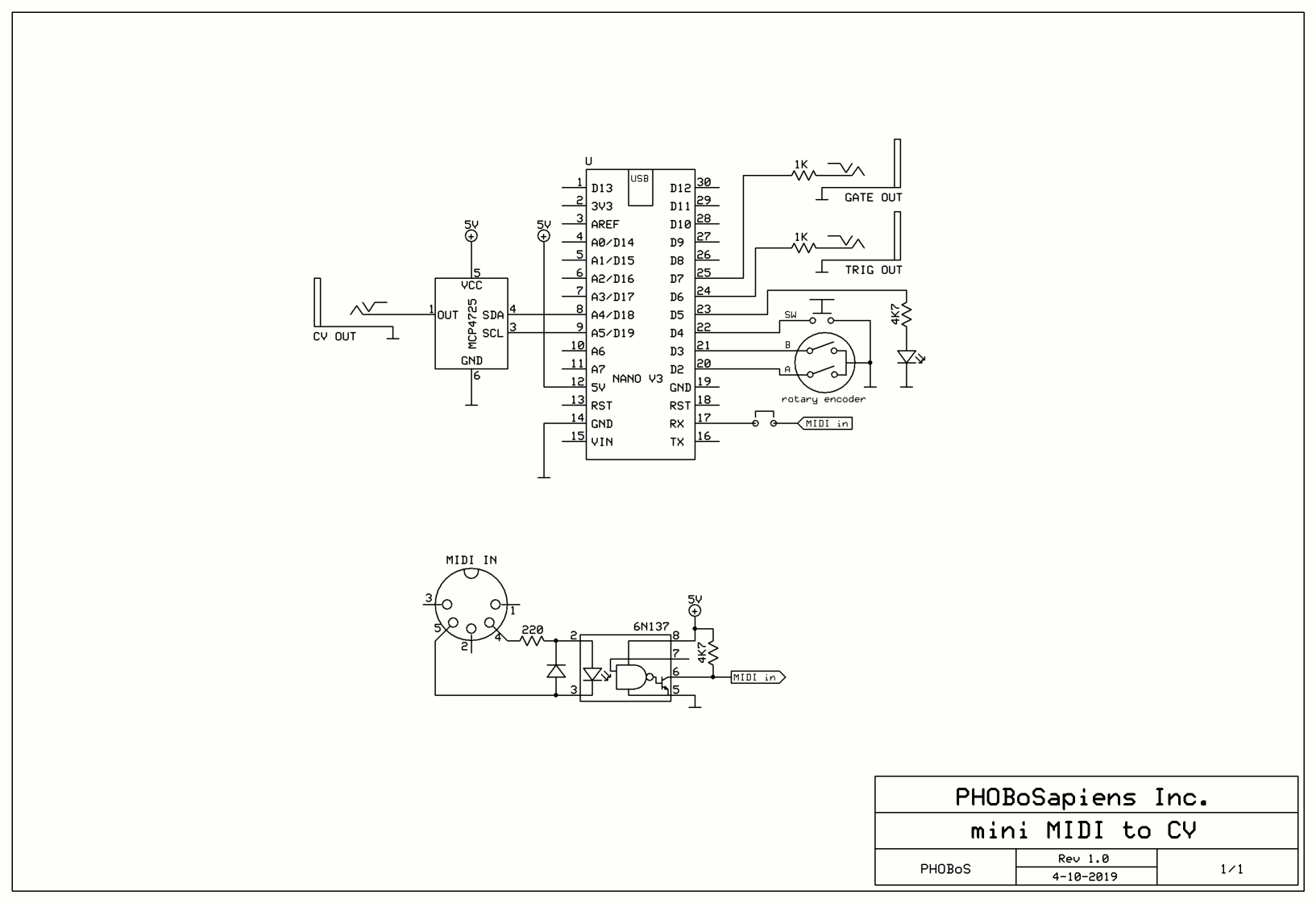

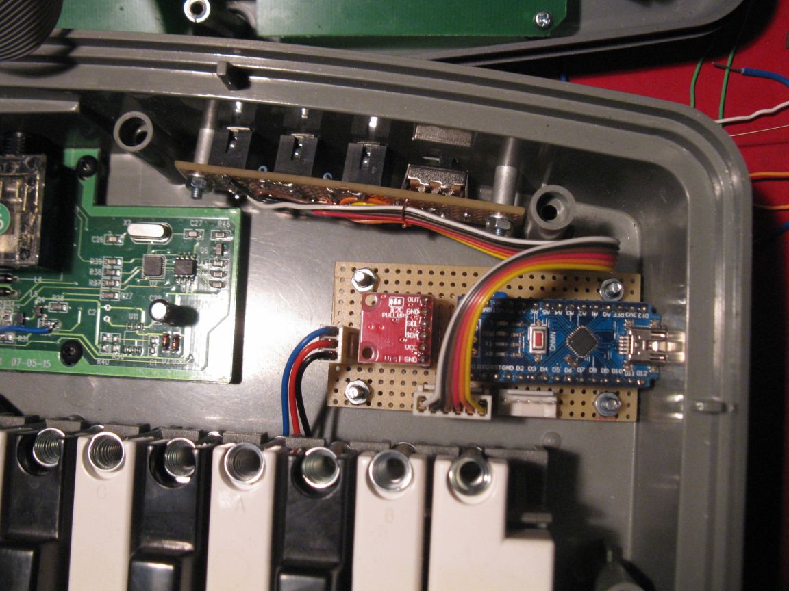

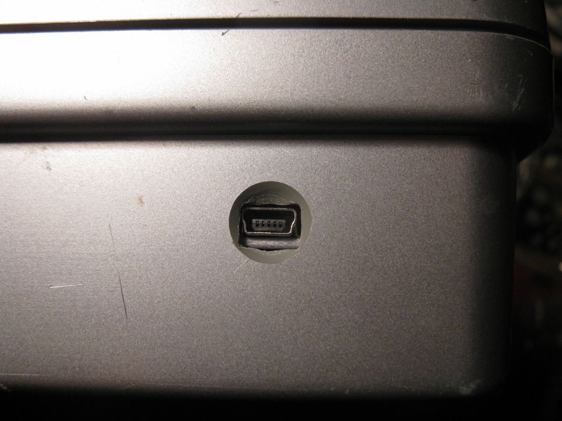

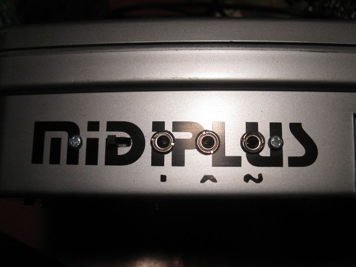

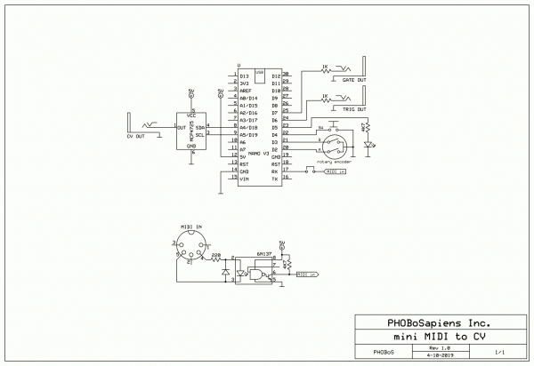

I added a simple MIDI to CV converter to a MIDI keyboard. At the moment it only makes use of NoteOn and NoteOff messages but I might
add Pitch Bend later. The keyboard I used also has some knobs that send out CC messages so maybe I will do something with that too.
I tapped the midi signal of from the keyboard PCB but if you want to use it with a regular MIDI input you can add the circuit with the 6n137
optocoupler. I don't have the right rotary encoder (with a switch) yet so that'll be installed when it arrives. (could take a couple of weeks)
Here's some info, a schematic, the arduino sketch and some photos.

// * DESCRIPTION:                                                                                                                   *
// * This is a very basic MIDI to CV converter originally intended to be added to a MIDI keyboard[*]. It has a 1V/Oct CV output     *
// * with a range of 5 octaves (in semitones) and it will ignore any MIDI notes that are out of this range. The MIDI octave range   *
// * it responds to can be adjusted in the code (low_octave) and can be set between -1 (octaves -1 to 3) and 4 (octaves 4 to 8).    *
// * It can be set higher but then the total range will of course be less than 5 full octaves.                                      *
// * It uses last note priority but doesn't memorize any notes. This means that if you press a key and hold it, then press another  *
// * key the CV will correspond with the last pressed key. But if you release this key it will not return to the CV for the first   *
// * held down key. (the Gate output does however stay on).                                                                         *
// * It also has a Gate output that stays high when at least one note is on and a Trigger output that sends out a short pulse       *
// * whenever a key is pressed (or a new MIDI NoteOn message is received). The length of this trigger pulse can be adjusted in      *
// * the code (trigger_time) but it is not 100% accurate.                                                                           *
// * The first time the arduino is booted it uses preset values to control the DAC. These might work straight away but because      *
// * the DAC uses the supply voltage as a reference and isn't entirely linear it will probably need some calibration.               *
// * There are 2 calibration procedures;                                                                                            *
// * - Quick calibration calculates all the values for the DAC based on 1 setting but is not very accurate.                         *
// * - Note calibration makes it possible to precisely adjust and store the output voltage for each note individually at any        *
// *   given time. (this could also be used for creating non-western tuning scales)                                                 *
// * [*]requires some extra circuitry for an external MIDI connection.                                                              *
(there's some more info in the sketch)

Thanks! Nice simple solution and clear understandable software. Although I have Midi2CV from Erica Synths, I am thinking about my own to make.

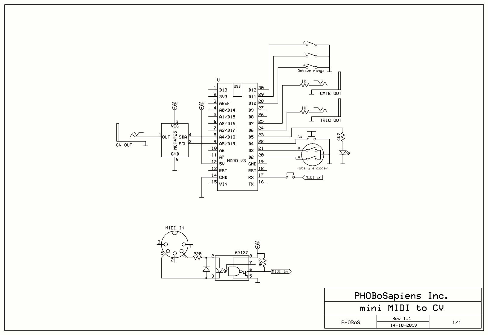

here's version 1.1 with some small changes:
- replaced digitalWrite for Trigger and Gate outputs with direct PORT manipulation (faster).
- moved the encoder debounce from the adjust_dac_value() function to the read_enc() function.
- added inputs for (DIP)switches to set the octave range.
The switches are optional and if left out the default range (set with low_octave) is used.

PostPosted: Tue Oct 15, 2019 4:47 am    Post subject: Reply with quote  Mark this post and the followings unread
Maybe it would be better to separate initial debug sequence with if statement and debug on/off variable (or debug define). Debug is very useful during development and test phases but not needed when code is mature so anyone can set temporary debug preference.
I prefer such approach in my sketches. With if - all debugs are ommited during execution, with define - debugs are not compiled making program smaller (if there are many and complex debugs).

PostPosted: Wed Oct 16, 2019 3:23 am    Post subject: Reply with quote  Mark this post and the followings unread
I am not sure what 'initial debug sequence' you are refering too.
Almost thought I accidentally uploaded a test version.
This one (apart from reading data from eeprom):
Code:
// copy data from the EEPROM to the dac_data[] array and print a list of all the values
  Serial.begin(9600);                   // set the baudrate to 9600kbps for the serial monitor
  Serial.println("values for the DAC stored in EEPROM:");
  for (byte n=0; n<=60; n++) {
    read_dac_data_from_eeprom(n);       // copy the EEPROM value corresponding with note n to the dac_data[] array
    Serial.println(dac_data[n]);        // print value
  Serial.flush();                       // wait untill all the serial data has been send
Posts: 5828
PostPosted: Wed Oct 16, 2019 6:09 am    Post subject: Reply with quote  Mark this post and the followings unread
oh, that's a feature Laughing
I thought it might be usefull if you calibrated it and wanted to save the dac settings for some reason.
I used it myself to paste into the preset array after calibration, and it could be used to save different scales.
You can take it out of the code but I don't really see a downside to it being there.

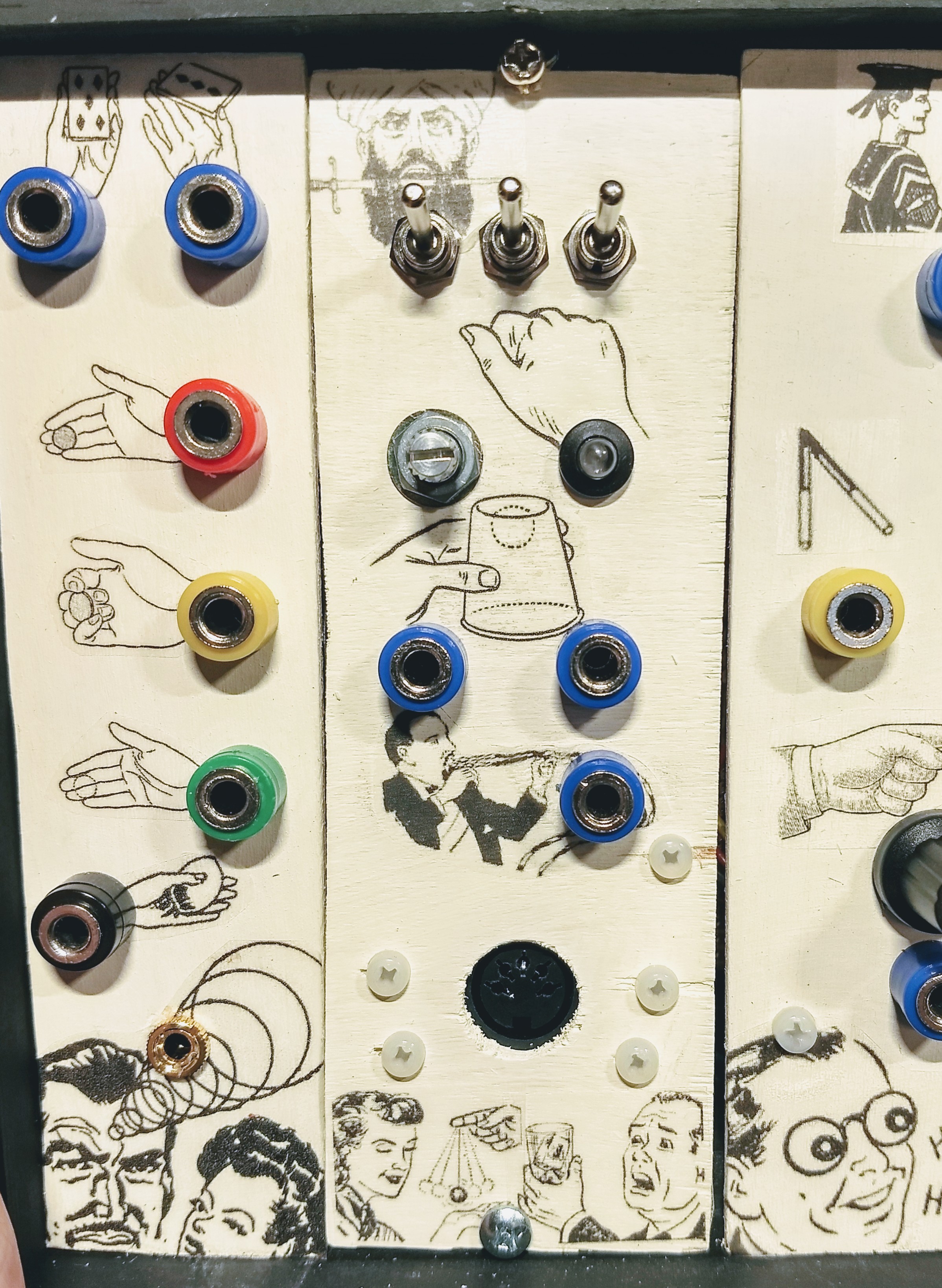

Just wanted to say thanks! Built this the other week and it is working great.
Basically built it up on veroboard and have it behind a plywood panel (it is the middle panel in the pic below).
Thanks again!

awesome! cheers
I like the panel designs, makes me curious what the one on the left is.
I am working on a version with an arpeggiator but haven't implemented the latch function yet. All controls are done through
midi CC so it wouldn't require any extra (or changes in) hardware, besides maybe an input for an external clock input.

The one on the left is a simple passive multiple I use to split CV, and a power input because I set up my power supply as a bench top unit to use both for testing and power for the rack.
The additions sound great. I'll be sure to keep an eye out for them.

welp, i built the single version on breadboard quickly and it works like a charm Smile nice job.
will dig into your code and see if i can play about, maybe get a few mcp4922's running.
does the midi library support polyphony? Very Happy
_Richard_ Smile
Posts: 5828
PostPosted: Tue Jul 14, 2020 10:33 am    Post subject: Reply with quote  Mark this post and the followings unread
great to hear it works! Very Happy
Polyphony would work fine. All the midi library does is make it easier to process the midi signals.
Unless there is some sort of polyphonic midi command I am not aware of.
michelangelo_n
Joined: Sep 14, 2020
Location: Italy
PostPosted: Mon Sep 14, 2020 9:57 am    Post subject: Reply with quote  Mark this post and the followings unread
Hi, this is a nice project! which kind of encoder are you using? does a normal potentiometer do the job? I'm using a B100k pot and measuring the voltage out of the wiper for calibration. but I'm not sure I'm doing it right.
Posts: 5828
PostPosted: Mon Sep 14, 2020 10:40 am    Post subject: Reply with quote  Mark this post and the followings unread
welcome party!
no, a potentiometer doesn't work with this code. A rotary encoder doesn't work by changing resistance but by sending pulses that are
out of phase. you can find some more info about that here: https://howtomechatronics.com/tutorials/arduino/rotary-encoder-works-use-arduino/
The one needed for this project also has a built in momentary switch, though you could use an encoder without a switch and just
add a seperate one. For the rest it is just the most basic encoder that you can find pretty much anywhere.

PHOBoS, I was wondering what it would take to use this device with my USB MIDI keyboard? Could the Nano USB port be configured to either a programming port or a MIDI port?
Posts: 5828
PostPosted: Tue Jan 12, 2021 3:43 pm    Post subject: Reply with quote  Mark this post and the followings unread
not the nano but the arduino pro micro can do midi over USB, that would require some changes in the code of course.
Shouldn't even be that hard, it's just the midi reading section that needs to be replaced to get the midi note data from USB.
There is a USB MIDI library available to make things a lot easier.

Some time ago I stumbled upon a project called HIDUINO (it is still there, just google) where a class-compliant USB-MIDI device from an Arduino UNO or Mega 2560 can be programmed so you need no drivers because it’s native to windows.
Just be sure to get an UNO with an ATMEGA8U2 or ATMEGA16U2.
