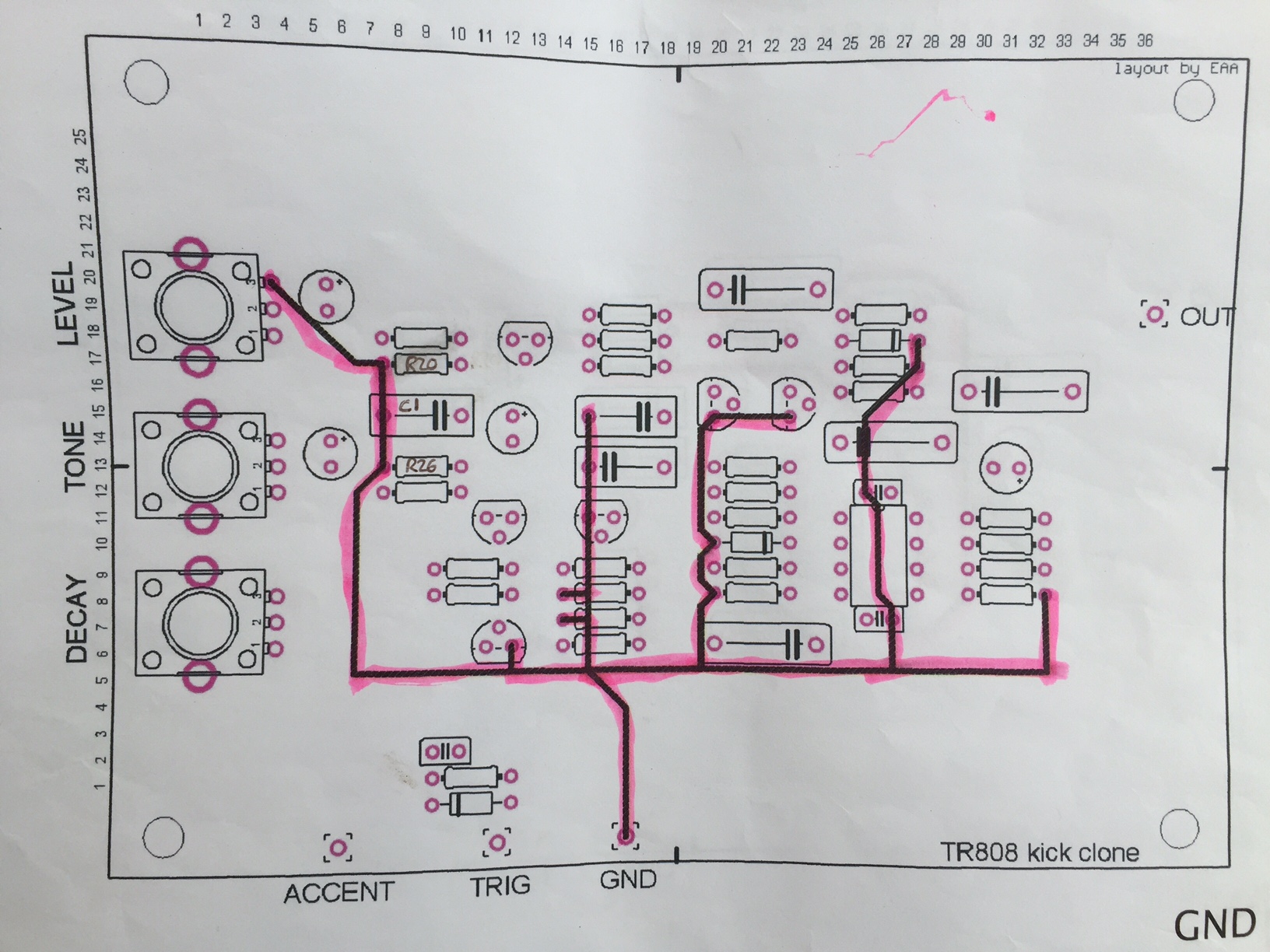

Thanks PHOBoS.
My the output is a little noisy. So I'd like to fix it.
However, I wired according to Eric Archer's layout. See image below...
Any idea why this kills the output when I connect these three components to the ground?

hard to say but something must be wrong if it works otherwise.
Could it be that you used a 220nF capacitor for C1 instead of 220pF ?

I am a complete wally. I had failed to connect C1 to C11. Fixing that problem meant when I connected the 'missing' ground to C1, R20 and R25, it worked perfectly.

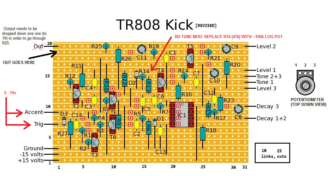

Hey all -- just thought I'd post my own working copy of the layout in case it's helpful to anybody building this. The original layout by Minus underwent a number of changes over the course of this thread (notably a missing cut between R26 and C4 as well as other minor tweaks) which are incorporated here.
The potentiometer diagram was added because I originally wired the pots backward (Wiring the pots as they are numbered in the Eric Archer schematic will result in them being reversed).[/img]

Hi, so is this confirmed with the bom at beginning of this thread? Thanks Ryan

Hi ryan -- yes, it uses the original BOM. No components added, just a missing cut on the board and some tweaks (like the output needing to be moved on the top left etc). The tuning mod would require another pot if you replace that resistor.
Incidentally, if anyone is building this as a Eurorack module, I found it works great to just use a jack for the accent, and tie the +V into the switch of the jack, so it gets normalled +12v if nothing is plugged in. Then if you feed this jack CVs it acts as volume control / accent. Jack for trigger in can take a normal 5v gate or trigger pulse in this setup, and longer gates give a more overdriven sound.

Another BOM update : R26 should be a 100K, not a 4k7
