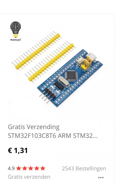

Posts: 1320
PostPosted: Thu Dec 20, 2018 5:51 am    Post subject: Reply with quote  Mark this post and the followings unread
Seen it on Alieexpress, is it compatible with the Arduino ide or just the pinout?
Delivery free of charge.
Any schematics at hand?

PostPosted: Thu Dec 20, 2018 6:35 am    Post subject: Re: Arduinos cortex M3 at 2USD Reply with quote  Mark this post and the followings unread
MapacheRaper wrote:
I have found this:
https://www.ebay.es/itm/1PCS-Arduino-IDE-kompatibles-Board-STM32-STM32f103C8T6-ST-ARM-32-bit-Cortex-M3/162707467072
Basicly is a arduino with cortex M3 at 2USD. So it´s like a teensy but costing peanuts. I wonder how it is possible and if someone has experience with this boards.
One of the drawbacks is that the XTal is 8Mhz... with does even less sense as the chip can run at 74Mhz.
Im about to order one and 74Mhz Xtals and try to run it at his top speed. Not sure if the voltage regulator is going to blown. Even if I have to change the regulator it seems like a bargain.
So if someone has insights or tips about it Im all ears
I have wasted some time with such board. In general it has very good relation power/price but very bad relation regarding required programming time.
In general: has free development environment (System Workbench for STM32), doesn't work directly with Arduino (some guys done it but it's not so easy). It is hard to programming, to proper configure all required options. And it is easy to permanently lost connection with chip after programming with ST-Link (due to some bugs) happened to me several times - some kind of reset is needed then.
Cannot even start simple timer from the generic examples with it (maybe I am not a good programmer). So I threw it away and changed to Teensy.
But you can try. If you master it, it may be cheap and powerful horse in the Arduino-like world. And yes, it can run with a full speed.
