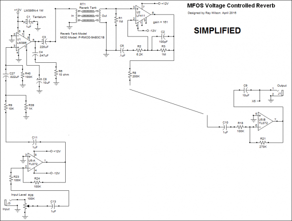

I was thinking of using a trimmed down version of Ray's circuit as a simple spring reverb driver and recovery amp. (I don't need voltage control and I already have the right tank for it.) Would the values given in the schematic work at line level (e.g. mixer aux send?)
Here is the simplified schematic, any problems with this for line level use?
