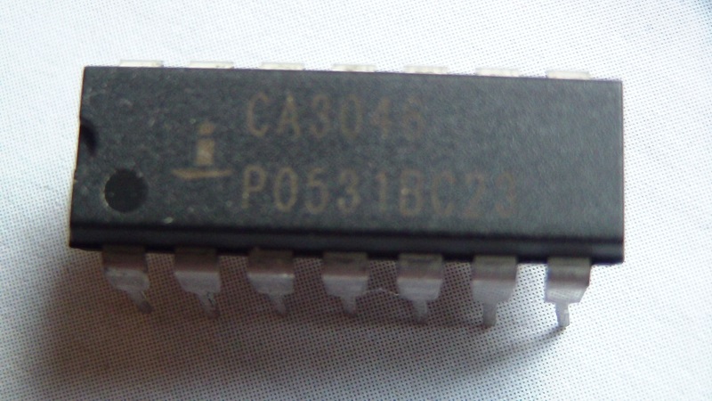

Well, I removed the BC547C and replaced them with IC sockets:
I have already tried MAT02 (which is allegedly ULTRA low noise), LS318, BC550C and I thought there was no difference... No noise attenuation. I pluged a cable into the CV IN and AUDIO IN and connected to my output module and they are silent. Only noisy jack is OUT, even with cutoff closed, so I believe it's picking it up from somewhere in the circuit.
Elec cap before output is audio grade, and instead of TL072 I'm using OP275, I tried TL072 and there's no difference...
Any clues to resolve this?
PS:
My CA3046 is Intersil, whether it's original or not, I don't know, the markings have a golden color.
I ordered different brands of CA3046, the Harris and RCA, I hope there will be a difference because it's my last shot.

I've added extra caps between rails and ground, seems to have attenuated the hum, not much, but definetely helped a bit.
