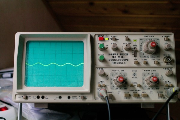

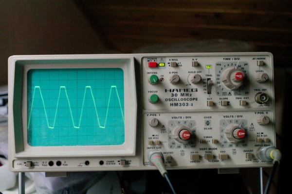

PostPosted: Sat Sep 19, 2020 12:32 pm    Post subject: Reply with quote  Mark this post and the followings unread

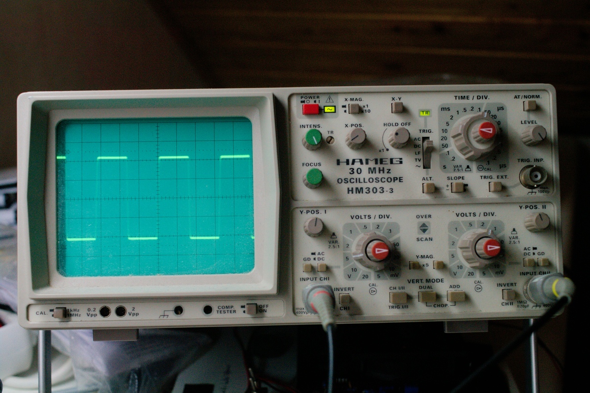

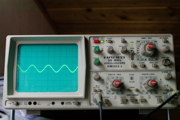

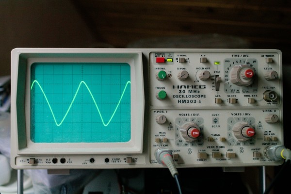

romaindegode wrote:
It would be nice if you could put some pictures of both side pcb
OK, here we go -
it seems I can't add more than 5 pics to one post, so I'll have to do it in two posts.
Oscilloscope pics are all taken with self oscillating filter. The first and last ones are from the output jack. Frequency at this point ranges from approximately 2.2 - 3.5 kHz, depending on the cutoff pot setting. The first TL074 I had put in returned a kind of trapezoid wave, whereas the second one is more or less a square wave.
The three in the middle taken on pin 5 of the IC. At lower cutoff settings the wave is a bit triangle-ish. It goes down in amplitude and turns into a sine wave at higher settings of the cutoff pot.
Edit: The preview showed the pics in different order - best look at them in inverted order Rolling Eyes .
filter output after having swapped the TL047

pin 5 of the TL074 at higher cutoff setting
 Filesize:  388.23 KB
 Viewed:  365 Time(s)
pin 5 of the TL074 at low cutoff setting
 Filesize:  388.99 KB
 Viewed:  389 Time(s)
filter output
 Filesize:  386.38 KB
 Viewed:  395 Time(s)

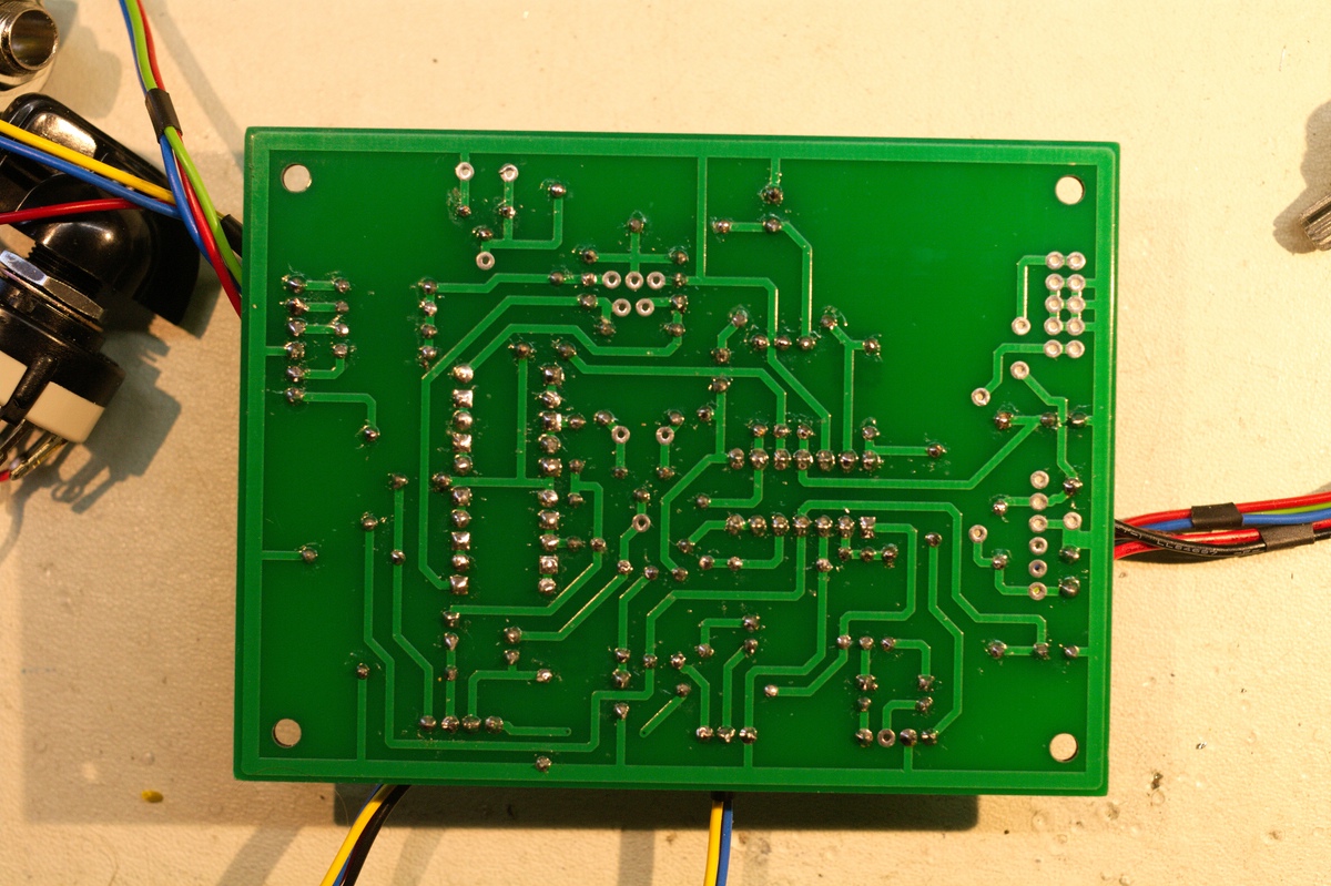

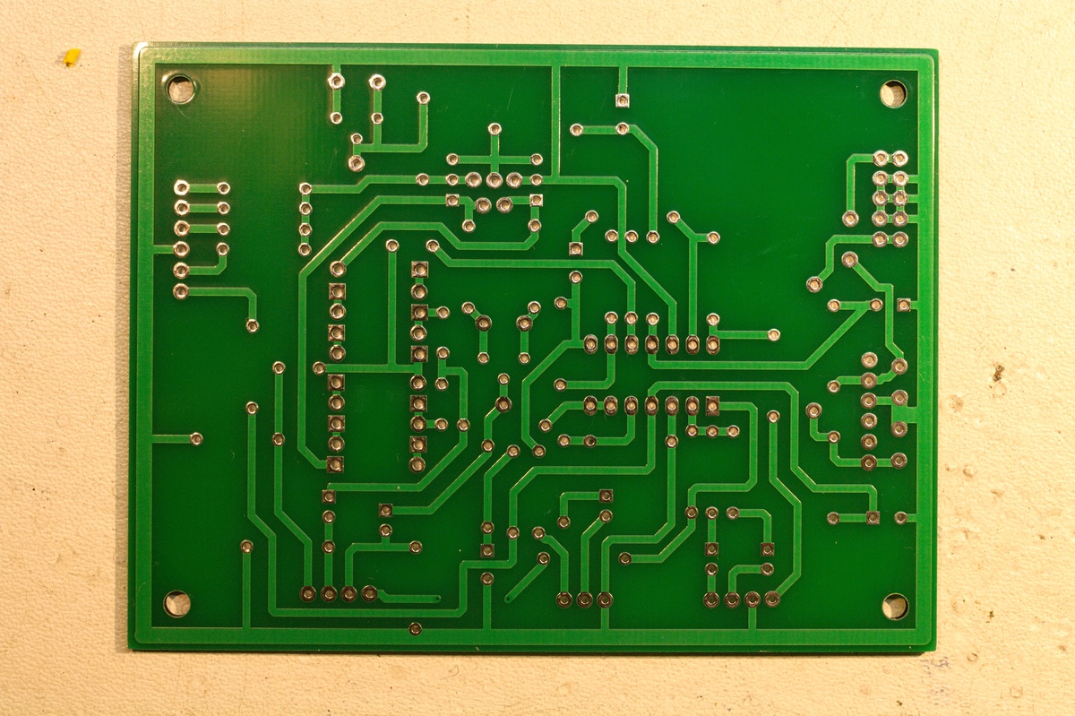

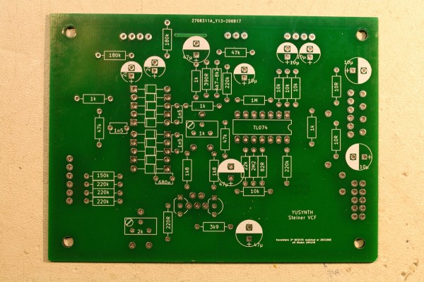

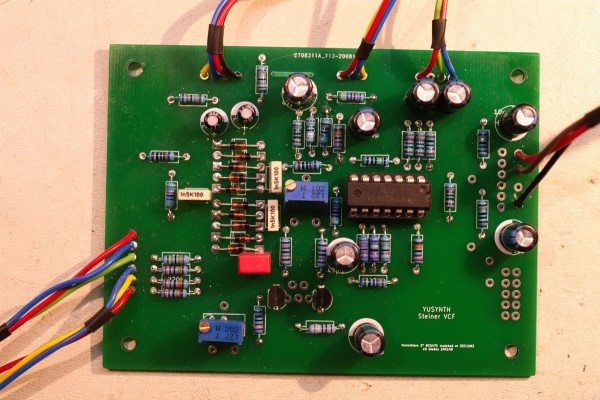

PostPosted: Sat Sep 19, 2020 12:39 pm    Post subject: Reply with quote  Mark this post and the followings unread
OK, and here's the PCB pics
front side - pleace note I repalce the jumper near the upper egde (close to the manufacturer's code) with a cooper track
 Filesize:  397.96 KB
 Viewed:  407 Time(s)
back side
 Filesize:  376.27 KB
 Viewed:  400 Time(s)
front side, populated
 Filesize:  395.95 KB
 Viewed:  384 Time(s)
back side, populated. I resoldered everything again today, and made sure there are no solder blobs. Didn't change anything though.
 Filesize:  379.93 KB
 Viewed:  394 Time(s)
