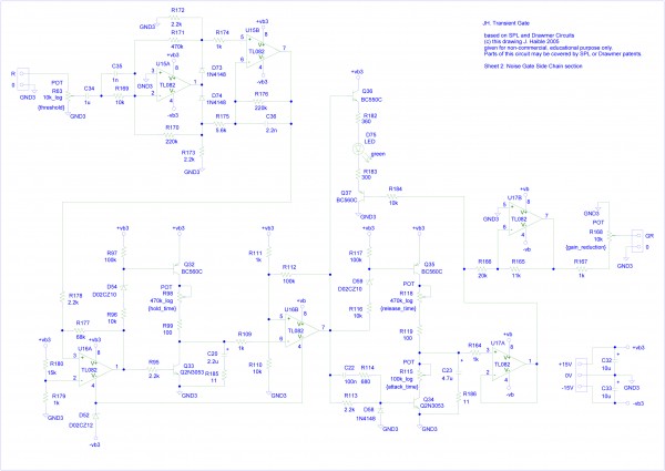

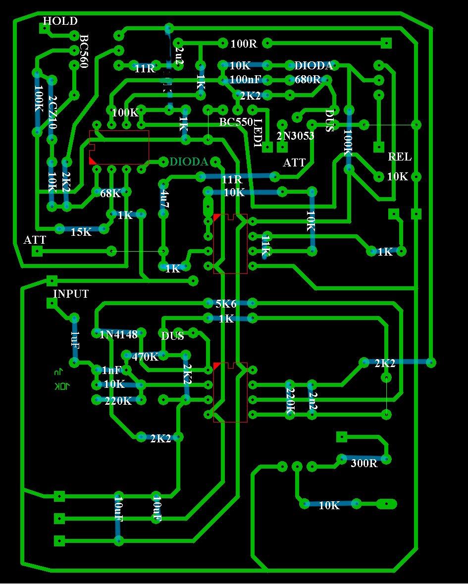

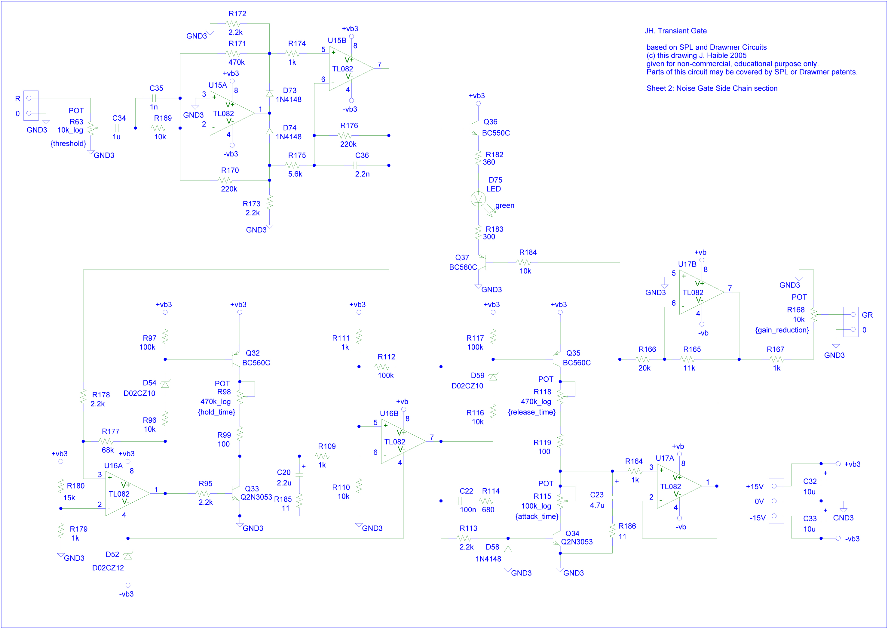

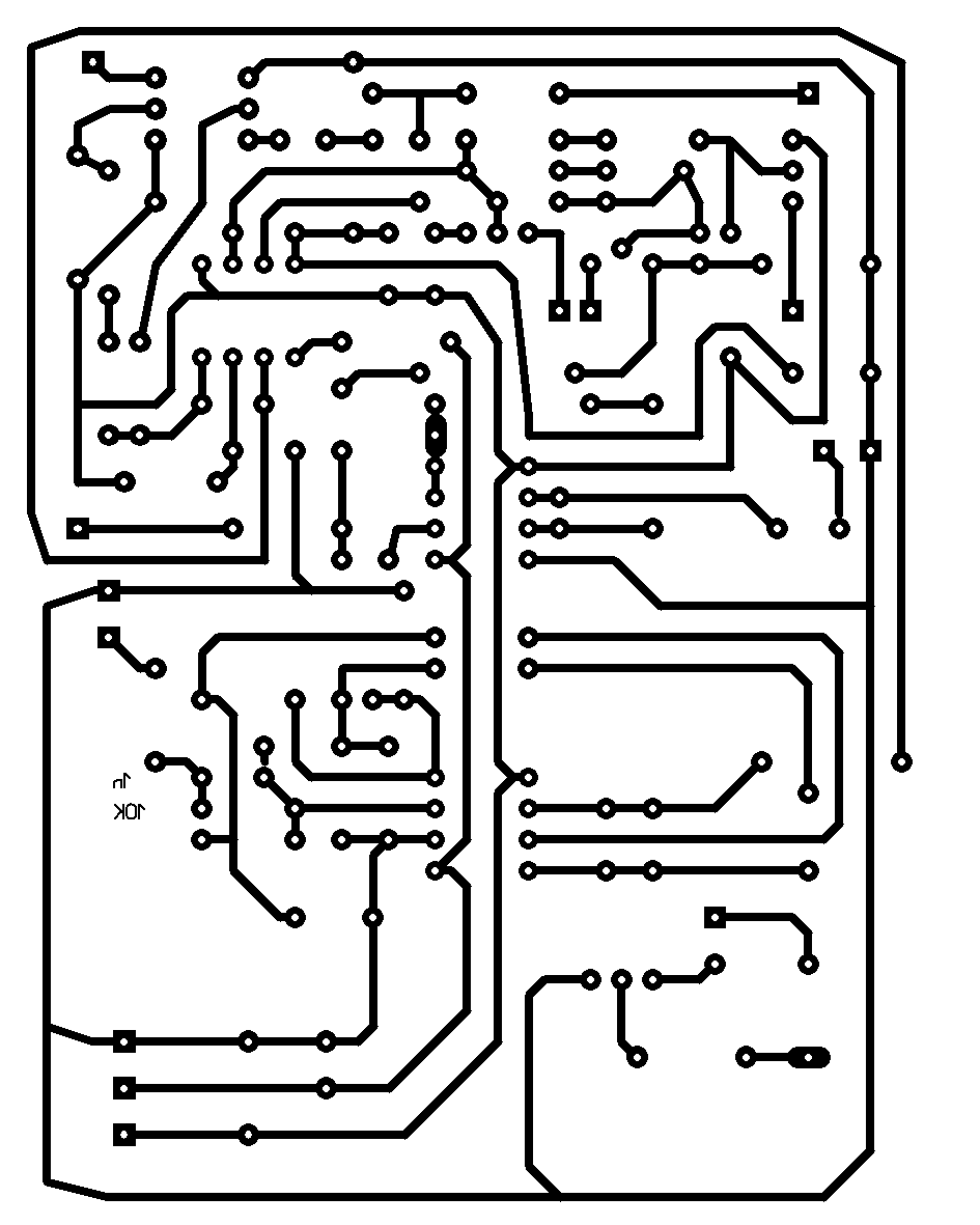

this is the sidechain noise gate from the transient gate project by JH , have not built it yet so i dunno how it will behave ,the pnp print is 300dpi
