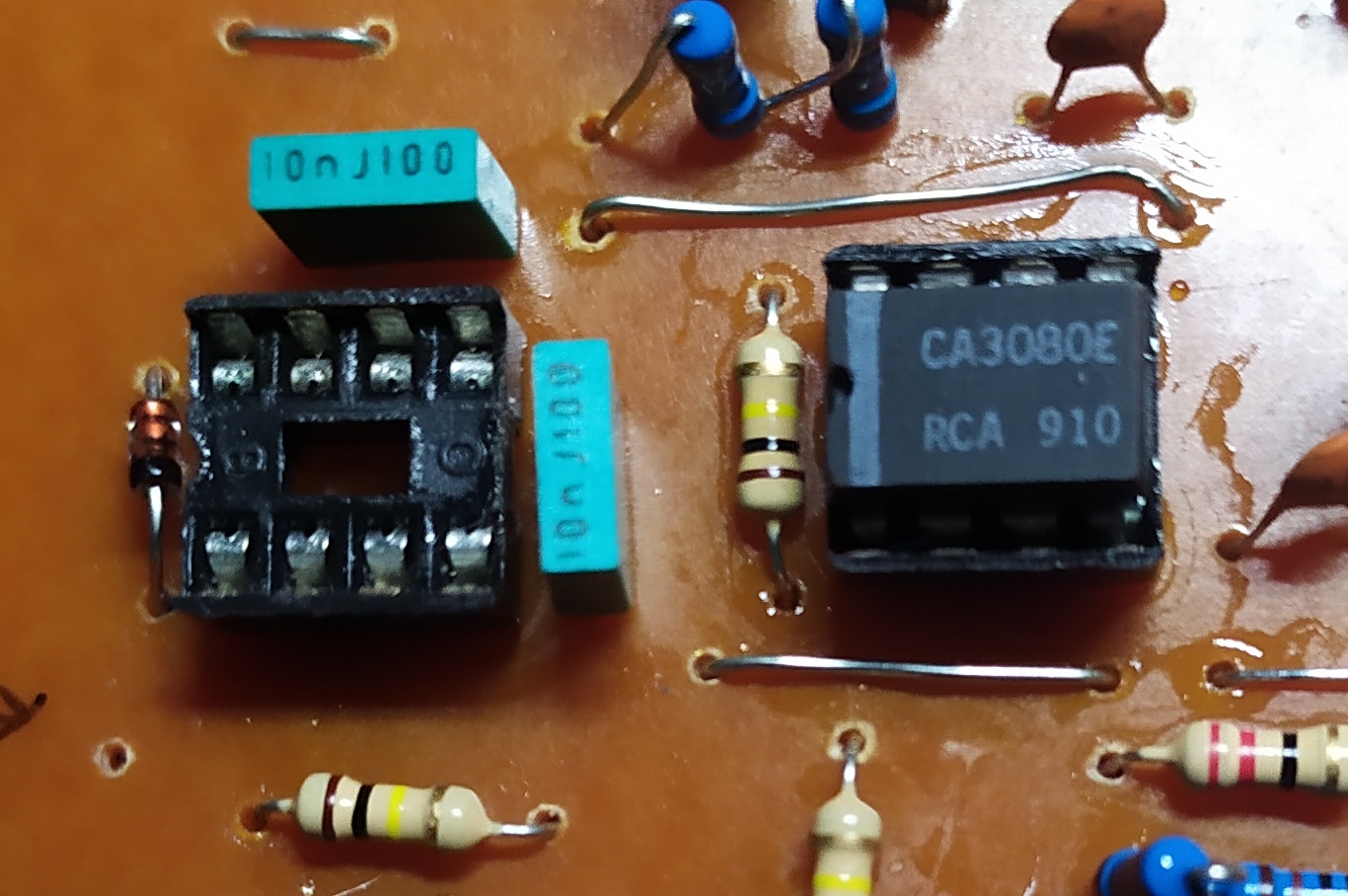

Hi all,
As many of you, I stepped into the fantastic world of modular synthesizers and the first module I built was the TH's VCO-1. It works perfectly and I already built the second one.
Next, I needed a VCA, and again TH's VCA-1 (https://www.birthofasynth.com/Thomas_Henry/Pages/VCA-1.html) worked, but in a strange way: The gate opens at negative voltages and closes on positive. When I press a key, gate is closed and no sound. On a depress, gate opens up. This is supposed to be the opposite way, isn't it?
I checked my circuit and it is exaclty the same with that TH designed.
What may have gone wrong?
Any ideas?
Thanks already.

I figured out that:
1- TL071 is getting very hot and frying some time later. Even if I remove the TL071 from its socket, circuit keeps working in its abnormal behaviour. 071 has no function in my circuit.
2- Checked everything. No shorts or anything wrong.
Couldn't understand why TL071 is getting that hot and not working.

The ota you are using, 3080 or 13700?
I’ve built several vca-1’s with the original layout ages ago, and i had this behaviour with fake 3080’s!
I’d try swapping that after gettting the right psu voltages on ic sockets.
It's a 3080, but note sure if it is fake or not. I will check. The same ones work on my VCO-1s without any problem.
I used 7815 and 7915 regulators on my 15v symmetrical PSU. I measure +15 and -15 on the transformer output, but -14,8 and +15,2 on the DC side. This is also interesting. I tried two circuits, and they did the same. This is the only problem with my PSU. I'll also change it.
Finally, I think I will put this VCA-1 aside for some while and find a different simple VCA circuit to build. And also a simple VCF and an ADSR.
