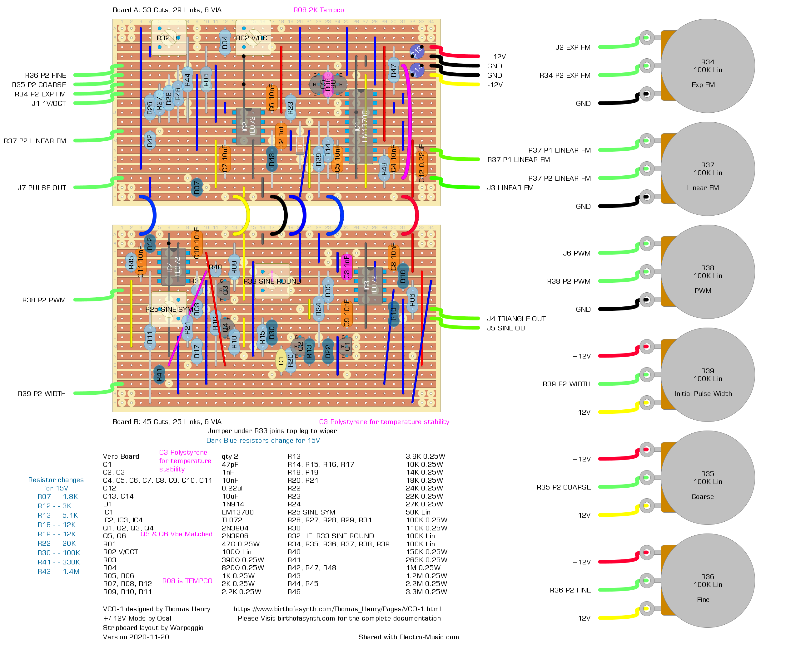

Hello fellow nerds!
I'm Warpeggio, first time posting here. I've set out to build a synthesizer, and having completed a build of Ray Wilson's Wall Wart Power Supply, I was ready to try my hand at a VCO.
I come from the 9v world of guitar effects pedals, so i was thrilled that Thomas' design called for such simple parts that I already had in my war chest. I was a little concerned about the CA3080, but i had LM13700 at hand, and others have written positively about it as a sub / replacement. Another design goal was working off +/-12V, so my part values reflect that. I have to thank Osal for his wonderful post here on those 12v modifications.
I've come to share my stripboard layout for VCO-1. I've built it up to the point that i'm comfortable calling it "verified", although i have not the rack to test the FM or PWM functions yet. The triangle, sine, and pulse outputs are working as described.
Problems that i am currently working through:
1) With stable or no CV input, there is significant oscillator frequency instability over the course of seconds. My Rigol DS1054 won't give a clean frequency count. I *believe* this is because i have a poor power supply transformer but haven't tracked it down yet.
2)I can't test the 1v/Oct trimmer functionality because i didn't have any 100Ohm trimmers. Small-bear will be shipping some to me shortly, so until then I can't comment on how this particular build tracks.
3) I've "parked" the unused half of the LM13700, but I'd like to use it somehow. I'm currently investigating a very simple VCA, since those are always welcome.
Thanks for all the information y'all have shared on this site. Your feedback is appreciated.
Changelog:
V 2020-10-15:
* R47 was not correctly tied to the positive rail, instead misplaced on a bus with the R02 wiper. Fixed.
* C7 tied to lower ground rail to better fit capacitor pin spacing. Allows tidier jumper nearby.
* Color coded resistors involved in choosing +/-12V or +/-15V, provided table for 15V values
* Credited Osal directly in image
V 2020-11-20:
* Updated values for C13 & C14 to be displayed in the BOM
* Some minor opacity adjustments for clarity
* Fixed the extra copper strip that was displayed at the bottom of each board

Hello again! An update on the issues i was working through:
1) Instability: The scope revealed that my CV input signal wasn't as stable as i thought, and this was compounded by my poor power supply transformer responding to varying loads elsewhere in the house. Overall, the oscillator is as stable as designed.
2) Tracking over 3 octaves is excellent, although tuning can be tricky. I went back and forth between the scope and a clip-on instrument tuner. My build DOES go flat on the fourth octave - i believe it's because i used 2x 2N3906 that i didn't even try to match for current or Vbe. I assume this would be improved with a matched pair or dual IC. Personally, 3 octaves is pretty dang musical for a first VCO so i'm not sure i care to make any changes.
3) I've drawn up a version that implements a simple VCA on IC1B, but i haven't built it yet. It's based on a design that Kristian Blåsol shared on his Youtube. This would be a "no-frills" design, to say the least.

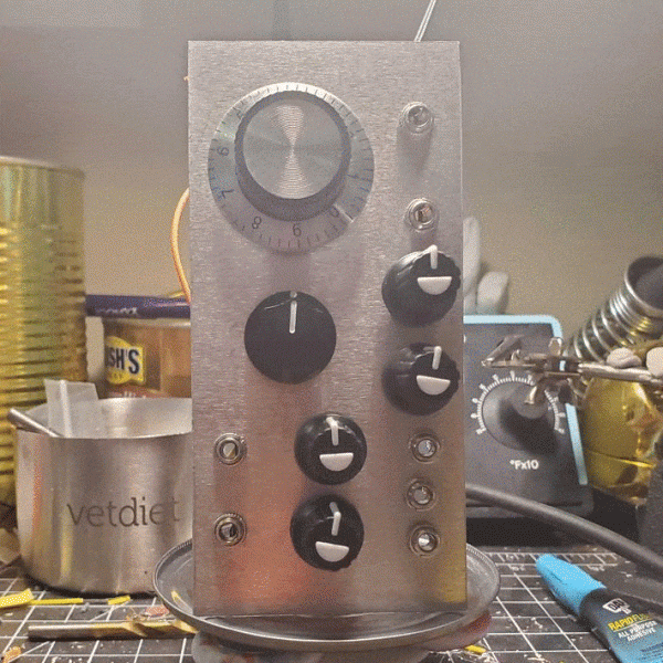

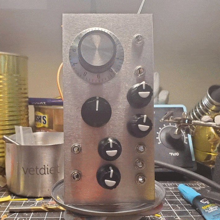

I did a complete second build of this module. I matched transistors using Ian Fritz's method, a 2k tempco bonded to the top (LT732K0JTG from Small-Bear), and a polystyrene cap for C3. I let it warm up for 20 minutes, and then with my skill and a clip-on tuner, i was able to get 4 solid octaves out of it. I am not confident that i did the procedure exactly correct, and i have doubts about my 1v/Oct controller, but i think there still may be some room for improvement on the stripboard layout.
That said, I think that the target audience should be comfortable with these tradeoffs, if not challenged to one-up my results. A VERY playable VCO built with (mostly) common components and without etching or waiting for a custom PCB. If you choose to build this with NO care on matching transistors, tempco, or polystyrene, i just recommend that you let the module get GOOOD and warm before attempting to use / tune it. Unmatched, the pitch will jump cents and whole tones as the temperature equalizes between the two transistors, but once it's warmed up, it's accurate enough!
I hooked this module up to a MIDI controller and was very pleased with musicality of the result.
Open the image to see it rotate and show the backside(s)

PostPosted: Thu Dec 31, 2020 8:00 am    Post subject: Reply with quote  Mark this post and the followings unread
Thanks for sharing this!
My I ask you regarding two things:
All pots are in back view? lugs are from top to button is 3 2 1 ?
Can I omit the c12 (0.22uf) if I would like to make that input dc coupled? (same as the exp fm input?)
warpeggio
Joined: Oct 14, 2020
Posts: 9
Location: St. Louis, Missouri, USA
PostPosted: Fri Jan 01, 2021 11:51 am    Post subject: Reply with quote  Mark this post and the followings unread
1. Yep, that's a back view of the pot. Let me know if you find any errors regarding clockwise / counterclockwise functioning.
2. I don't know for sure. Looking at "Richard Brewster's version of CGS/ASM VCO" in another thread, there's a switch that allows this, so MAYBE? I can't really speak to it, other than to say give it a try and see what happens!
